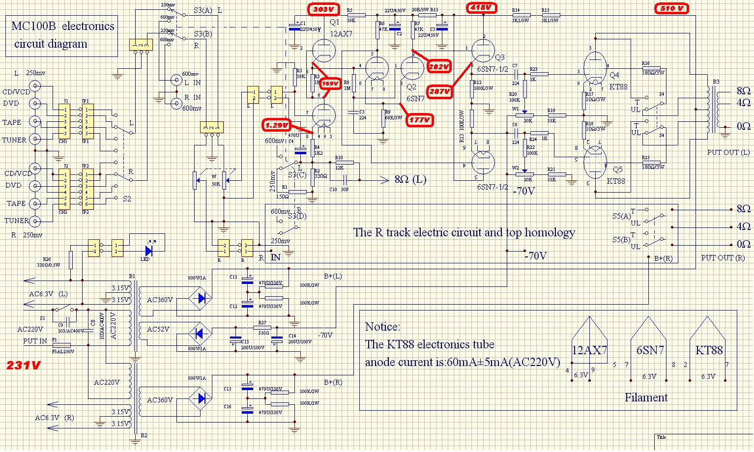

Considering the design of the ampli:
the 6sn7 driver of right channel (v1) is for the left channel v3 or v4??
In other words the design of ampli for right and left channels are simmetric or specular???
Considering the 12ax7 it seems specular, and also from few posts I read..
But I must be sure

Feedback loop is only when SP are connected to 8ohms SP tap right?
1,2k+330R=1,5K you fitted right?

To avp1
no for matching the tubes..
But I must be sure
Viewing from the front, the left hand 12AX7 feeds V2 6SN7 which is the Left Channel phase splitter. This feeds V1 6SN7 which in turn drives the KT88's V1 and V2.
The right hand 12AX7 feeds V3 6SN7 which is the Right Channel phase splitter. This feeds V4 6SN7 which in turn drives the KT88's V3 and V4.
Hope this clarifies the tube signal paths.

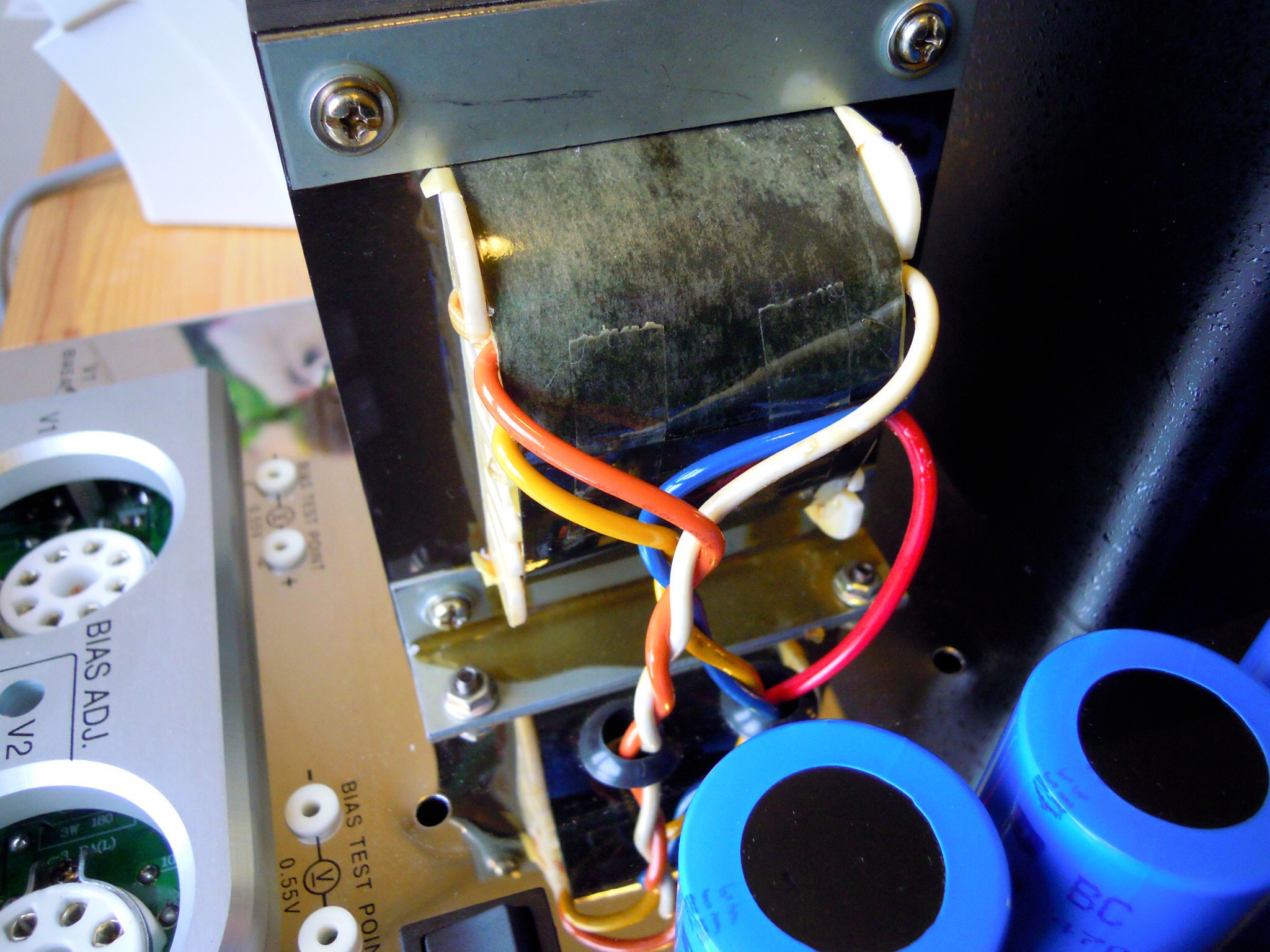

Have anyone here tried to bypass/remove the UL/Triode buttons?
I want to connect my KT88 direct without any switches because i never listens to UL anyway. Triode sounds better in my ears!
I'm little unsure though how to do it. In triode-mode signal passes through the longest winding right and UL on two middle"taps"?
I ask before i do anything stupid 😉
Ok that i understood but there is alot of wiring going back and forth and totally 4 wires per side (2xkt88) going down to OPT and also double wiring from switch to socket. Makes my confused. That's why i thought better to ask if triode uses the winding on output trafo?!
