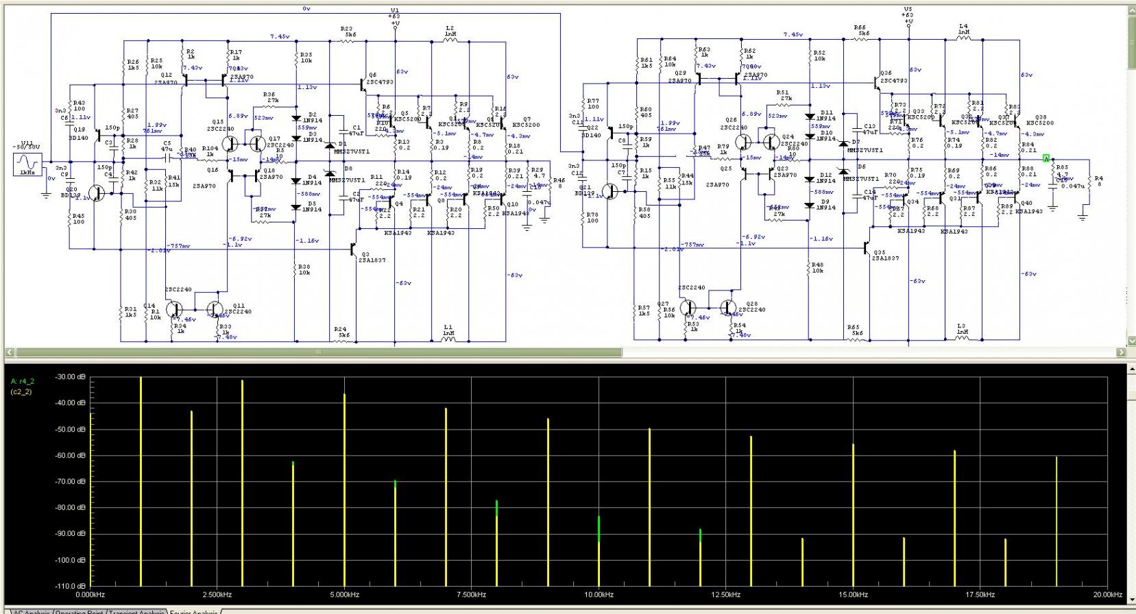

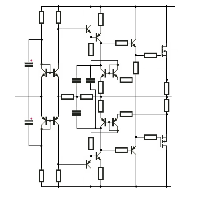

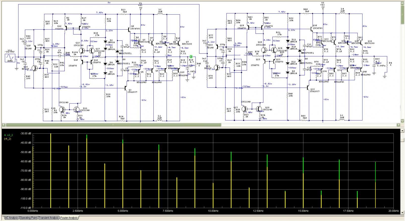

Another play on my simulator proved the following scenario. The difference between the two schemes is the lack of a capacitor C5 in the second scheme in which the second scheme of non-switching/Yamaha's Hyperbolic Conversion Amplification / switches to class B. Initial current of both schemes is identical.
It is clear that options class B / pic 2 /, the values of the odd harmonics are lower.
In / pic 1 / shows what is gained from Non-switching options. Almost nothing.
My question is why yamaha have pushed and complicated scheme, further complicated innards, it is worse / according to the simulator /, is it just a marketing strategy / although it is nowhere specified that the amplifier is Non-switching / the whole thing or just the simulator is not allowed to show the real things that really happen?
Whether these "crossover distortion", which is avoided by Non-switching options are included in the harmonic spectrum?
-30dB nonlinearities can't be, not even in simulation ...

Hi Jon Lord, It's -30dB, but the 1khz level is +35db. The distortions are -70dB second harmonic. The HCA works by simulator, but the result is worse that class B on 50mA current. Why?
When I set current on 200mA the HCA is the best, but this is a lot of heat.

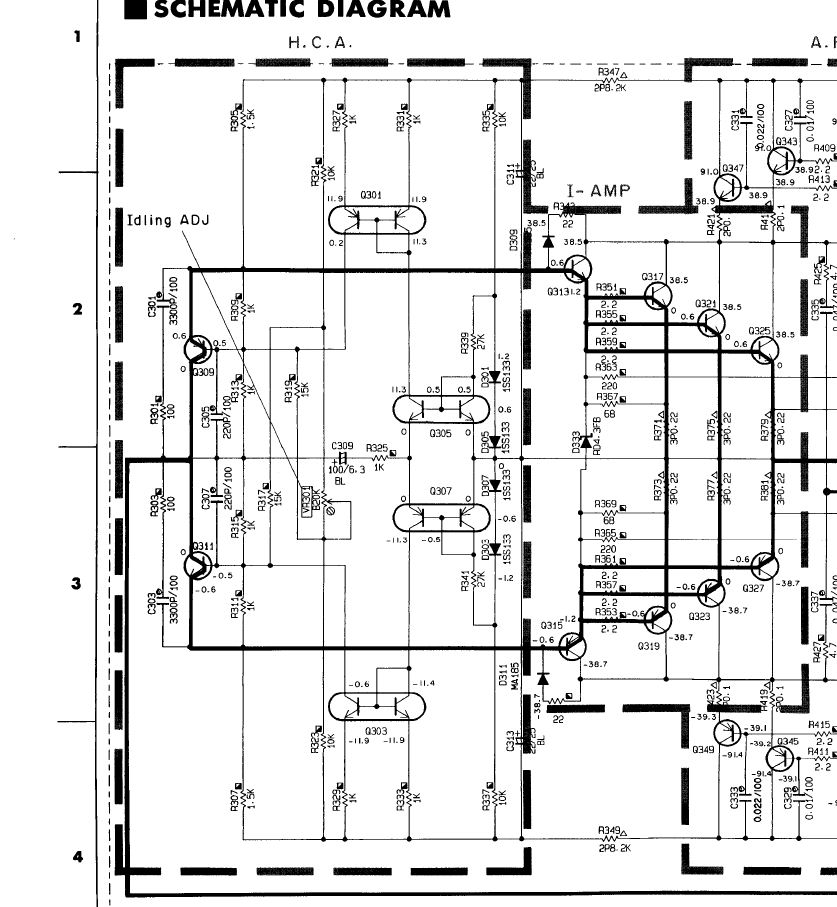

After you tell me about MX-10000, I found the service manual and saw the circuit. Yes, this yamaha is very good build and very powerful. This is the true amplifier. I saw the HCA circuit of MX-10000 and I tested on my simulator, but It doesn't work!!!
Where did you find MX-10000 service manual ?After you tell me about MX-10000, I found the service manual and saw the circuit.
The original MX-10000 HCA circuit look like this.Yes, this yamaha is very good build and very powerful. This is the true amplifier. I saw the HCA circuit of MX-10000 and I tested on my simulator, but It doesn't work!!!
And don't forget that MX-10000 use a real feed forward error correction.

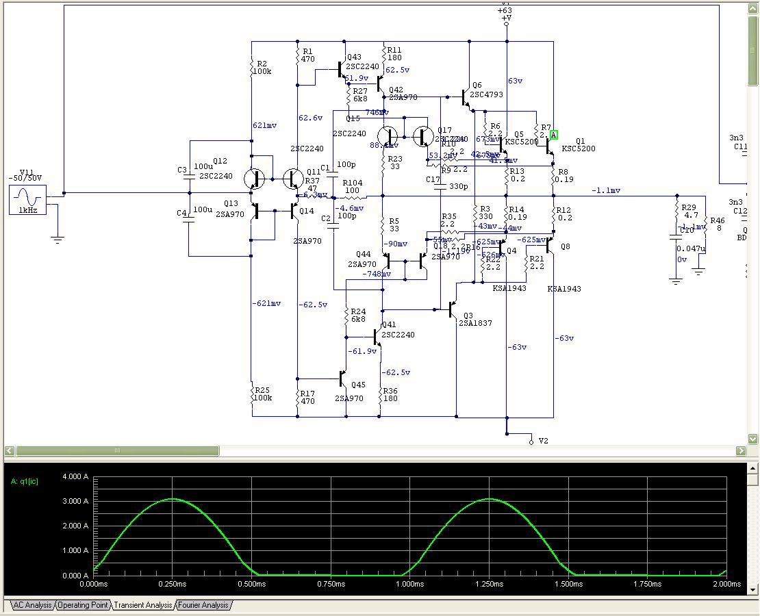

This is pure class AB with switching. What are you think about the circuit? Is it right?
I don't have good spice model of power mosfet transistors but I think is not critical for simulation.
This is the HCA including component values...

This is my test circuit in my upstairs post, if you can't set current to 200mA is worse from pure class AB circuit with 70mA current.
