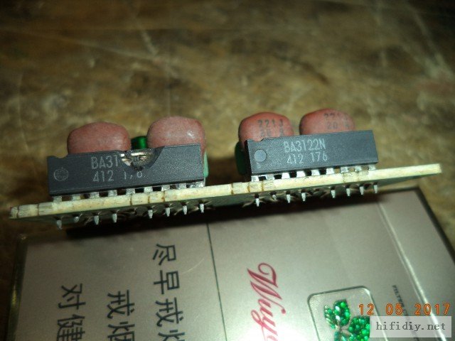

I have found the attached image.
This confirms the claim of an experienced repairman I know and has worked for an authorized Yamaha service department for a long time.
He is convinced that this IC is equipped without any protection for certain unfavorable operating conditions like shorting, overshoot etc.
Consequently, it is nonsense to perform the genuine condition in a repair by finding a NOS part of this type from ROHM.
The only reasonable alternative is a discrete clone including appropriate additions for protection circuits.

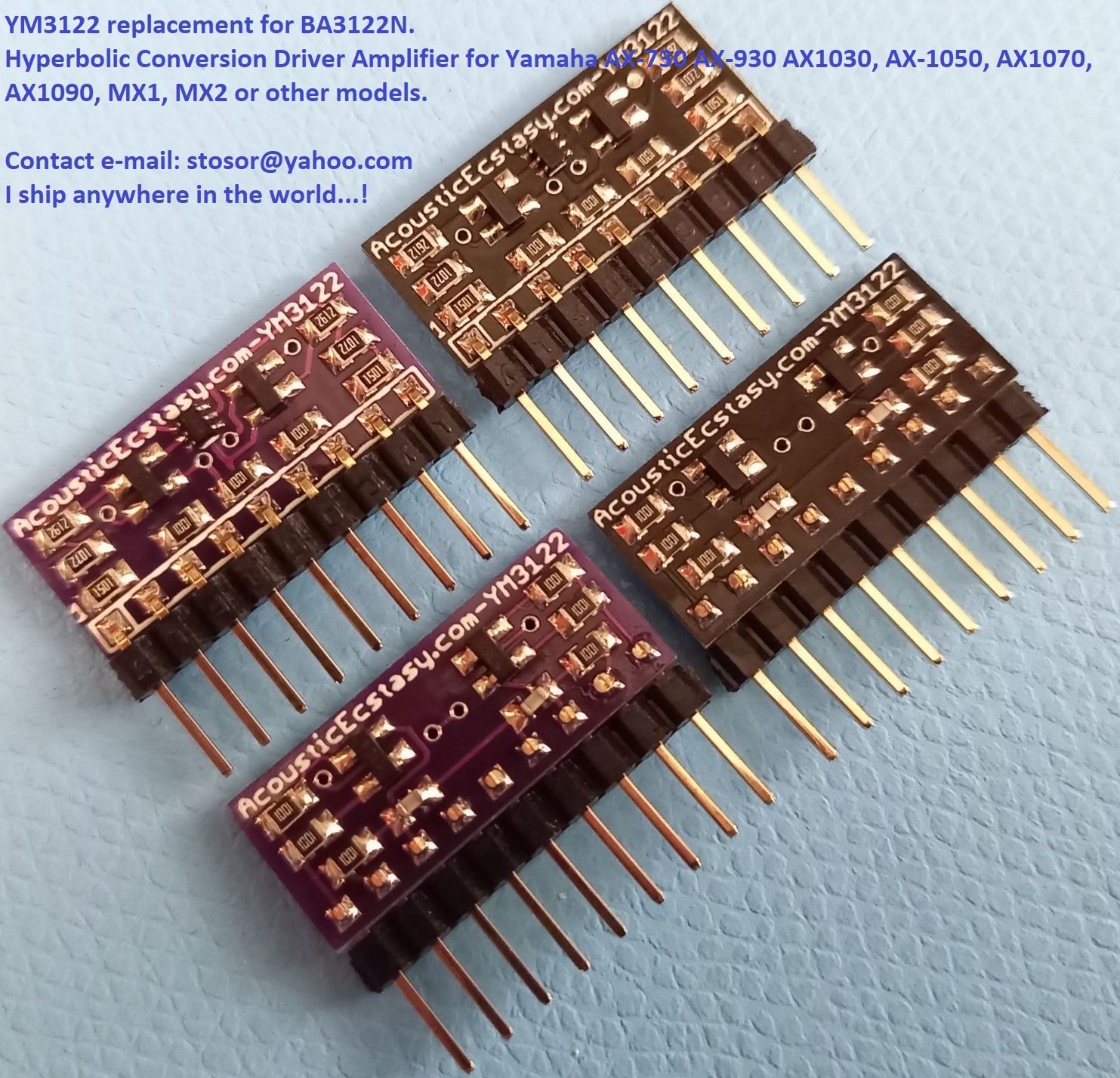

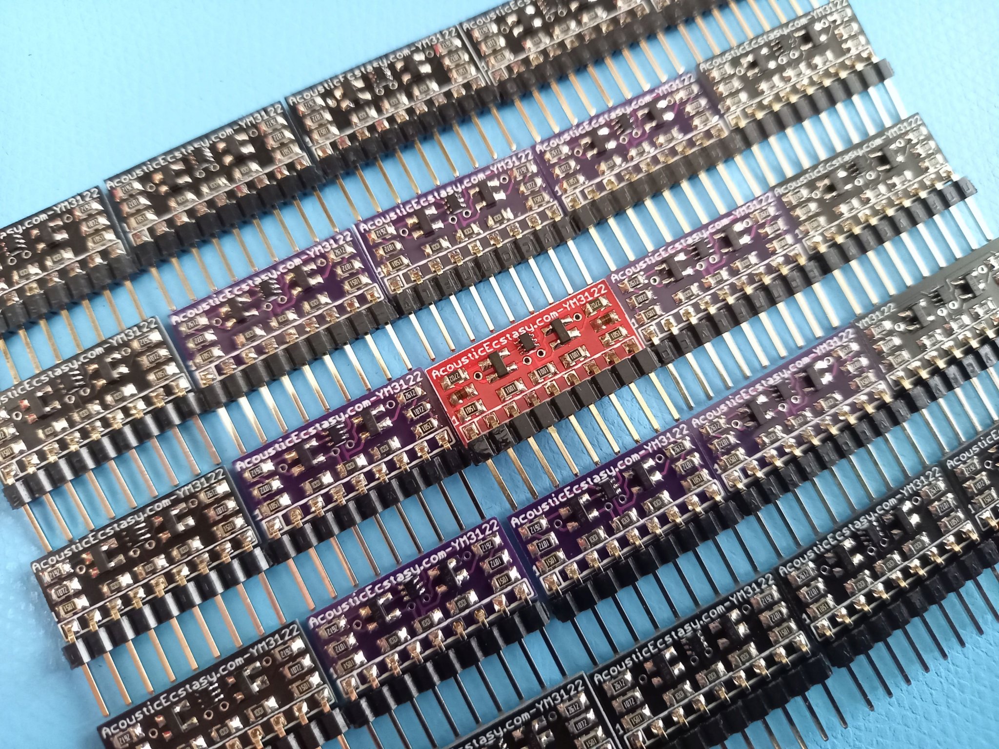

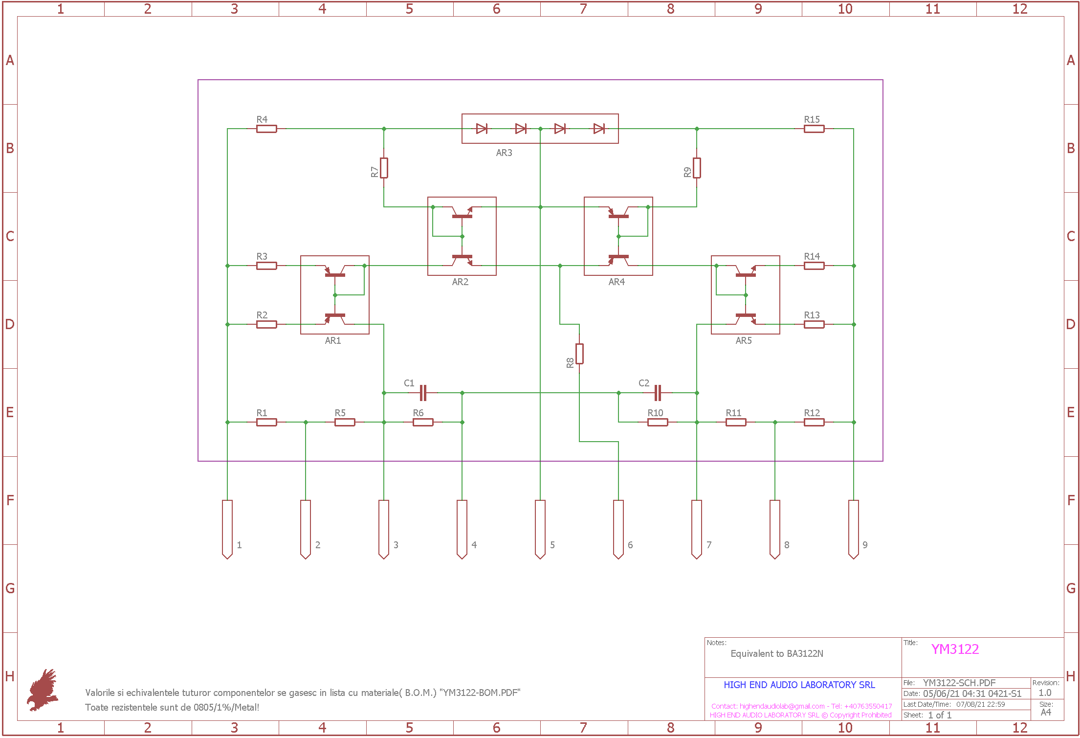

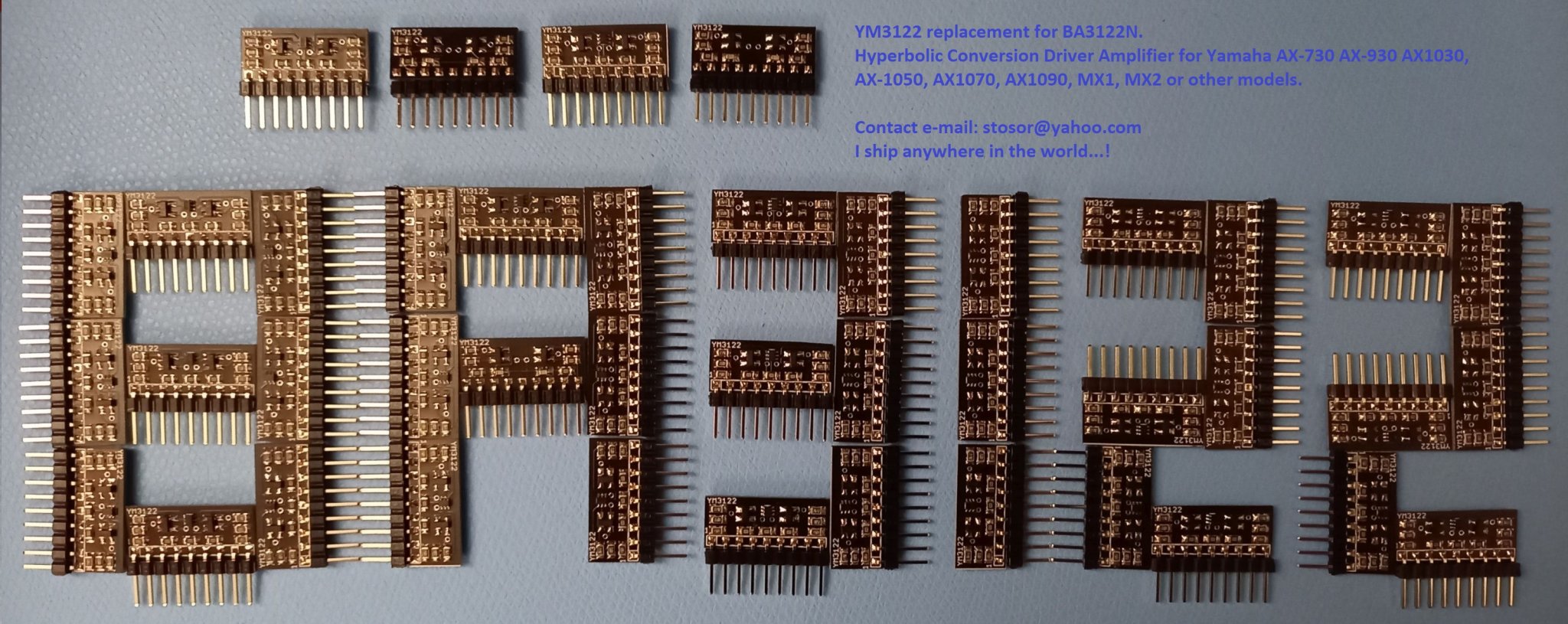

Because this integrated circuit has not been manufactured for a long time and is increasingly in demand, we designed and made a perfectly functional equivalent! Without making any changes to the amplifier!
The active components are specialized (bcv61 / 62 Nexperia) for this purpose and the passive components are of very high quality, 1% metal 0805 SMD.
The PCB has 23x10mm, double layer with metallic holes.
You can contact me privately for more details!

YM3122 replacement for BA3122N.
Hyperbolic Conversion Driver Amplifier for Yamaha AX-730 AX-930 AX1030, AX-1050, AX1070, AX1090, MX1, MX2 or other models.
Contact e-mail: stosor@yahoo.com
whatsapp: +40763550417
I ship anywhere in the world...!

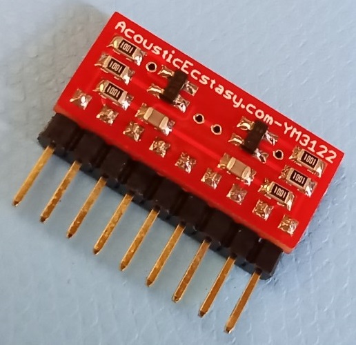

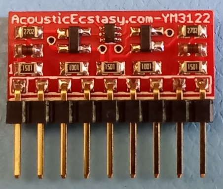

Can you please tell me the which part use in the middle of circuit 6 legs pins ??
This equivalent is very simplified and doesn't correspond to the completely equivalent structure of the original ROHM BA3122N microcircuit. The original has much more transistor structures and a different correction.
How do you know that? Please give an example with valid information! I used the exact circuit with discrete components used by YAMAHA which is identical to the internal diagram of the circuit manufactured by ROHM... Do you have an internal diagram of the circuit so that you can validate what you say? I have dozens of clients who have used the original circuit together with the equivalent manufactured by me and NOT ONE OF THEM HAS NOTICED ANY DIFFERENCE!
I know this may be a long shot. I have a Yamaha MX-1 in the shop with a shorted BA3122N in one channel. I am thankful for the schematic for the new YM3122 modules. I have the transistors as BCV61/62 and the diode module as BAV99S. I can see the resistor values in the pictures but cannot see the connections for the corresponding resistor numbers in the schematic. Does anyone know the resistor values to their corresponding numbers R1-R15? Also does anyone know the values for the film caps C1 & C2? I've tried contacting the company of the YM3122 modules on Facebook, via e-mail and direct messaging on here, but still awaiting a response. Any and all help will be appreciated. Thanks in advance. The customer would like to have an amp for audio and not a boat anchor. 😆
