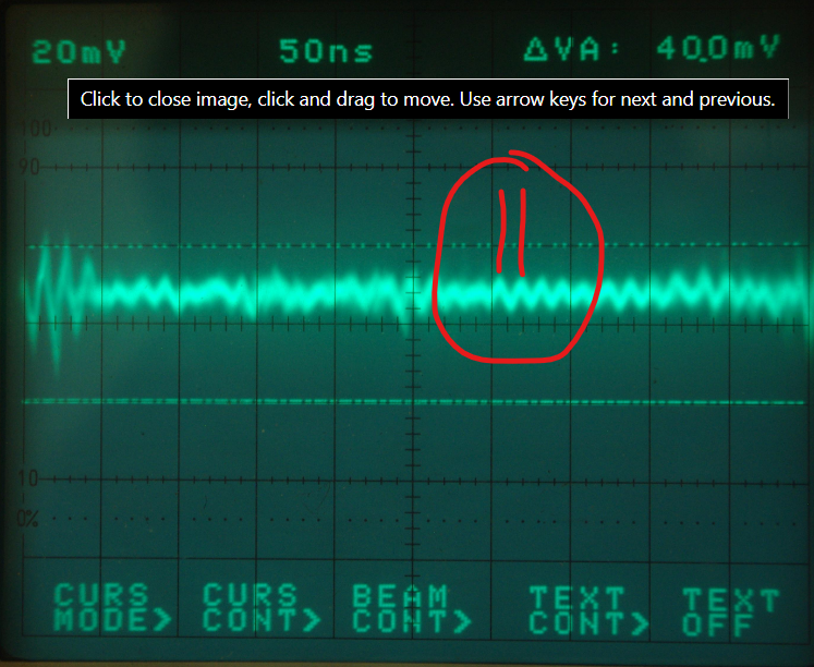

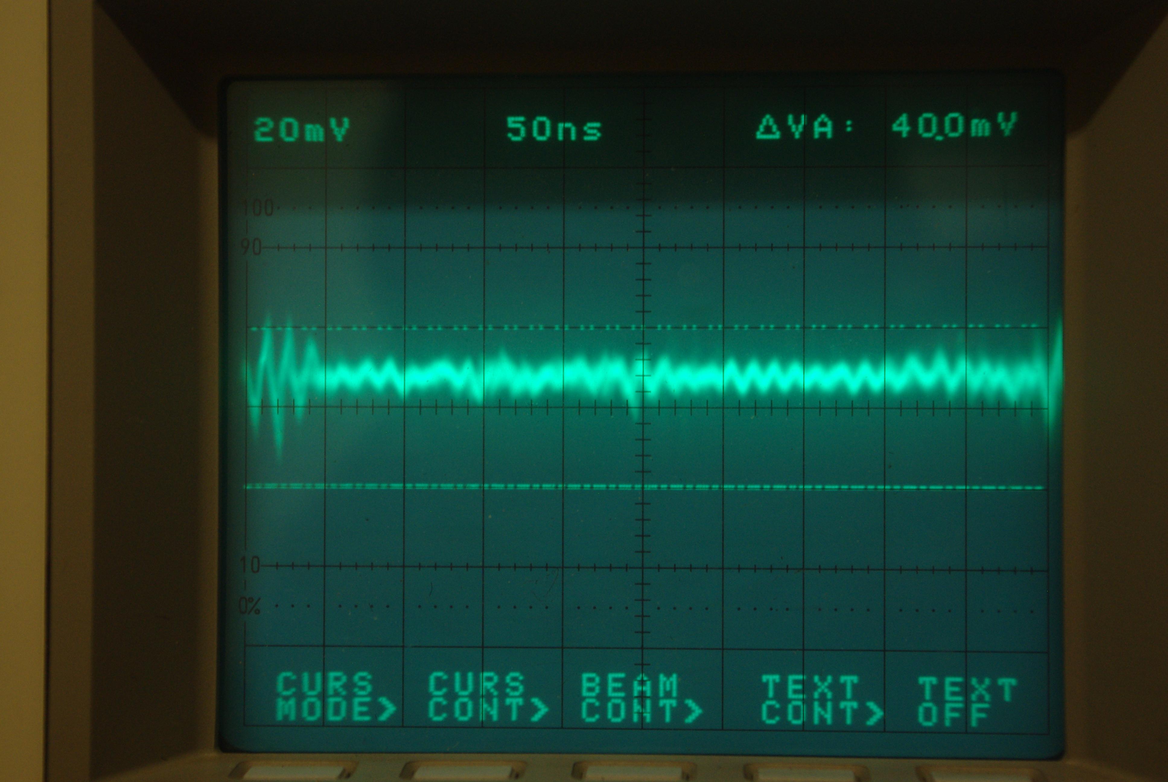

Chris, all I'm seeing at the osc pin on the tuner can is the sawtooth trace which is in the mV range on both am and fm. Glenn
That doesn't right at all.
Using the scope, what is the approx frequency of this sawtooth (calculate using 1/T where T is the time period between any two similar parts of the signal).
Also what is the approx amplitude. Take the X10 probe into account. For example if the signal is 3 divisions from top to bottom (peak to peak) and the scope is set to 1mv/div then the amplitude is actually 30 millivolts peak to peak.
We need to know this just to get an idea of what you are seeing. For example it could be 100/120Hz ripple or it could be a microscopic superimposing of clock and data signals (which would be of no consequence).

Brilliant, you can't beat a picture 🙂
That looks a little like random pickup to me, a possible artefact of the measurement setup.
Out of curiosity, if you connect the probe tip to the probe ground lead (while its connected to the tuner during the measurement) you may well still see the same noise. Might be worth just trying that. Also do you see that same kind of noise on any other pin of the tuner can.
What I can say is that the same signal is there when I turn the tuner off so must be random pickup.

The local oscillator for the 88 to 108MHz band would run at those frequencies PLUS the IF (intermediate frequency) and so would be in the 98.7 to 118.7 MHz range.
FM tuners always use 10.7MHz IF frequencies and the IF filters are those three legged ceramic do-dahs that will be on the board somewhere.
The frequency of your signal appears to be around 66 Mhz but it doesn't look a valid signal to me, more like random pickup as I mention. This is how the frequency is calculated (picture).
That said... you have no tuning voltage at the moment and so the oscillator might be running very low in frequency. I would see what happens when you artificially create a tuning voltage as we mentioned earlier by using a resistor. Does that frequency of signal you see then increase.

I nearly asked you to do that 😉 honest. It just had that look about it.
So its pickup and the oscillator doesn't appear to be running 🙁
No easy answers I'm afraid. I would still suggest adding a tuning voltage to put the tuner can into a 'valid' state but I suspect we are looking at an issue within the can... and that gets pretty heavy faultfinding and repair wise as RF circuitry is quite specialised and the parts used become critical.
The best repair option once we are convinced the can is at fault would be to source a new module but I suspect that is easier said than done and perhpas not viable.

In that picture, the period of the signal is taken from two identical points. If the timebase is on 50ns per division then we can guesstimate the period to be around 15ns. That would give a frequency of 1/15E-9 which is approx 66MHz. I missed that bit out of the explanation I think.
