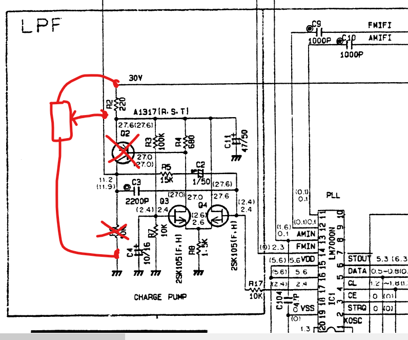

I did actually mention way back in March to try a variable voltage on Vt:
To do it more thoroughly, all you need do is remove these two parts and then add a preset or pot across the 30 volt tuning rail like this.
Another test that can be done is to isolate the tuning line (VT) and connect it instead to the wiper of a pot or preset pot (say 10k or 22k) and connect the pot across the 30 volt line. That would give you a manual tuning voltage from 0 to 30 volts and should allow stations to be tuned.
OK, thanks to you both. I was looking at your earlier post Mooly but what you have just posted today makes things clearer for me. I'll try that but will have to buy a pot from the local electronics store. Chris, freight from US to Australia is horrendous- for something like the power supply it would be in the order of $150US. Also, we are on 240V so the unit would have comply with that requirement. Not always the case in my experience. However, I will continue to look around. As a short-term solution, I can buy a switching type variable supply locally from Radioshack type store for about $120 AUS. Range 0-24V. Or should I steer clear of that one? Glenn
A fixed resistor such as 22k would give you a valid tuning voltage of around 9 volts DC. Just pull Q2 from the circuit and tag the resistor from the collector pad to the 30 volt line.

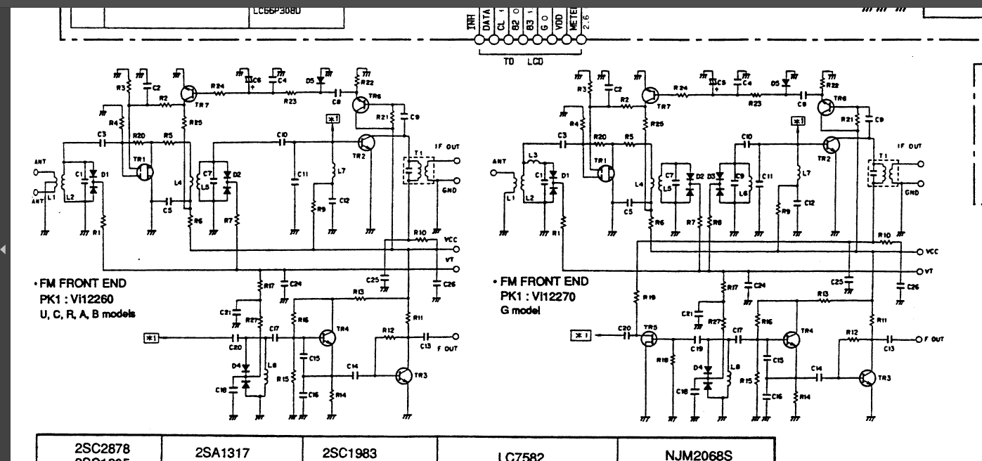

You would then need to scope the OSC line and delve into the tuner can itself. F out is the oscillator output. There are two versions of tuner depending on your region but the oscillator signal is the same for both.
If you go in the can do not physically move any parts or wires as that will alter the alignment. It has been aligned with the parts in that position and to move them would alter the parasitic coupling between them and change the alignment.
The scope with DC coupling can be used to probe around TR3 and see if there is any kind of high frequency signal present. You can also use the scope to check the DC voltages on TR3 and TR4 and see if anything looks amiss. The scope is probably better than a DVM for this when used with its 'times 10' 😉 probe.
Component values aren't marked because these RF units are considered non repairable but we never say never.

Mooly, that schematic looks like the 550. In the 540, the AM antenna also goes into the can so some of the components may be different. I have not seen the schematic for the 540 and could not find one online. Glenn
That makes things much more difficult then. Without a circuit you have to 'busk it' as we used to say. There are still things you can do but it all gets more heavy. You would need to trace the OSC line in the can and identify where the oscillator is and then have a careful measure around the transistors to see if anything obvious showed up.

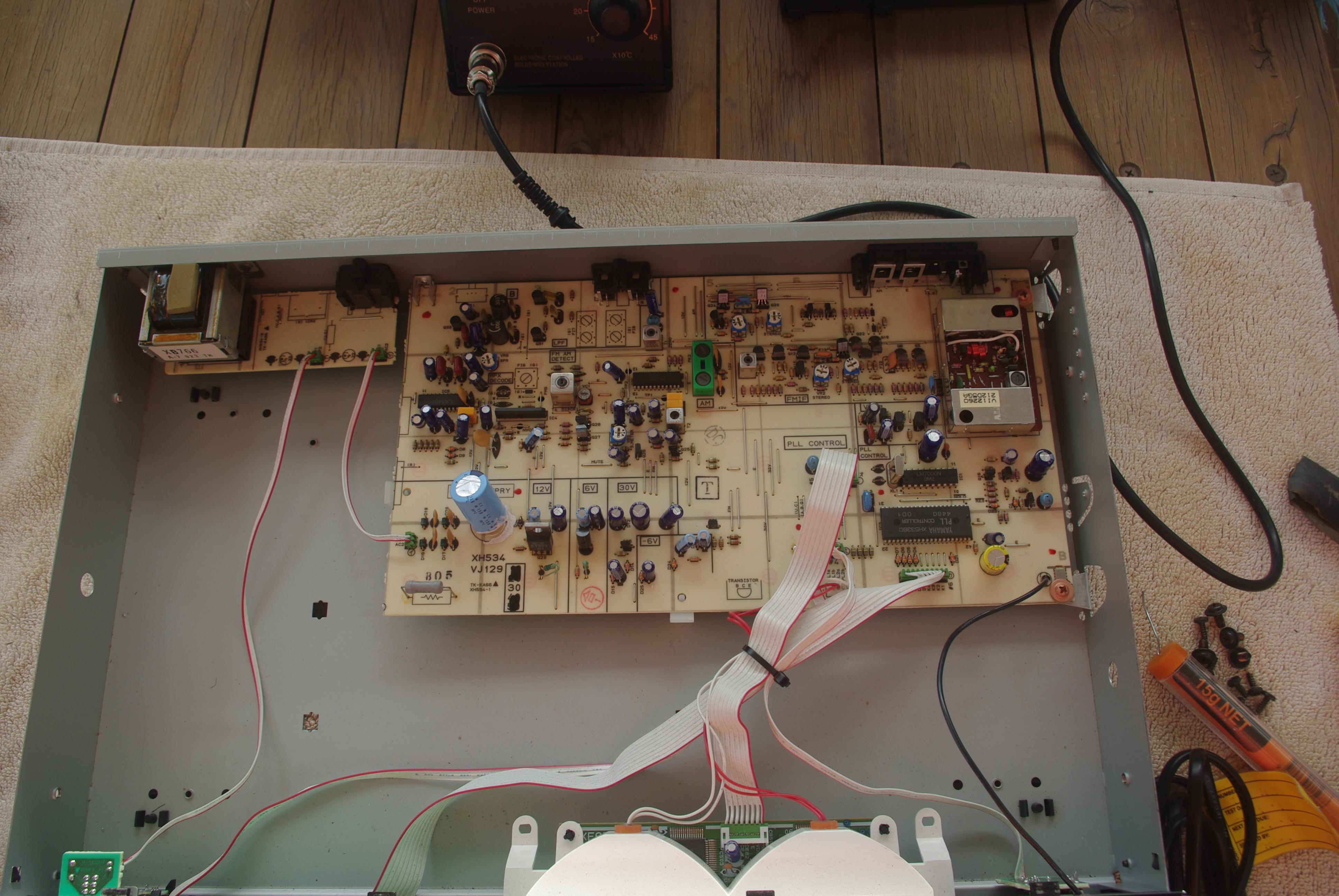

I'll post a photo so you can see what it looks like. Some of the components are hidden under the metal casing. Can't get at them without removing it. Glenn
There are two electrolytic capacitors in the charge pump low pass filter circuit which may cause the PLL tune voltage to sit at a minimum or maximum voltage if they go leaky or have higher than normal esr. Given the age of the tuner it may be easier to check these first before testing for RF faults.
The loopy nature of these synthesisers can be tricky to fault find.
Hi Indiglo, I did test these in-circuit and they seemed OK. Maybe I should pull them and check properly. Glenn
That all looks pretty typical tbh...
There should be some RF from the OSC going to Pin 14 of the LM7000 even if the VCO is out of lock.

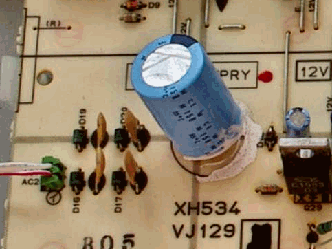

Hi PRR,
You bet! Solder joints, or the connections inside the capacitor are compromised. I would recommend replacing that capacitor simply because of the pull on the leads, even if it seems to work.
You have a good eye! I only saw this after looking at your sniped section of the photo. I would have had to download the picture and zoom into it in order to notice that, but the cap is on a funny angle before your eye is drawn to the snapped glue.
-Chris
-Chris
Hi PRR, Chris, I did pull that cap and it tested OK for both capacitance and ESR. All the voltage test points on board also check OK so I assumed the power supply section was good. However, if you think the cap should go I shall replace it- if i manage to resolve the other issues. I thought the glue was a leak but have seen similar glue on other TX540 images. Glenn
Hi Glenn,
When the leads are pulled hard enough, they can have connection problems inside where they actually connect. Also, the rubber seal around the pins at the bottom may have defects now.
Where the pins still soldered to their pads?
Yes, once you have it working, then change the capacitor.
Chris, the cap was firmly soldered in place before I desoldered it. When I said pull I did not literally mean that I yanked it out. I was pretty gentle in removing it. My fault that it now sits at an angle but it is soldered back in place. I will post more after I test Vt with the variable voltage. Not sure if this unit will ever be working again but it has been an instructive project. Glenn
