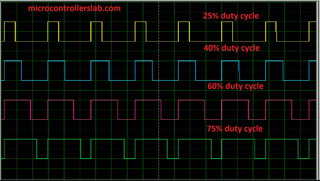

Hi Chris, Mooley, have now checked pins 12 and 14 on the LM7000N. At pin 12, no signal on FM band apart from jagged saw tooth pattern which is probably interference. At pin 12, sine wave on AM band that tracks as auto tuning cycles in search mode. Nothing at all on pin 14 apart from the jagged saw tooth pattern in both AM and FM. I eagerly await your diagnosis. Glenn
Pin 14 is the one to concentrate on. Use the metal can of the tuner circuitry as the ground for the scope and try and trace the connection from pin 14 back to the tuner.
You need to re-measure the signal where it emerges from the tuner. Amplitude of what you see is also important in helping us make a judgement.
If it is still no good then I suspect we are looking at a front end issue in the can, however it would still be interesting to know what you see on pin 17 of the LM7000. Do you see any kind of squarewave? The amplitude would be in the 4.5 volt region peak to peak region and the duty cycle could be extreme i.e. on or off for 95% of the time. Just curious to know what is on there.
What I'm getting at with this is that before condemning the tuner front end, I'd like to see what the chip is doing. If there is no squarewave present then I'd like to see a temporary bodge with you applying a random voltage to the tuning line to see if that changes anything such as sparking the osc into life.

Hi Mooley, I'm not seeing anything with the scope probe on OSC pin of tuner with metal can as ground on either AM or FM. On pin 17 of LM7000 I have a kind of square wave with AM cycling but nothing on FM. Not a classsic looking square wave though but definitely a signal. The wave signal reverses polarity (if I have that right?) just temporarily every so often. Glenn
Lets just go back over a couple of things as I've had more time to re read the thread.
The missing OSC signal on FM points to a problem in the tuner can but you also say in post #1 that AM reception is not working either. In the last post you mention seeing the charge pump drive signal (pin 17) cycling on AM.
On AM as you tune through the band, the signal on pin 17 should vary in duty cycle. See image. The scope should be able to lock onto this type of signal. Is the 'cycling' you mention actually a change in duty cycle and also is the amplitude good.
(Make sure you haven't got any HF filters for triggering engaged on the scope)
If the duty cycle varies (and the amplitude should be as I mentioned before at around 4.5 volts peak above the zero volt line) then the VT line should also be varying in response to that and its DC voltage varying significantly.
If AM is really dead as well then that is suspicious with regard to the missing FM OSC signal as they are unrelated and shouldn't interact in any way.
The duty cycle we expect to see will probably (on a good tuner) be even more extreme than this and go between perhaps 5 and 95%.
