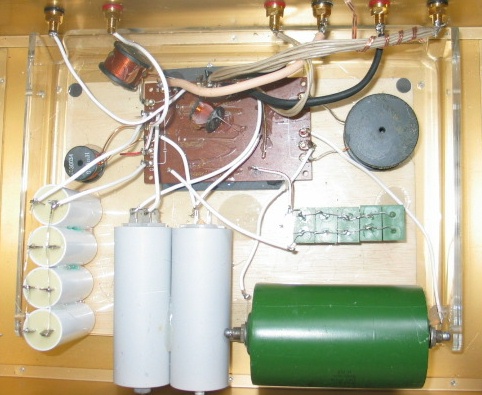

here is my one
I have used different cables for different frequency ranges in a bid to get the most out of each driver.
found that the original iron core inductors were better than air cored ones (only tried one brand), so i left them.
Did not remove the volume control for the mid and treble as i felt fine tuning for the room was more useful - does it sound better when removed from the pathway??

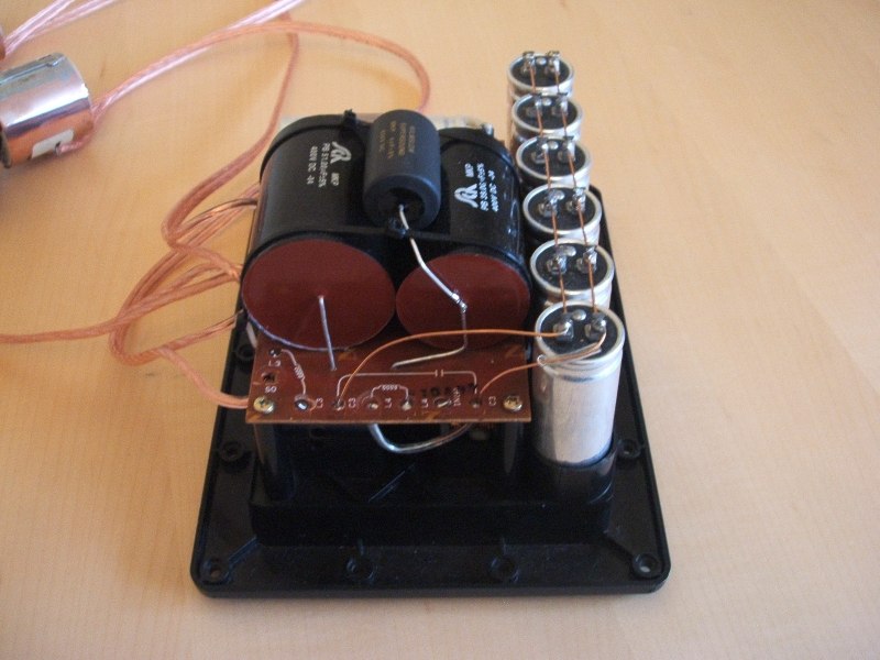

Hi Audiojoy,
I replaced all components apart from the 5mH inductor for the woofer. I had wilmslow audio custom wind me some air cored inductors for the mid and tweeter. Very fair pricing too.
I used Wilmslow supersound where I could as I've used them before and have been very pleased. For the bass section I used SCR 39uF, 51uF and 4uF supersound making the 94uF as in the original. Also used supersound 20uF+1uF and 3.3uF for the midrange and a single 2.7uF claritycap for the tweeter. I used two 33R 12w Mills resistors per crossover to replace the L-pads (which inside use gold plated copper windings interestingly enough). If i remember the center point of the L-pad was about 30-32R raising to just over 40R at the plus 3dB point, so my own should be just a tad over 0dB.
I'll attached a pic of my first attempt at modding the Yamaha's, and yes there was a large improvement from the first version to the second. I'm very pleased indeed with them as they are now.

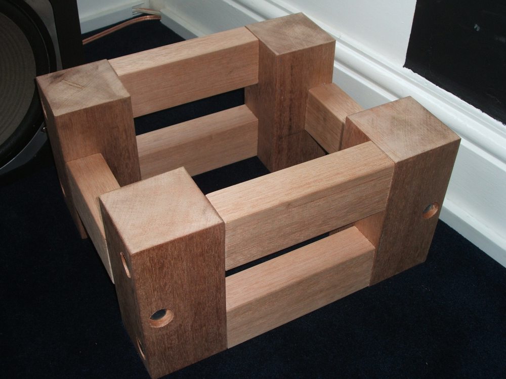

morksbeanbag said:Also, here's my homemade NS-1000M stands, I couldn't find anything suitably meaty for speakers as large and heavy as these so made my own. 🙂
Lovely stands!
I've been looking out for something suitable, without any success. Perhaps I should do the inevitable, too!

The wood is a hardwood called Meranti. Available from Arnold Lavers here in the UK, I initally was quoted £150, then after scowling and saying "are you quite sure?", they went down to £100. Then when the manager came he let me have it all for £50. 🙂
Lovely wood to work with, use fine saw blades. I didn't use any finish at all and they stool look lovely.
To hold them together I used giant coach bolts and wood glue, they are solid as a rock.

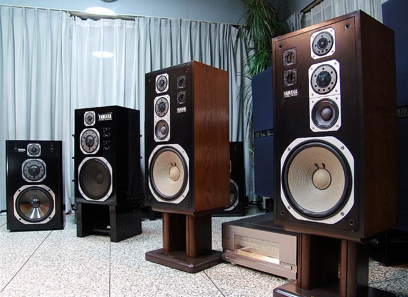

The other ones are NS-890 (had to check in the garage what number), which are 4-way, with two small Be, one mid paper, and a paper woofer (12 inch I think). I was thinking of perhaps using the Be drives to create surround speakers that match the NS-2000. Another long-term project. I keep the drives indoors.
Don't split them up to make a DIY speaker. If I were you I'd use them as rear speakers. If you don't want to I'll buy them off you and use them as rears in my own setup. 😉

If that's NS-890 on the photo, I think mine look nothing like as fancy as that!
I would like to hear them properly, so might install new woofers. Hopefully NS-1000 ones are a good match -although Yamaha was very vague about this. I did contemplate throwing the cabinets away at one stage... The custom surround idea came up since my living room is way too small for large speakers as rear speakers. Of course, if I keep the cabinets I can always revert back to that..
I bought the NS-890 under the illusion that they needed refoaming.. The setback of the seized drives directly led to the NS-2000 purchase.
