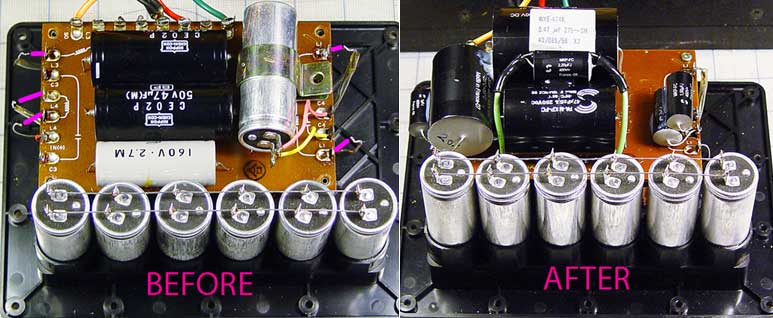

I just replaced all the caps in my NS-1000M's. I decided to use the existing xover board and mounting; I didn't want to go too crazy modding as my NS1000 are pretty darned clean. Plus it was quick to do.
I used existing wire. No boutique caps, just your stock Solens and whatever poly caps I had on hand. I tried to match them up; I would say they are all within 2% of correct value.
For anyone wishing to do this- a quick synopsis. Please see attached pics.
1. Desolder connections just on the sides: L1 on the right; L4, C3 and one leg of L3 on the left. You might need to desolder +IN; mine was long enough not to need to do. Observe wire placement!
2. Flip up the board to access underneath and remove the remaining caps. You might need to pry them off as they are glued to the board.
3. I needed to drill out the holes as the Solen cap leads were fatter.
4. Put in the new caps-
..Start with the two big 47uF (C1) caps. It's a tight fit. Leave enough room on the left to fit C3. Use some sort of glue to attach them. Epoxy, silicon.
..For C3 I used a big 20uF and a little 1uF; the 1 uF just hangs off the board but it will clear the cabinet hole. Using two 10uf might have fit better.
..There is no space for C2 (2.2 + .47 uF) to fit on the board so I glued them to the C1 caps and made jumpers (in green).
..Plenty of space on the right for C4 (2 + 1.5 uF).
5. Screw the board back down and replace the side connections L1, the one leg of L3 and L4 EXACTLY as you desoldered them. Button the unit back up and enjoy! 🙂
Also, while apart, it would be a good time to replace the old pinch-type speaker connections with something more modern to accept banana jacks and binding posts. I got some off ebay; they fit the NS-1000s perfectly. $20.
If anyone wants hi-res of these and more pics, drop me a pm and I'll send them over.

Marck- You mean the crossover or the whole speaker?
Anyways- having a lot of fun here listening thru my music. I would say changing the caps is definitely worth doing!:up: 😀
-Kent
I believe someone earlier in this thread mentioned that the higher-end yammies (NS2000.. etc) did use higher grade poly caps. But the photo they posted was so small you couldn't make them out to compare.
Are you are referring to the six 3.5 uf (to make C3) in a row? I am pretty sure they are 'lytics. The tops are made of rubber and you can see what I think is a safety vent nipple. Not common poly cap construction, even 30 years ago.
These six are identical to the single 3.5 uF used for C4 (on the right with a bracket) in my 'before' pic. The data on it reads-
MPM
3.5uF
100WV.AC
Nichicon Ltd.
S77T0
The rest on my 'before' board are definitely 'lytics, axial type.

In the NS-1000 series the 47uF bass caps are cheap electrolytics. Well worth changing. The 3.5uF caps in the mid section are NOT electrolytics, they are good quality (though there are alot better caps on the market now) self healing metallized paper caps. Open one up and you'll see (as I did with all my 1000M caps) that they are not electrolytics. The tweeter cap (2.7uF) again is a decent quality metallized paper cap, again, there are much better units available now.
The NS-2000 didn't have any electrolytics at all.

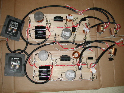

Some people still mod the NS-2000 crossover as in the pic.

Thank you for the clarification. I should have caught the mpm code on the 3.5uF caps.
