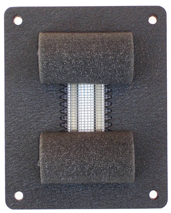

You are also using a Rall ribon tweeter in your NS1000.
What are your experience about them.

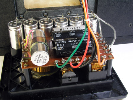

An unusual crossover in terms of choice of component. 6 x 3.5 uF bipolar electrolytic cabs is part of the mid's high-pass filter.
2.7 uF electrolytic cap for the tweeter; there may be room for improvement in both places.
So afterall the 3.5 uF caps are not PIO caps as mentioned earlier by skme of the deaders.
They are Nichicon BP eletrolytics.
No wonder they fail.🤐
