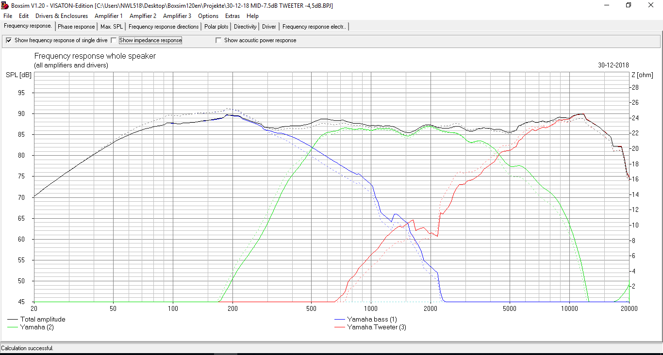

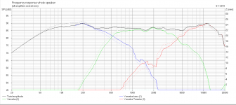

In Boxsim I simulated the new X-over. This software can't simulate transformers and autoformers so I used three virtual amps with -7,5 dB for the mids and -4,5 dB for the highs to simulate the taps of the autoformer. I simulated the 7,8 uF cap for the mids with a 44 uF cap because of the impedance-factor of the autoformer. The Jabo autoformer has a very high inductance so this can be neglected here.
The 2x3,9 uF caps can be of high quality and are cheaper than the 21 uF of the original x-over so the use of an autoformer is not that expensive after all.
The new X-over is based on original L-pad settings somewhere between 'normal' and -3 for MF and HF.
The L-pads are now not dramatic but very subtle. -3 will now be -1dB and the effect is not the same. With the MF-L-pad at -3 the response is almost exactly the same as with the original X-over.
Note the loss in bass response from 60-200 Hz because of the L-C-R. This is a matter of taste. It will make your NS1000 woofer seem to go deeper.

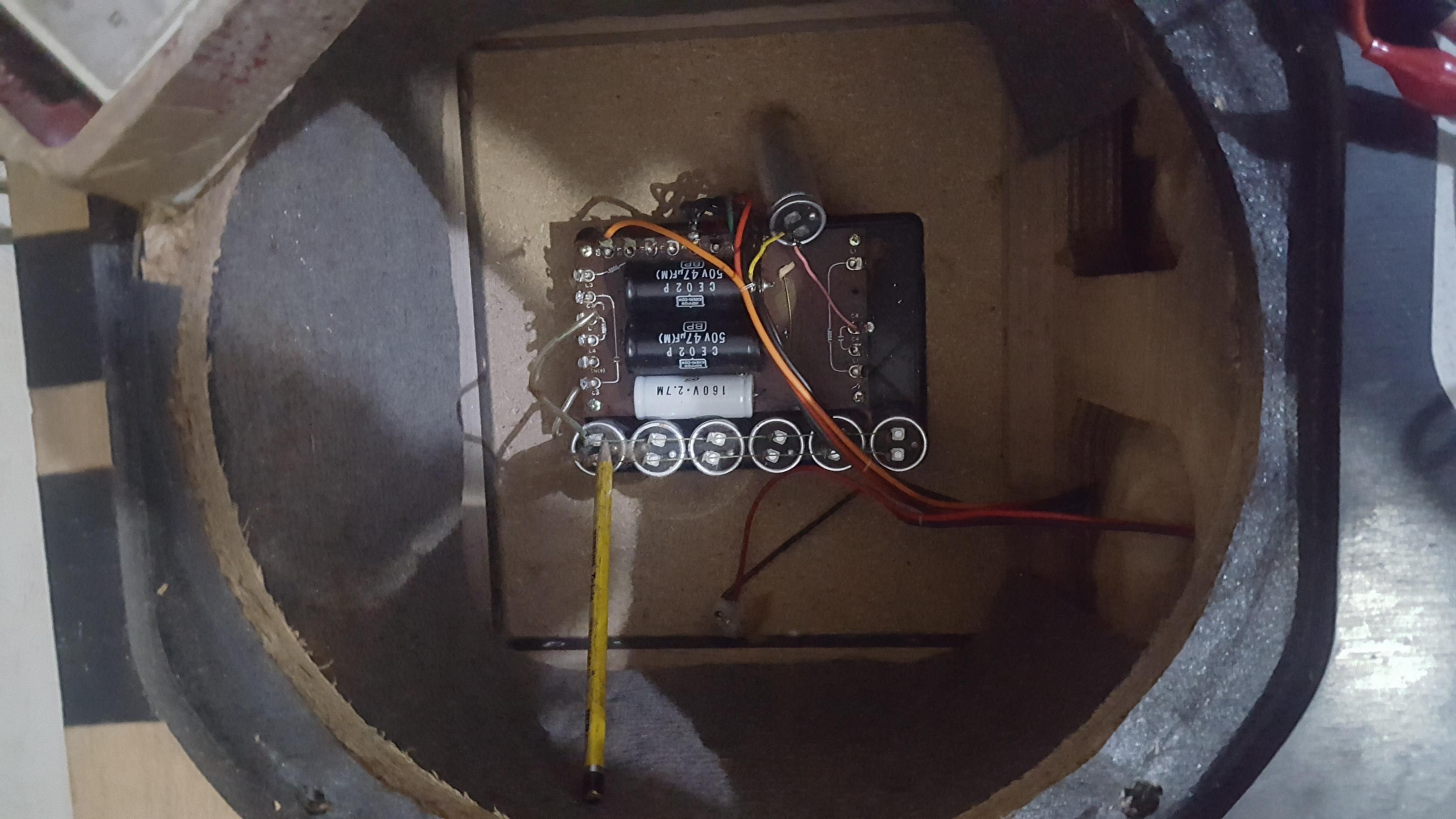

hello to all is my second message in this forum, and I need some answers and help, within 2 and a half months I will have a Yamaha ns-1000m restored.
as I have been reading all the thread that decided that adding a magnet ring to woofer is won in power ??? In deep bass.
another I want to know is some decisive that by removing the yellow fiber inside the woofer earns in better sound ??? is heard more bass ???, then know if I removed the yellow fiber of the woofer.
the back of the woofer is with wood in sight if I add 4mm felt would be better ??, I also want to remove all the capacitors and put them or mark mundorf supreme, mundorf supreme evo oil, jantzen superior or jantzen silver.

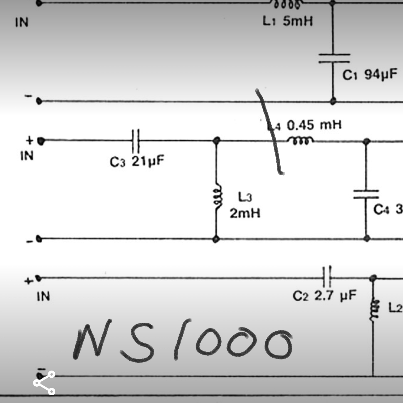

another doubt is if in the filter I replaced the section of 6 capacitors 21uf, and I put a mundorf evo oil 22uf the sound would be affected and the sound would be worse ???.
or it is better to put 21uf is that I say it because in this way it implies having to put more capacitors to make the exact measurement of 21uf.

Capacitors have a tolerance typically of 5% so getting exactly 21 is difficult.Using a 22 in place will have a small effect on the crossover slope but at 500 Hz this will not be that obvious so I would not worry about it.

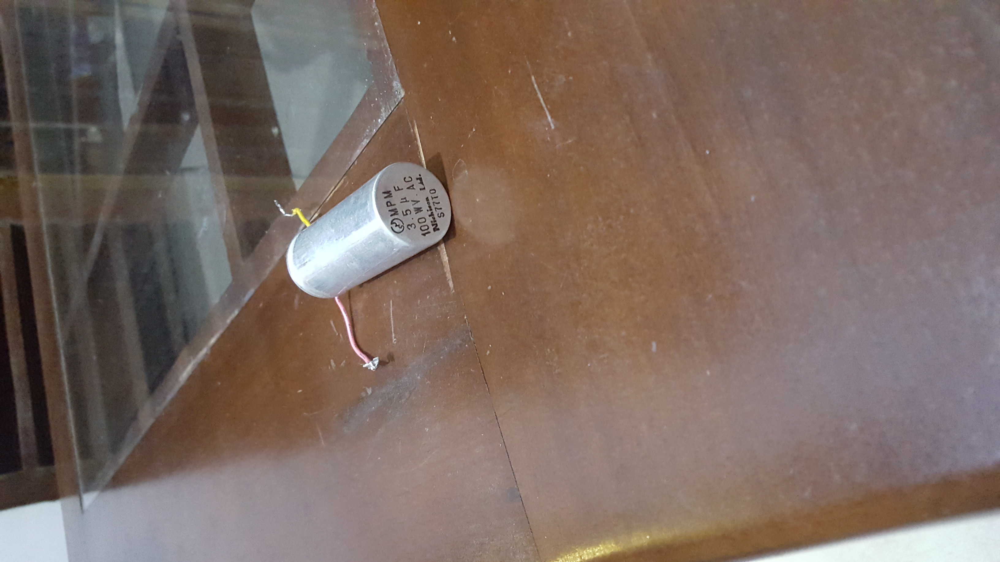

another advance more and is the filter already placed mundorf supreme evo oil condensers, plus supreme silver oil and more white mcap, are already glued and welded together, and lack of welding to the metal strip but solder driver cables I already have yamaha speakers ns-1000m at home, the money that has cost all these capacitors is very high 510 euros, no one and I say nobody has this grade of high quality placed in their filters, only I am the only one that has placed so much level in these filters for these yahama ns-1000m, I will show more progress.

Here is a picture of how all the condensers are located in the original filter and it is excellent, if I got to know before they could fit in this way but good is already mounted and to enjoy them.

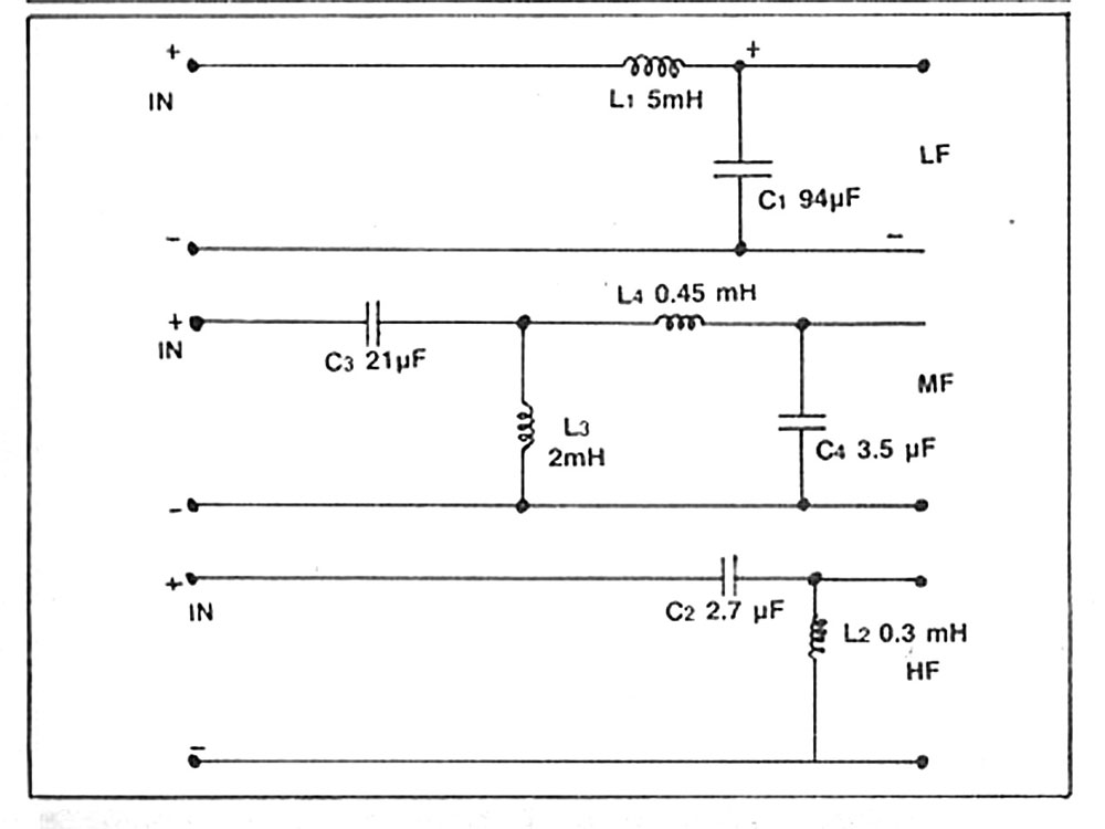

I listen to music loud.
Recently when playing female vocals I noticed the mids distorting in one side.
When playing loud the Pioneer AX4 amplifier tripped.(this should happen only when the amplifier is overloaded)
Disconnected the NS1000 from the amp and measured the resistance with an analog meter. It read 2ohms, which is way too low for the 8ohm speaker. The other side measured 8ohms.
Removed the woofer and disconnected one terminal from the Xover.
Measured again the resistance at the speaker terminals. Still 2ohms.
Disconnected one leg each of the 21uf capacitor bank and the 3.5 uf single capacitor.
Measured and found that the 21uf bank of the original Nichicon (3.5uf X 6) was shorted
and reading 2ohms.
Replaced all Nichicon 3.5 uf electrolytic caps with mkp type foil capacitors.
Fitted every thing back and tested.
The sound was super.
Now I can go very loud and the Pioneer AX4 amplifier does not trip.
The Pioneer saved my Yamaha beryllium dome mid range unit.

the mid spkr magnet is incredibly powerful, pinches the voice coil very tightly and is very difficult to get off the coil. I used a vice grip pliers, after heating up the glue on a cooking stove,to get it to budge. pieces of a credit card kept the magnet centered until it cooled. very difficult.
yes,they're pio caps. I've had too much trouble breaking in Russian pio caps, so I just use mundorf aluminum oil.
the inductors are very important to how the sound is reproduced...noticed immediate positive results with the bass inductor(after adjusting it)... boom, boom, boom!
the tweet and mid controls make a difference after spraying with deoxit.
i put an auto reset fuse relay on the tweet and mid...they're too expensive to repair/ replace. best spkrs for a grand, if the midrange is not hampered by the pinching magnet issue. they truly sound amazing after a bottle of vino 😀
