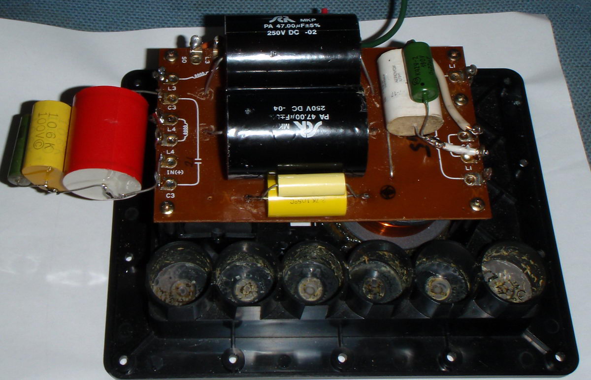

I've made my Yamaha NS-1000M's future proof and I hope my writing is of any interest to other Yamaha owners:
1) I took away the damping material behind the woofer and replaced it with 50 gramms of Twaron. Result: more bass. Not deeper, but more power and kick and detail; highly recommended. I think the original amount of glass wool behind the bass driver was a lot and added acoustically to the weight of the cone;
2) Then I replaced the glass-wool in the upper part of the cabinet behind mid and tweeter with 150 gramms of Twaron. Unfortunately this made the bass become less dramatic again, but still more bass and a bit deeper;
3) I rebuilt the filter and put it outside the speaker. I modeled the entire speaker to see where I was heading to while changing crossover values. The tweeter cap bevame 2,8 uF because the coil is a standard 0,27 mH/0,43 Ohms (in stead of the hard to find 0,3 mH/0,1 Ohm) and that alters the response slightly, a dB less under 3K so that's fine;
4) I've changed to 3rd order lowpass on the woofer with 4,7mH, 68uF+1,5 Ohms and 2,2mH. Coils are only 0,2 + 0,1 Ohm. This decreases the 200 Hz bump, bass sounds dryer now and a little deeper. If you like that high-bass sound then you better stay with the original 2nd order low pass.
The rest of the crossover has the original values. The caps are Obbligato MKP and Audyn Sn.
I think the speakers sound incredible, maybe like when new. Highs don't sound splashy at all anymore.
If you don't want to invest much money, you might as well just replace the damping behind the woofer with something more loose and replace the 2,7 uF cap with an MKP.
I didn't change internal wiring because the terminals on the domes seem too fragile to solder to me.
I had to change the rear plate. It's thick but vibrates more than the rest of the cabinet. Yamaha did a really good job here, using just 22mm. particle board but it is as dead as a dodo. How did they do that...
I noticed one tweeter is a little reduced in SPL. I've seen measurements of 4 tweeters at a german webmagazine that were all 4 very different. Thanks to the very good L-pad, I can increase the level of one of them.

Reviving an old thread.
I am recapping a NS1000M using Polypropylene caps Audyn is what I am using through out.
Just for reference here is the Crossover schematic
When I measured using my Capacitance meter all electrolytics measure more than their rated value...
C-1_1 = 55.4uF instead of 47uF
C-1_2 = 52.2uF instead of 47uF
C-1 Total = 105.6uF instead of 94uF
C-2=23.2uF Instead of 21uF
C-3=3.9uF Instead 3.5uF
C-4=4.7uF Instead of 2.7uF
So when I recap, should I use capacitance values close to there right now or just sticking with the values on the circuit diagram? Which is the better option?
I will have to add extra caps from 1uF to 10uF in parallel to stock circuit diagram values for different cases, if I want to reach the measured values.

If it was me I would go for the values in the posted schematic. However I would also meausere the values for the inductances to see if these are the values in accordance with the schematic. Those coils ought to be very close to the original values as they are not likely to change over time as capacitors do.
When I recapped and changed the coils the result was far from satisfactory and I was disappointed with the result. However, I found that neither my new coils nor caps had the right values when meassured. So I had to buy more caps and adjust the values when not spot on. With the coils I had to ad a couple of turns and in some cases wind of a turn or two on some. The coils I changed to were air coils and that I would highly recommend. If you do go ahead with that project I highly recommend going for coils with the least possible resistance. They are not cheap but very well worth the cost IMO.
First I changed the caps and listended to the improvement and then changed the coils so that I could here how they contributed to the totality.
The above was my aproach but sound is highly personal and dependend on all the other components in your set up so if you think that everything sound fine now maybe you should stick with your meassured values.
I would also highly recumbend cleaning the I-pads with some cleaning fluid. It made a big difference regarding clarity in my system.

IMHO, you should always replace caps with schematic target values, not what you recently measured which could easily represent aging and drifting from target. Especially with electrolytics.
The Graveson kit comes with extra resistors to allow fine tuning of the MR and HF to suit your taste.
As far as I know, electrolytics only will lose capacitance won't increase the capacitance as they age. So yes they may have drifted from an even higher value. Definitely not from a lower value.... Hope you get the drift 🙂
And schematic values are even lower... So the effective capacitance is gonna be even lower than what was there before with electrolytics. That is my confusion.
I personally have measured vintage caps that have drifted upward. Some downward as well. The key point I tried to make is replace with values the same as printed on the cap you are replacing or on a schematic. DON'T trust measurements of vintage lytics as a guide for targeting uF values.
Don't forget ESR as well. That also drifts upward making the cap behave more like a resistor.
