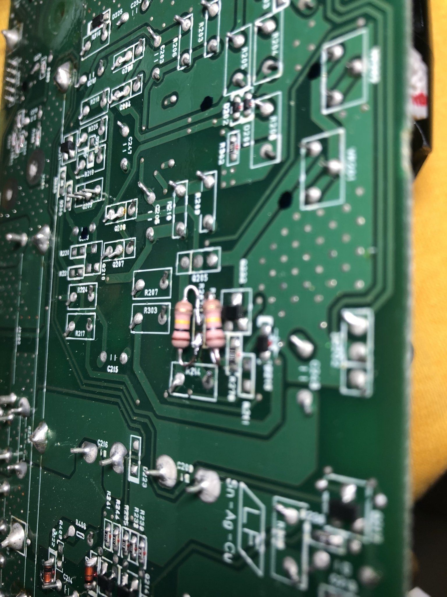

I fixed a AS3000 some years ago.the AS3000 didn’t work like yours.one channel didn’t work before I received it,then two channel didn’t work.
After checking and finding ,I replaced the two 100k SMD resistors by axial resistors,R94 & R287,the channel restored.the other channel restored after the same fixing.
I think that the root is the less-margin power rating of the resistors.

Interesting, thank you! How did you find it out? These resistors are on the Main 1 and Main 2 (the power amplifier) boards, aren't they? Well, these woulb be relatively easy to access.

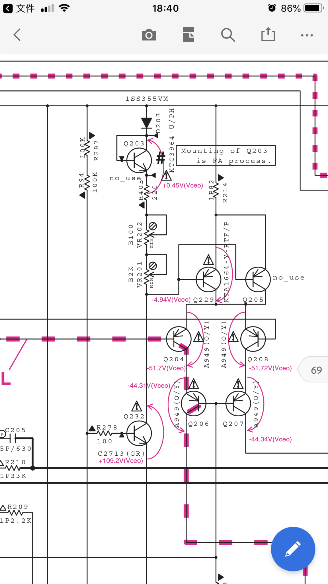

Yes ,these resistors are on the Main 1 and Main 2 (the power amplifier) boards.
Initialy I didn’t check these resistors .
I checked that the forward voltage of D203 is zero(would be -2.?V if using DMM because of interfering),thus I knew the Q232 of CCS didn’t work.

I don’t think that these resistors are fusible.IMO,the less rating of them is the root of the durable of AS3000 being not so good.
All PS of my AS3000 were okay before I repaired it,thus I can check the D203’ s volt after turning on .It didn’t work just because the speaker protect relays were inactive .
The most components of power amp are unreachable except for D203 etc .I found that the D203’s volt is indicating of VAS work,after I analyzed the power amp section by drawing the attached simplicity diagram.
The time of my fixing is short,and of my analysis is long because of the most components being unreachable.

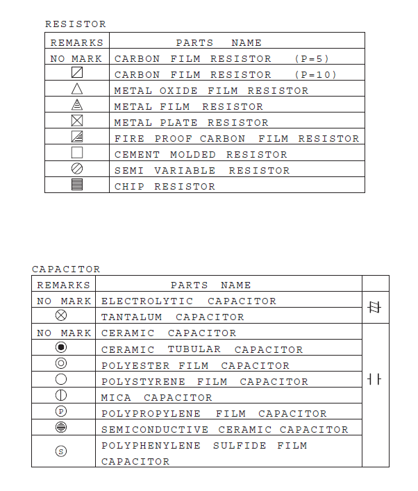

Page 2 in the SM says:Some of the resistors you note as less rating are fusible for safety reasons. Fingers crossed that they are intact in this instance and have not gone high in value.
Critical Components Information
Components having special characteristics are marked and
must be replaced with parts having specifications equal to those
originally installed.
The quotation misses the symbol that can be described as a triangle around an exclamation point. Resistors R93, R187, R94, R287 that X.G. has successfully replaced also are missing this symbol, hence aren't critical in Yamaha's sense. Instead, there's a black triangle next to them (and many other components), which Yamaha failed to explain.

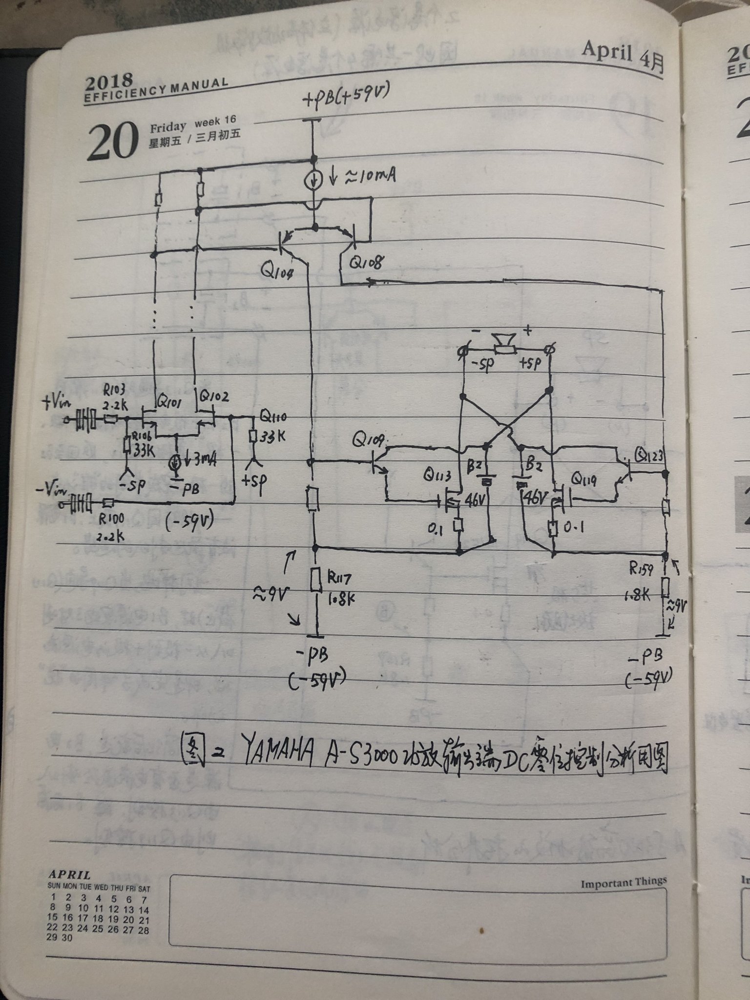

Hi,mjona.Sorry for my mistake in last post about the speaker protect relays.
The AS3000 actually isn’t mine,is the 3th person’s.My friend had repaired it for several months before I received it.
I just read the records of my notebook,and the records show that the conditions of the AS3000 when I received it:
1.My friend had checked that all circuits were okay except for power amp ,and not found the fault.he detected that the music signals reached the input of power amp by scope monitoring.
2.The speaker protect relays were active after turning on .
3.the headphone sockets can output music signals,the speaker terminals cannot.

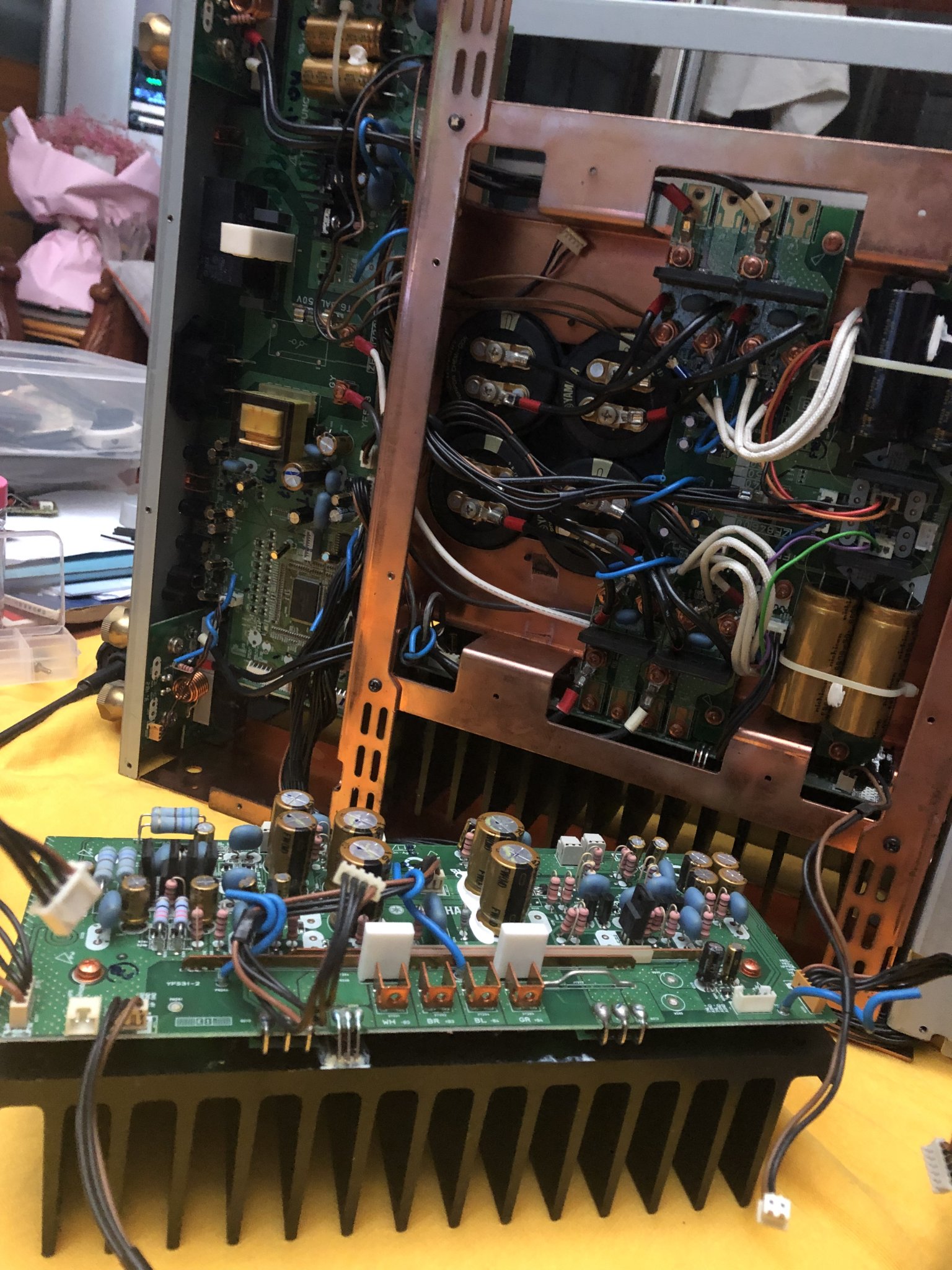

PS : Disassembling the power amp module out of the AS3000 enclosure maybe need a special screw driver in the attached pic.
