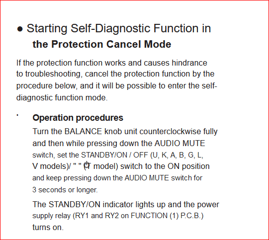

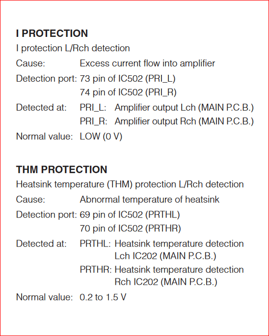

There is a sub-transformer in series with the on switch which feeds a full wave rectifier to charge C2 to a level of 9 Volts. This is reduced to 5.6 Volts by IC506 which illuminates the Micro standby LED. There is another Micro feed to IC411 connecting to REM, and separately to IC504 "standby control" connecting to "Control around Tone control /Volume expanded IC"
There is a relay connecting to C2 live end through a resistor and relay with a transistor Q2 connecting to ground.
The respective circuit numbers for these three micro connections are +5M, +3M and +5S (possibly this to activate Q2 the shunt of some IC506 current to ground in order to turn the LED off)
I am attaching the Block Diagram protection information from the Service Manual. It is not clear if those other than the power supply protection have been tested. We know this is not working properly and it cannot be forced to do so by increasing PRV from an external source.
There is a number of checks to be made for components in the sub transformer area - rectifier diodes, C2 and various IC's etc as mentioned in the first paragraph.
