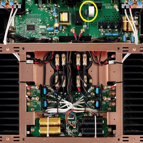

This is C14, the RFI capacitor across the inrush current limiter relay contacts. What a big surprise this would be. Anyway, to get access to the soldering side of Function 1 board I'll have to disassemble the unit quite more than I had done yet 😳...

If it's yours, honestly, the Dremel is your friend.to get access to the soldering side of Function 1 board I'll have to disassemble the unit quite more than I had done yet 😳...
you open a window properly below and then you close as properly and basta.
Well, that would mean to dremel through three other boards that are sandwiched with it ;-)!

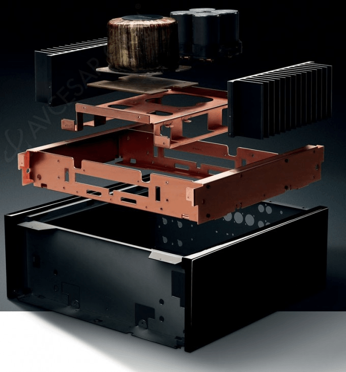

The photo above shows what you see after the bottom plate is removed. These components are hanging upside down. Above Function 1 is the Function 2 board, followed by Input 1, then Input 2, which is the uppermost and wrapped in some shielding.
The unit's mechanical construction is nearly as tricky as it's electronic one.

Fortunately this pic doesn't show the many dozens (literally!!) of small screws that hold all the pieces together ;-)!
I counted two dozens alone for the bottom panel.

I saw that yes, this amp was built like a Mclaren LMP1.
I only see two paths emerging.
either you disassemble it (long and tedious)
either you entrust it to a yamaha station (fast and expensive)
