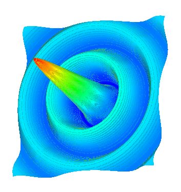

I'm been considering different ways of displaying the data to make the off-axis response information more user-friendly. The WPF programming environment in .NET provides some nice 3D functions. I found someone's code that populates a 3D volume with random data, and you can spin the 3D volume around to view the data from any angle. The next step is to calculate the response at regular points in that 3D volume using the data generated by the PSD crossover and baffle response modules. I still don't have a clear idea how it's going to look and how to use the color and transparency information as another dimension (frequency), or whether the frequency needs to be selected using another control. But I think the approach is promising...

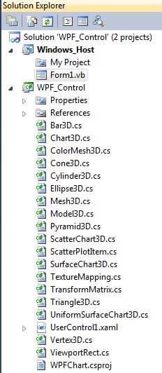

In order to speed up the diffraction calculations, I broke the frequencies into 4 bands, each with its own thread running in the background (background worker). That way a multicore CPU could execute the threads in parallel, and the user interface remains very responsive. You can move drivers around on the baffle with no lag, and when you stop moving the last calculation will catch up and get displayed. That's what I planned to do with these scatter plots--just run them in the background and let them get filled in for as long as the user wanted to wait. It might take several hours to calculate all of the data, but by prioritizing the summation points to provide the most important information first, this could be a useful tool.
BTW, I was pleasantly surprised by the ease of integrating this sample 3D code. It's in C# using WPF, but I was able to compile it as a library and call all of the functions and access its data from VB.NET using Forms rather than WPF. I had no idea it was that easy to use VB and C# together, or to execute a WPF 3D application from a Windows Form. You can see from the first attachment that it is a mix of VB Forms and C# WPF. I've got a form with a textbox and update button to specify the number of elements in the plot, and the WPF control uses this information to update the display. The same sample code also has a nice 3D surface plot that you can rotate around and view from any angle, but I don't think this display will be as useful (second attachment).

Why does is it have to be WPF? Can it not be built in Forms?You can see from the first attachment that it is a mix of VB Forms and C# WPF.

Not easily. Using Forms would require 3rd party libraries that have support and sometimes cost issues. But WPF has an integrated Viewport3D element based on Direct3D that is fast and well supported. It's not suitable for complex games, but it should be fine for visualizing audio data. It's easy to change the camera position or lighting, and there is a Transform3D class for rotating and resizing the model.
Here is the link to the sample code I've been playing with: High performance WPF 3D Chart - CodeProject
