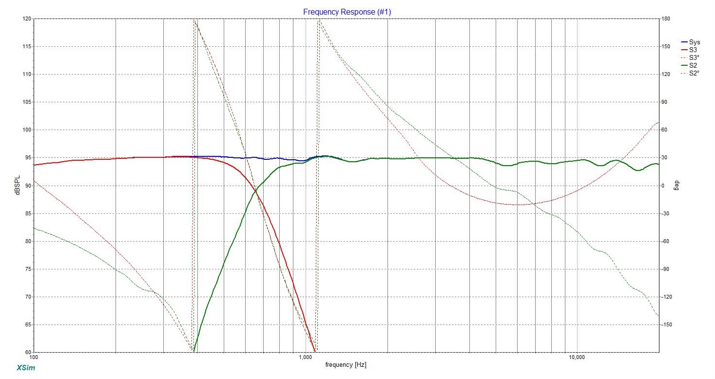

Changing phase tails beyond measurement window
What do you look for to see if changing the phase tails improves accuracy? I've played with this but have no conclusion about correct or incorrect. Do you try to match the measured slope?
The operation that creates phase from a frequency response is called the Hilbert Bode transform. It's most accurate when it has data from zero to infinity. That's not possible so adding tails is a way of extending the frequency response to make the transform as accurate as possible. So the tails are an estimation of the speaker's response beyond the measurement. Yes, you try to match the low and high end slopes of the frequency response. This is usually easy with the low end responses, but harder with the high end responses since they may include break up responses (woofers) or simply end before an roll-off slope occurs (tweeters). I typically use 12 dB/oct on the high end.

Thanks ernperkins. Your response seems logical to me. I've adjusted the tails up and down, trying to match the measured slope or greater. Woofers with high breakup seem to fall faster, after the break up, than smoother woofers.
I wonder if adjusting the lower tail on a woofer is useful for adding the room rise in low end response. In my case, the room starts to rise at 9dB/Oct from 27Hz down. Would subtracting that rise from the woofer fall in the bottom be useful? For example - if a closed box woofer falls at 12dB/Oct, would a -3 tail on the bottom, at the right frequency, be useful?

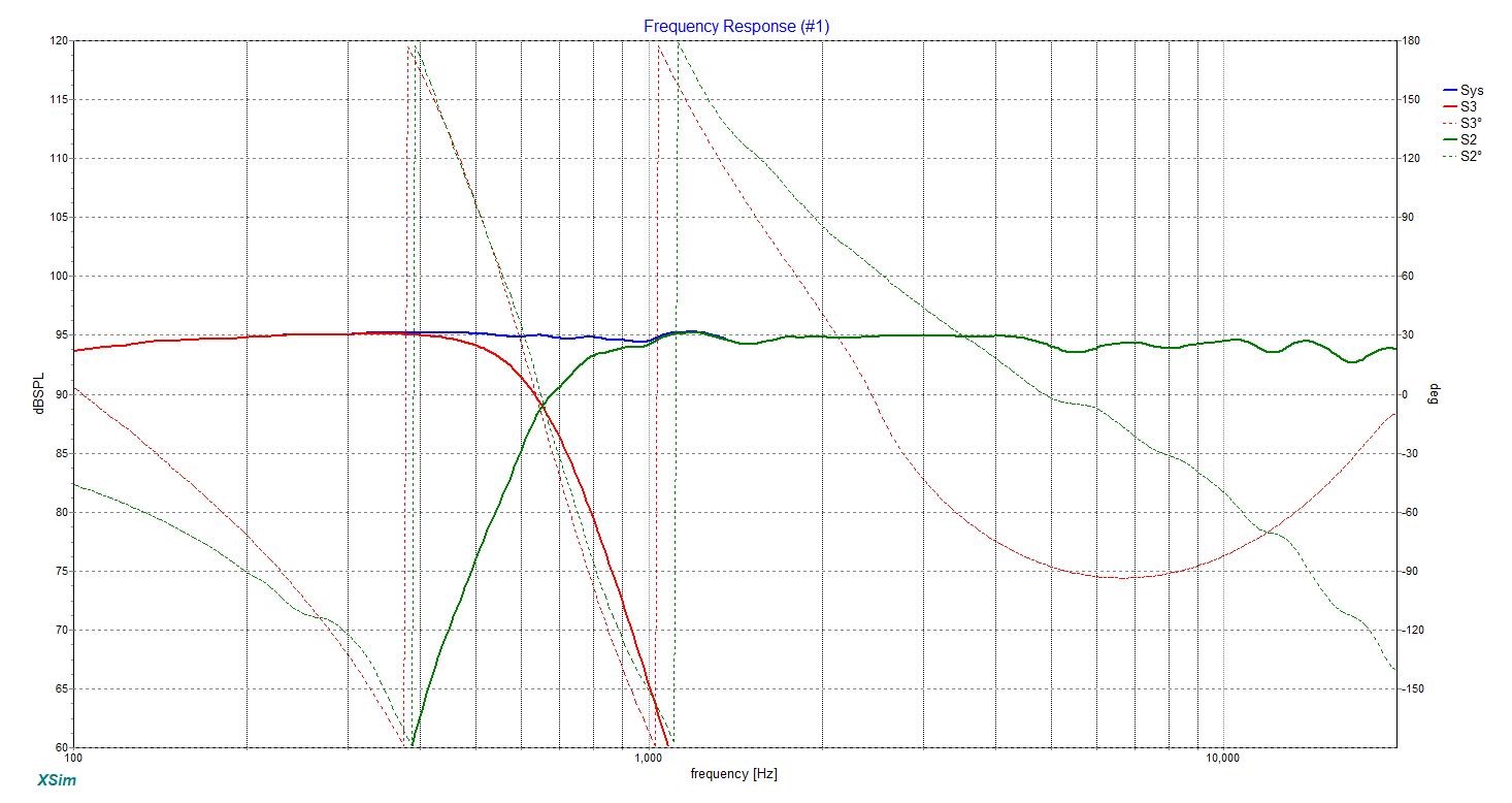

Tail slope affects phase tracking
Perhaps I'm asking too much of the modeling part of the program and should accept being in the ball park. Altering the phase tail does alter the phase in the 'normal' range, while doing virtually nothing to the frequency response in the normal range, or anywhere. Phase tracking in the crossover region and beyond, on both low and high sides, is affected by changing the slope of the tails.
I'll add a couple of pics for examples, just changing the slope of the upper tails on the woofer:
15" woofer. 9db upper tail. 2.5Khz -
https://www.diyaudio.com/forums/attachment.php?attachmentid=999037&stc=1&d=1637418337
15" woofer. 15db upper tail. 2.5Khz -
https://www.diyaudio.com/forums/attachment.php?attachmentid=999039&stc=1&d=1637418338

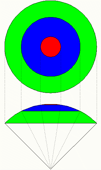

Please, what are you describing with your target pic?

The relative insignificance of an on-axis measurement as seen by sectioning a sample radiation pattern. (This was drawn for a waveguide but the point is the same...)Please, what are you describing with your target pic?
What you see on axis through breakup can be very different to the average sound. You said...
Rather than the ball park, think about using the average. Ordinarily that means if you take measurements at different angles, you can get your average from them.. however all I'm saying is be wary of getting fixated on the more extreme looking but less significant features of the on-axis response because they are far from average.and should accept being in the ball park.
Also, rather than pointing at the wall and get the spike back as a reflection, try to send it up the room so it comes back averaged.

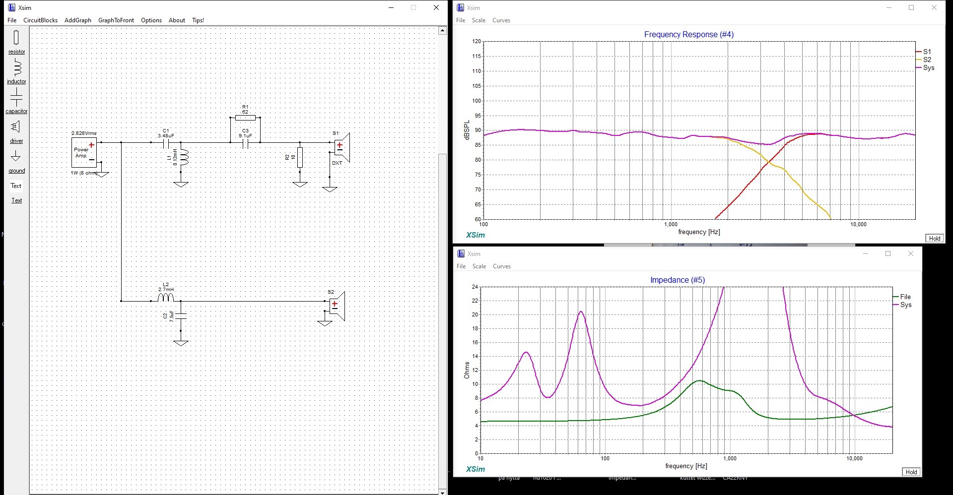

Hi. I started with xsim today. This is my first time with crossover simuation software.
I have experience with DSP, measurements with ARTA and also passive crossover design with the time consuming «test-messure-again again» method.
Is this the right way to work?
I measured the impedance with the drivers mounted in the cabinet with Dats V3
I traced the FR curves from Seas with this software

A person could find themselves doing this with any crossover method. Inherently it's fine, but it may be a sign there's a problem.. so the question is why, or what do you find when you do? Also what's different about how do you do your DSP crossovers?the time consuming «test-messure-again again» method.
That was then. My question was directed to the new way to work 😂
Please read from «I measured……» and see if i do the right things with Xsim?

Please understand, I do my DSP crossovers exactly the same as passive (except for the filters, of course), so I'm trying to understand where you're coming from as well 😉
OK, you've traced manufacturer data but I would have measured. What is your reasoning there? The manufacturer data doesn't include your cabinet.
Thx. That is things i dont think about. Off coarse i have to measure the frequency repsonse in the cabinet.
OK. I have ARTA, can i measure there and make frequency files? Maybee i need a payd license?
*.frd files are simple text files. Besides, anywhere you can take a screenshot, you can trace one.
Until you measure the driver raw response in your cabinet, the simulation won’t be accurate. Mostly it’s the acoustic offset which needs to be accurate to the mm. This can only accurately done by using acoustic interferometry. Measure in actual cabinet, woofer by itself, tweeter by itself, both in parallel and never touch the mic or the speaker. The use Xsim acoustic offset delay to predict the combined measurement from the raw measurement down to the last wiggle in no smoothing mode. Then you can accurately predict the XO’s effect.
Not so. Why wouldn't you simply measure each driver while leaving the mic in one position and including the natural timing?This can only accurately done by using acoustic interferometry.
This is for people like me who still don’t use a two channel audio interface for timing info. MiniDSP USB UMIK-1 has no timing info. Mic is in one position - cannot be touched. I haven’t bought a calibrated XLR mic yet. So I guess I should have said if using only 1 mic and no timing info, can only be done by interferometry. I also think that the interferometry provides very conclusive evidence that simulation is working correctly before any filters are added.
