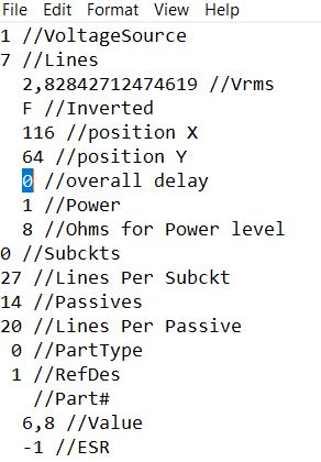

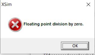

XO design part is completed with values and curves are populated, when i close and reopen project .dxo file then error pop up.
opening project .dxo file in notepad, any clue on which value that related to the error "Floating point division by zero".
great, another trick 😀 solved now

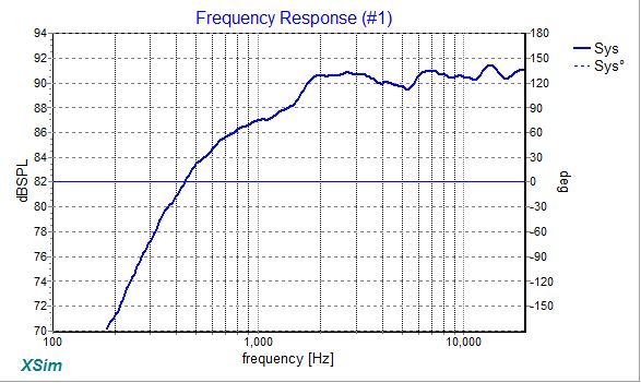

I was wondering if anyone would be willing to look at my first XSim XO before I start ordering parts.
