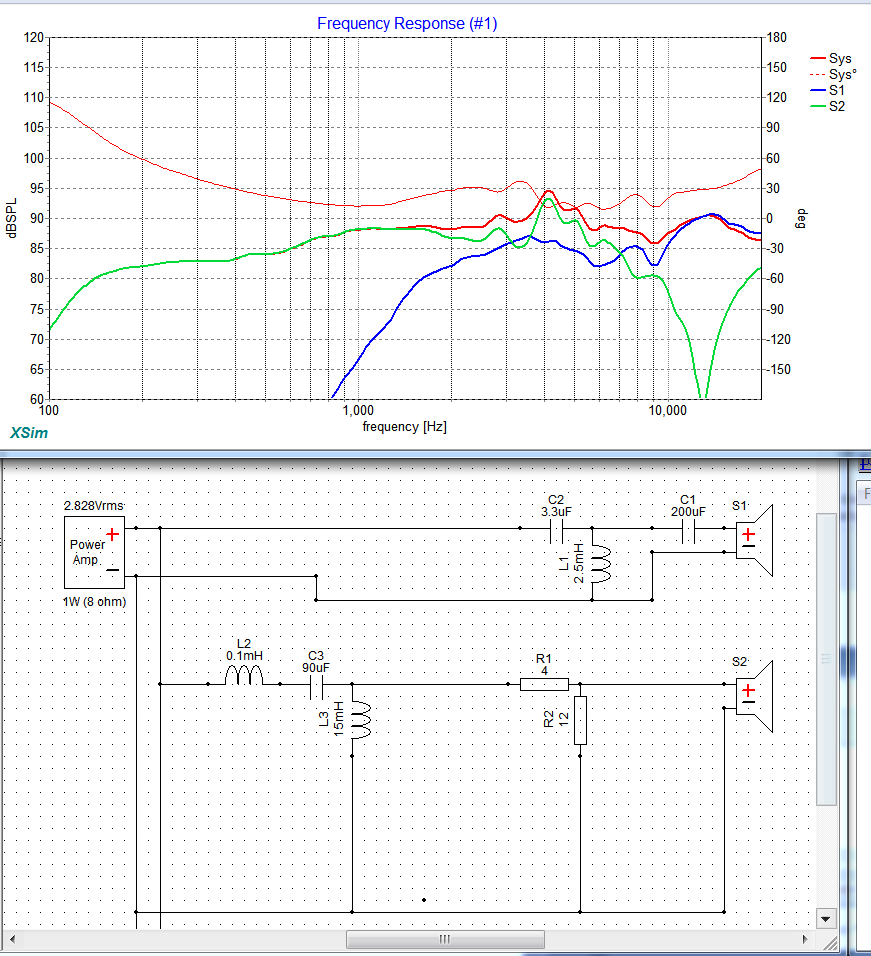

The mid and twt part - I am focused on them for now.
Maybe someone could give me a hand where to find a tool that would calculate a notch (RLC) for the 4k peak - 5dB, Q=5 ?
Have you tried using the Xsim circuit blocks, for a series resonant circuit? Put it across the driver (or earlier in the network -- but NOT across the power amp) and a resistor or other series impedance ahead of it.
But XSim was designed to be mostly used iteratively, to avoid things like needing formulae and related tools. Put in the component arrangement for what you are after, then scroll through values of eac components to see what happens -- it doesn't take long to get a feel for what is going on or for the size of inductors, resistors or capacitors that affect the frequencies you desire. I think that way is more instructive than using some online calculator (which seldom gives the expected results when attached to real world impedances like those of drivers).
BTW, it might be better if you attached the '.dxo' file for your crossover to your post. Then other people can start with what you have, including the driver responses and impedances you are using (those are part of the .dxo), Not many members here will want to spend the time to enter the circuit by hand and guess what your drivers behave like. With a dxo, they can just click, open, and play with components.
edit: for example, download (click in most browsers) to get this example, play with C6 to see how it behaves, then with other components like L4 and R5.

Could you please give me feedback if again my EE knowledge and passive xover assumptions are correct: as far as the dips correction (local dips below the target average FR level in the region covered by only one driver) is concerned the only way to do it is to lower the overall efficiency and then use a reverse notch (bandpass filter) that could locally lower the impedance in this region and effectively boost locally FR ?
If the above is correct then it seems to have little sense with a passive xover it is rather not done in practice ? So dip correction make more sense with DSP (although along similar principles but with much more flexibility) ?
And one more tool question - the fact the acoustic centres are displaced in space has impact on the overall speaker FR but it is not possible to model in XSim ? So XSIm model assumes all the drivers are coincident in space ?
Why do you have the dip? Room problems are usually not a good choice to fix with a crossover.
On the other hand you can use resonance to boost a response to the target level.
It is not due to room, my Seas coaxial has a dip at 9k probably due to it being coaxial and mechanical consequences of tweeter location.
I have tried to boost it with an RLC but it did not work in XSim and I thought it does not work by principle - if the RLC should work by providing lower impedance at some resonance region then it is not gonna be effective since there is no higher impedance to work against - the tweeter xover is low impedance in this region as well ?
If I am lost EE-wise again please suggest what kind of circuit for 9k dip should I try ?
Look at the off-axis. On-axis will probably be worst for a coaxial. A smoother off-axis design point may be warranted. A small degree off-axis may be the best listening position.

Could you post your XSim .dxo file? It would help us to see all the details. Also, what Seas coax are you using?
