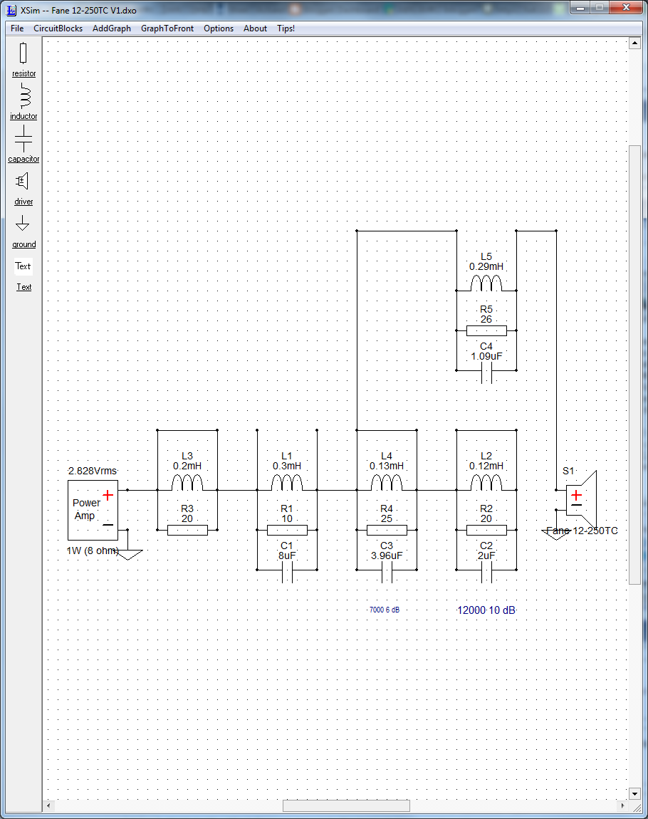

Speaker frequency response correction
This is a great intuitive tool! I am trying my first speaker correction network ever so I may be doing a lot wrong, but at least I can see what's happening.
As far as I can make out the tool allows me to put a network together and then see the results. The actual values of the components to put in is not given by the program as far as I can tell. So for that I use some on-line calculators for parallel notch circuit mh-audio and a contour network DIY audio and video. This involves a lot of ALT-TABing, but it works.

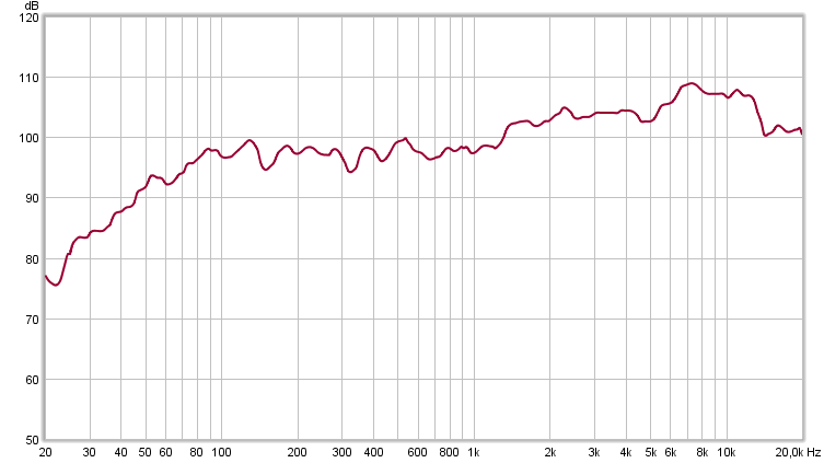

I am trying to come up with a (initially) passive correction network for a Fane 12 inch broadband speaker 12-250TC. To do so I manually converted the frequency and impedance curves into .frd and .zma files (attached).
I have attached the results of my efforts thus far: a correction network (note some modules are inactive) and a corrected curve.
Now my questions: 1) is this the proper way to go about this and using the program and 2) what about my results? I bet this can be improved upon?
As noted, I am starting out (and learning!) with a passive correction network, but since this is a full range speaker, it will be fed straight from a power amplifier which should allow me to get the same results with an equivalent active correction filter which should have the obvious advantages of lower cost and better control of the speaker.
So the next question will be 3) how to convert this to an active equivalent?
But I will settle for an advice on 1) and 2) for now!
Thanks, Jan

jdelange,
Agree this is handy intuitive tool, regarding your use of online calculators think maybe try too use build in menu "CircuitBlocks" there you will find series and shunt filters.
Don't know procedure how you manually did frd-file response for FANE driver but think your curve looks crude compared datasheet, therefor tip use free FPGraphTracer to capture frd and zma files from any picture, below is into REW traced example of your FANE driver in higher resolution FPGraphTracer : fprawn labs.
Here link to REW should you find it usefull REW - Room EQ Wizard Room Acoustics Software.
As help for passive and active filters there is a lot of help from Charlie Laub and Jeff Bagby here software.

There are a number of tools which will convert pictures to FRD and ZMA files, such as SPLCopy. Sometimes they need a little help from Paint, PhotoShop or Gimp, but they work really well.
If you are going to go active, miniDSP would correct that quite easily for you. I think they have a way of importing an FRD and simulating the effect of the filters in the plugins.
I don't think they have a free demo though.
Personally I use OmniMic (also by the esteemed Mr. Waslo) which can create bi-quad lists for use in miniDSP automatically. I also use OmniMic to add phase data to FRD files.
But staying in the passive domaine, I think you just need a bit of a shelving filter. You have too many parts. 🙂

Thanks BYRTT!
I manually took values at whole log-step frequencies (20, 30,...1k, 2k etc.) from the chart and created text file. I assumed this would be sufficient to try and shift a curve.
Scanning is clever indeed! Later I discovered there is software like SPL Trace Tutorial (German). I plan to get into REW once I start measuring.
I looked briefly at Passive Crossover Designer 7, but I was a bit overwhelmed. That's what I like about Xsim, it is easy to follow, also for a starter.
