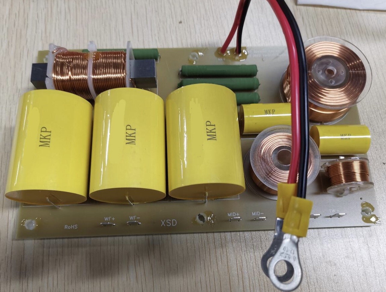

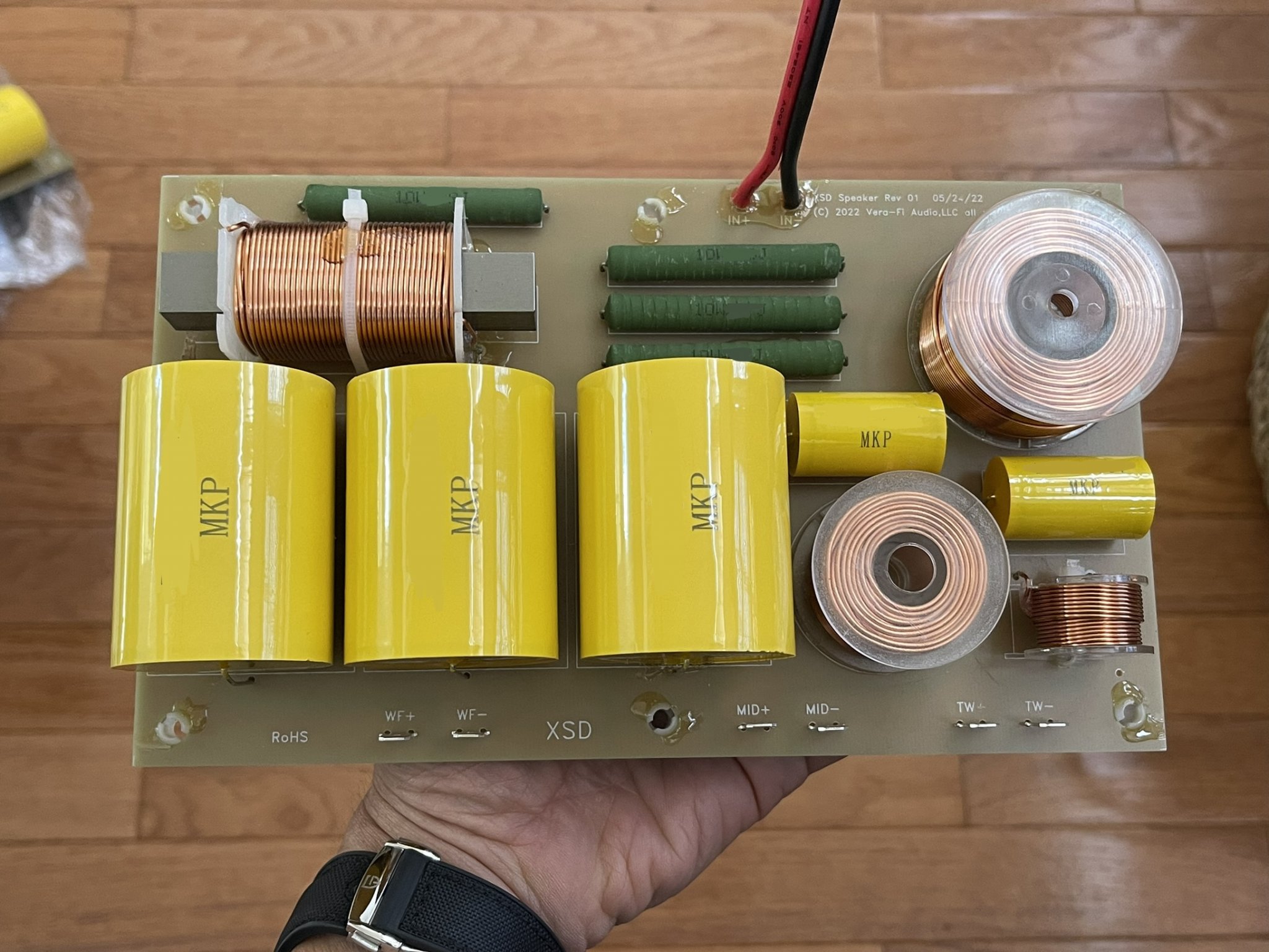

This is the pre-production sample crossover for the commercial XSD Speaker. I decided to go with all film caps (MKP). I might have to rotate the middle air core inductor 90deg to reduce cross talk - but that might be minor effect. The DIY version of this crossover will of course, be different. Much more colorful and bigger with red and black and yellow and white film caps, also will have fancy Mills MRA resistors.

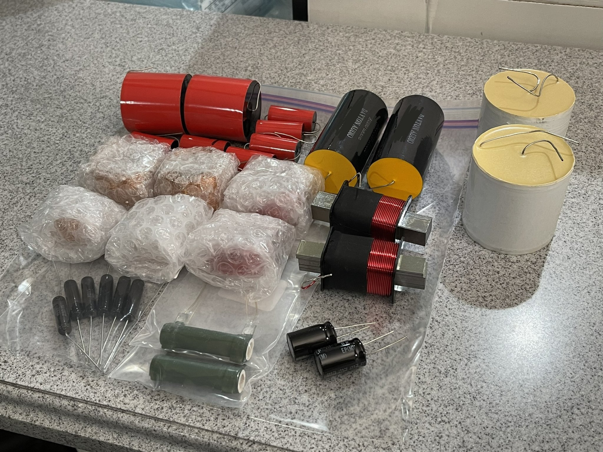

Most of the XO parts arrived. I am waiting for the back ordered iron core inductors and one of the film caps. Here is what a complete kit looks like. The two large black caps in the back are the 250v Dayton MKPs vs the two “big cap option” white ones are the 930v MKPs. I have assembled all the components into kits.

I have a correction on the voltage rating of the big cap. It’s 500vdc not 930vdc. Still better than the 250vdc of the Dayton. They are labeled 330vac and I multiplied by 2.83 to get the peak to peak of 930vdc but looking back at quoted specs they say 500vdc. Sorry about the mistake.

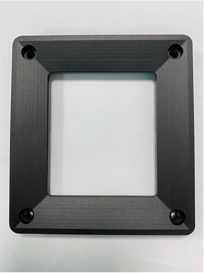

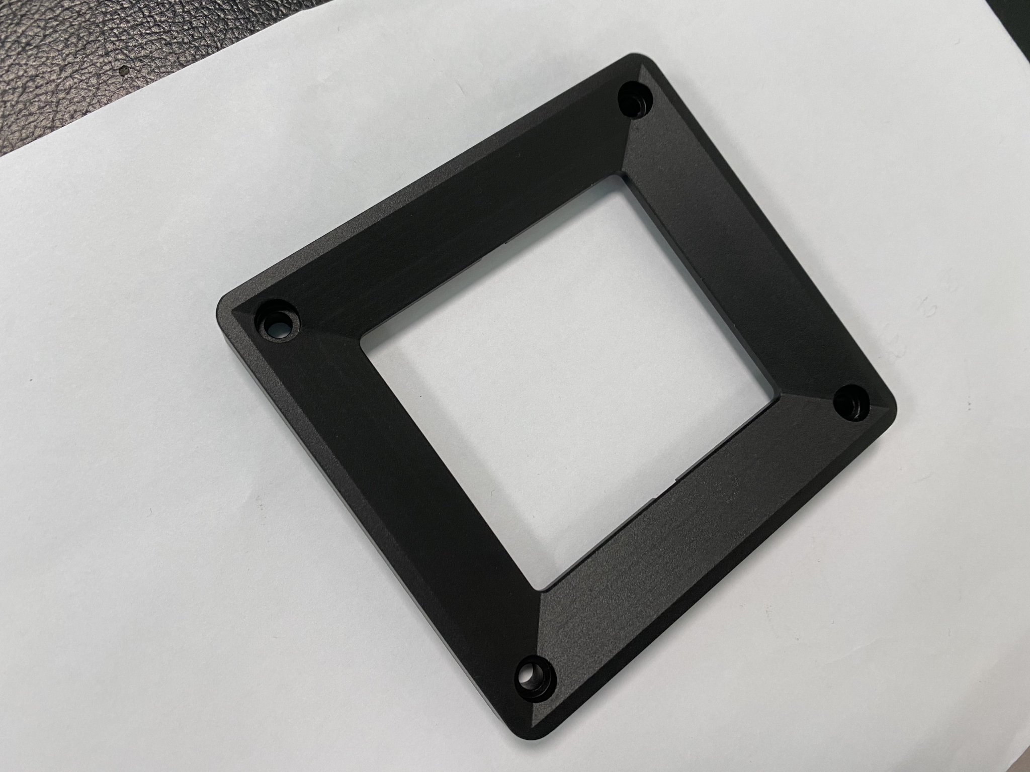

I have good news. The CNC’d waveguides have completed production and have been hard anodized and are shipping out today or tomorrow. I also managed to get a batch of iron core 18ga inductors custom made just for our GB. I tried finding a COTS one available in-stock anywhere - simply not there. I’m going to have to pay for the courier express shipping from
China though on this rather than make you all wait until August 20 for the back ordered ones from Parts Express. Thanks for your patience.
