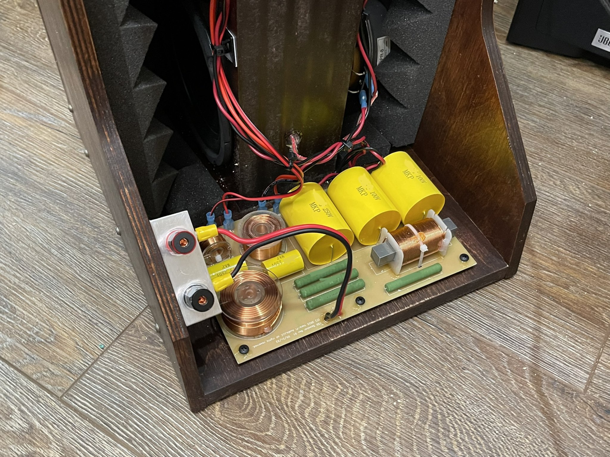

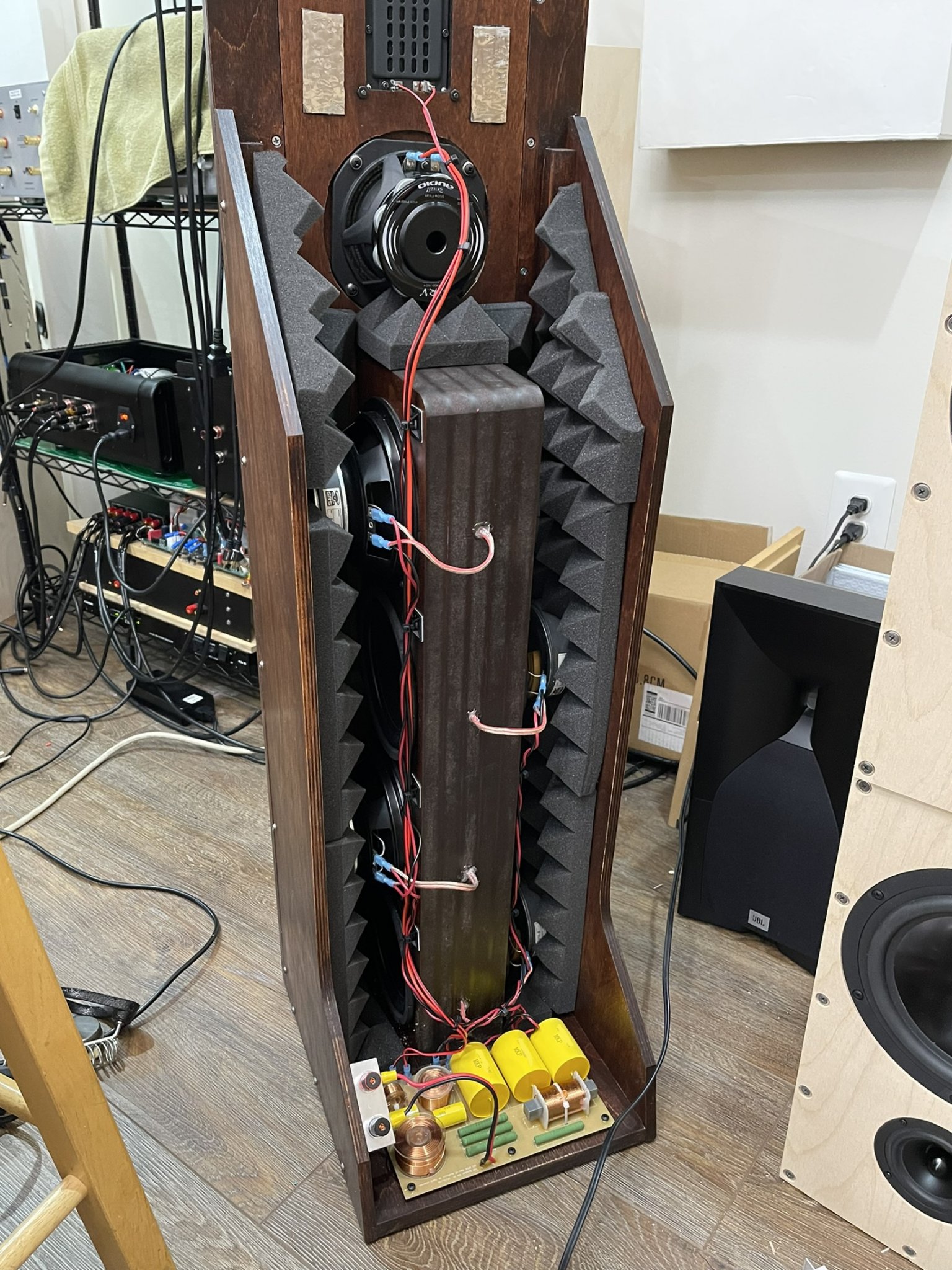

Nice project! As this will be a commercial offering, two things to consider: the visible screws on the side for the wings have DIY spelled all over them, maybe this will be covered in final production run- and having any visible spaghetti of wires on the back as seen on prototypes would probably lessen the WAF quite a bit. I would consider routing them in a recess on the backbone and cover that recess with, say, a U frame aluminium profile flush with the backbone.

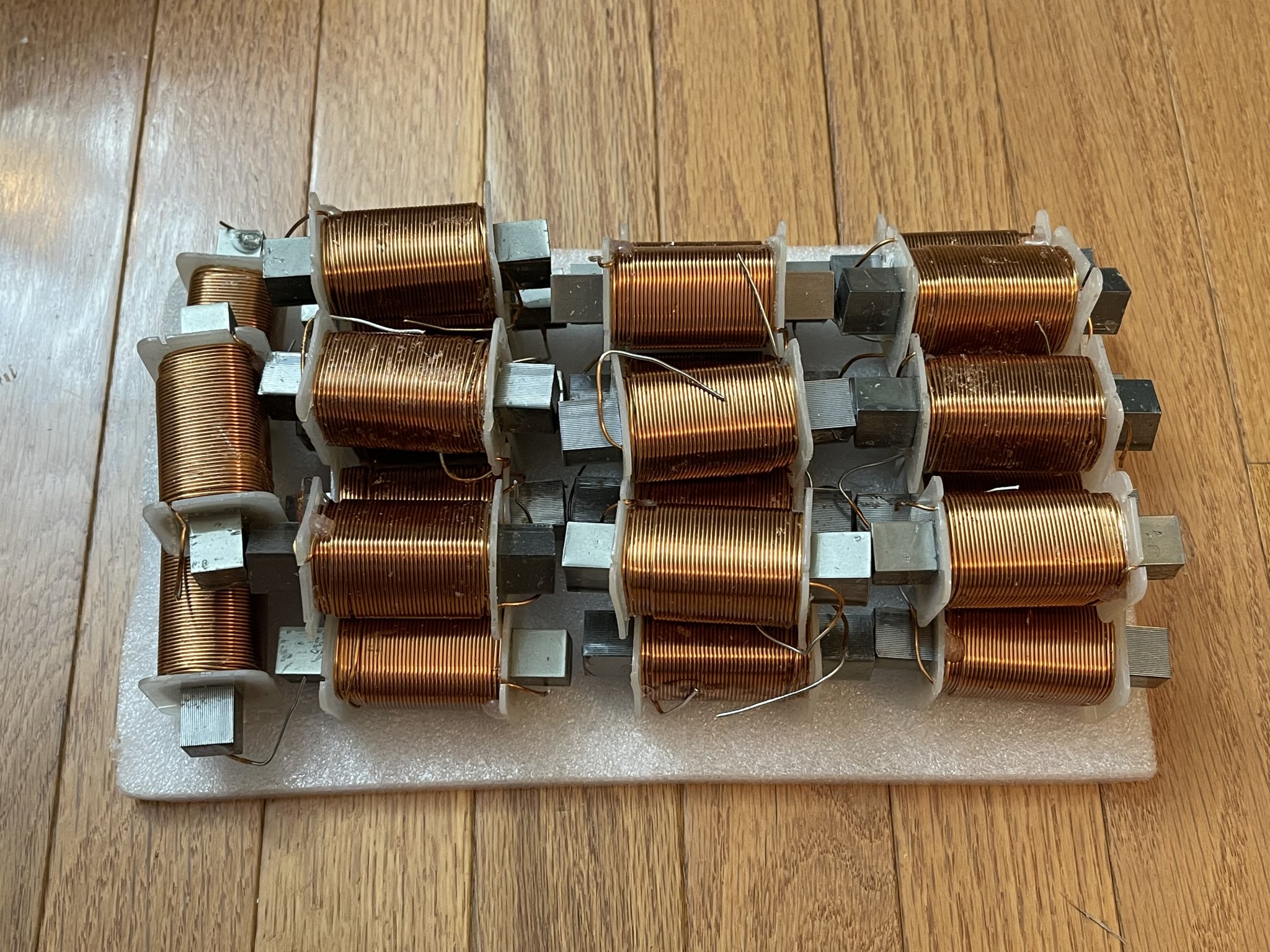

I know several people already starting on the cabinets. The iron core inductors should be here any day now and I can finally ship the XO kits out very soon. I appreciate everyone’s patience on this. It would have been another month+ if we waited for the inductors to arrive from back order on Parts Express.

XRK,The production units will be one piece front and wings, no screws. Good idea about a cover for wires. Another idea is cover the back with speaker cloth. Some zip ties and cable anchors can do wonders on the diy version.
You are showing Noico strips straddling the wiring terminals in the upper pic. Is this an additional dampening precaution that we DIYers need to take? Is it due to the
You are showing two Noico strips straddling the tweeter wiring terminals. Is this a precaution we DIYers need to take too? Is it related to your mid & tweeters mounted on a removable panel rather than on a monolithic front panel?
J. H. Clark
I added that to see if cabinet panel resonance could be reduced. This was when I was chasing some distortion in the 6FE100 that was inherent in the driver itself. When I switched to 5MR450NDY it went away. So not needed. Also if one piece baffle (no removable panel) there is less chance for resonance of the smaller panel. So no, it’s not required.
