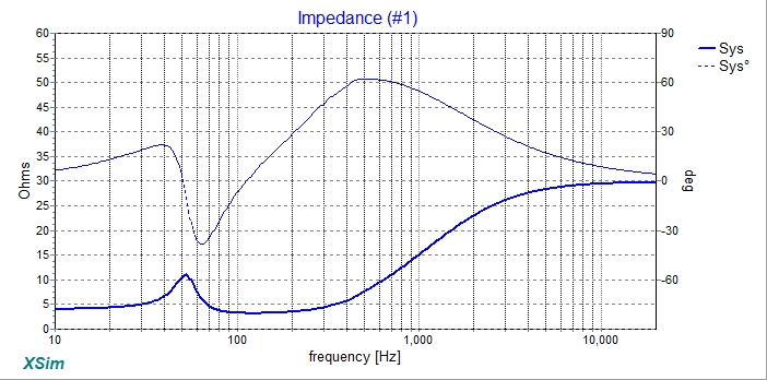

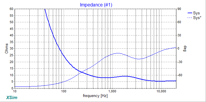

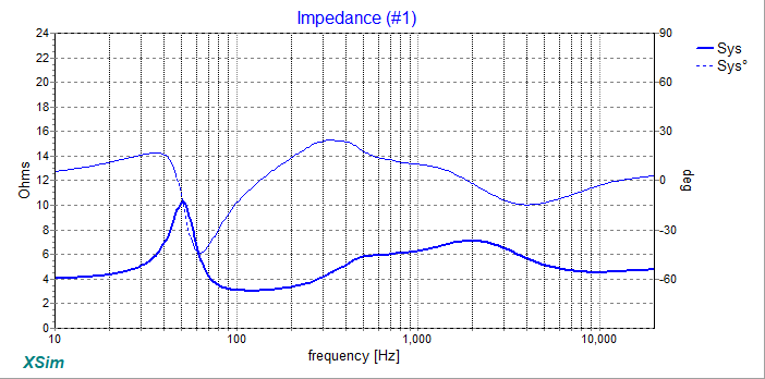

I would assume cutting the trace for positive and ground of the woofer portion of the crossover so I could bi-amp would not interfere with the rest of the crossover? What is the impedance of the woofer section alone and of the tweeter and midrange together?
I don't know about impedance's, so I'll leave that to X to answer, but the PCB has dual sided ground planes with loads of stitching via's, the traces are 6mm wide, given that I think cutting the traces for the woofer portion would be very painful.
I think you may be better off making a P2P crossover if you want to bi-amp. Cutting two-plane traces stitched with vias is not feasible. You want to know what the impedance sweep is for just the woofer section vs the mid+tweeter?
Here is simulation of Woofer XO impedance all by itself (4 ohms at low frequenceis to 30ohms at high frequencies):
Here is the Mid+Tweeter and no Woofer (very high below 100Hz and goes to 5ohms at high frequencies):
For completeness, here is the overall impedance for the 3-way XSDC as designed - the impedance is very smooth and no huge variations (4 ohms nominal with a mild trough at 3.5ohms and small peak at 10ohms otherwise very benign). Your amp will be much happier driving this than the crossover split up with bi-amping:
