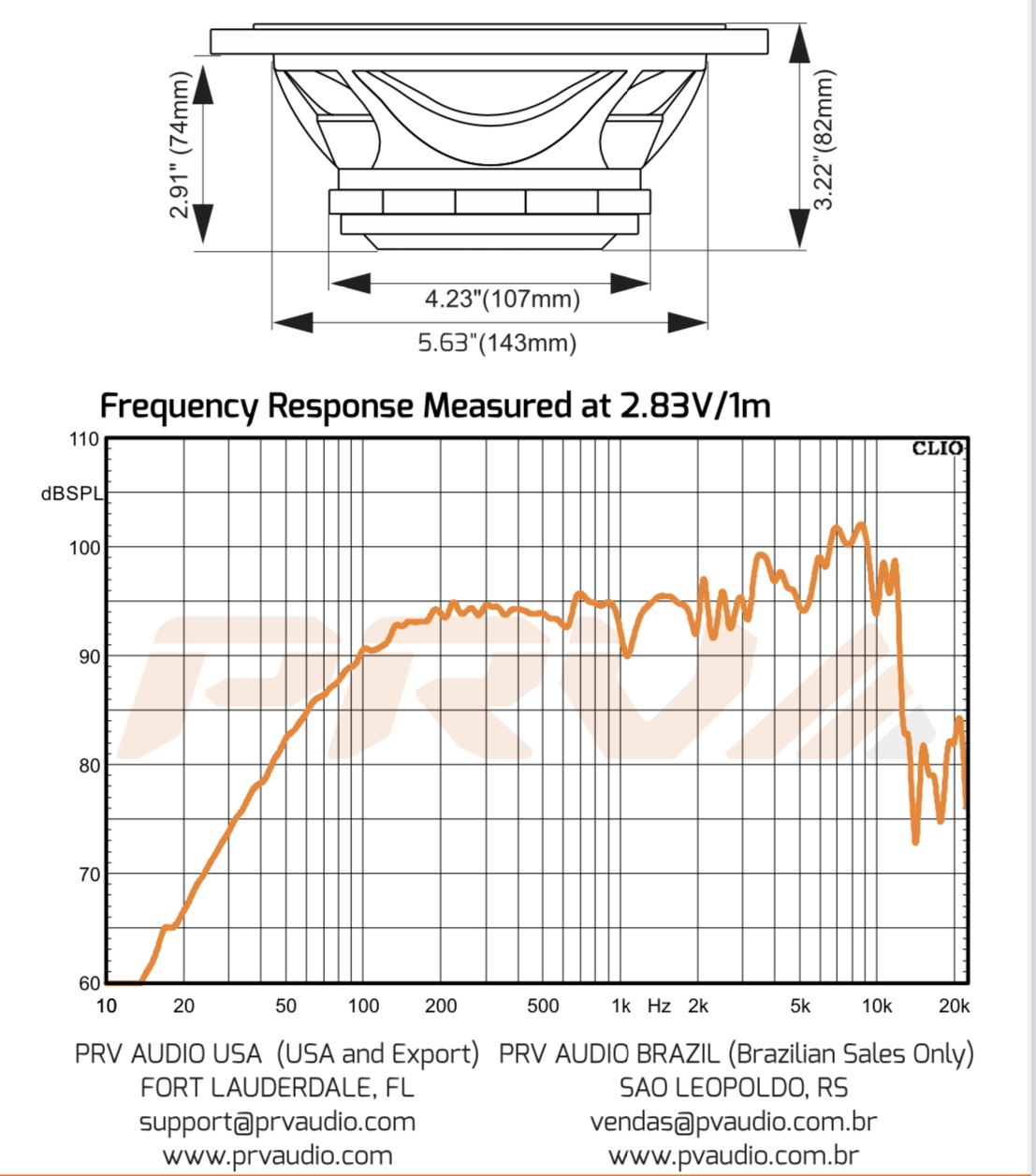

I love the design of the PRV so wonder if the 6.5 version would work out, shows in stock at PE, $134.
PRV Audio 6MR500-NDY 6-1/2​

I looked at all the published specs and overall the 6" PRV is closer is some aspects than then B&C so might be easier to adjust the crossover if needed. I need to go back and look at the mid to tweeter crossover point to be sure the 6 could work.

Did you take a look at this driver? It seems it should work quite well, just a bit bigger than the original version in the XSD.
4 or 8 ohm, in stock at PE
Thanks for the tip. Could work but response is a bit rough.
