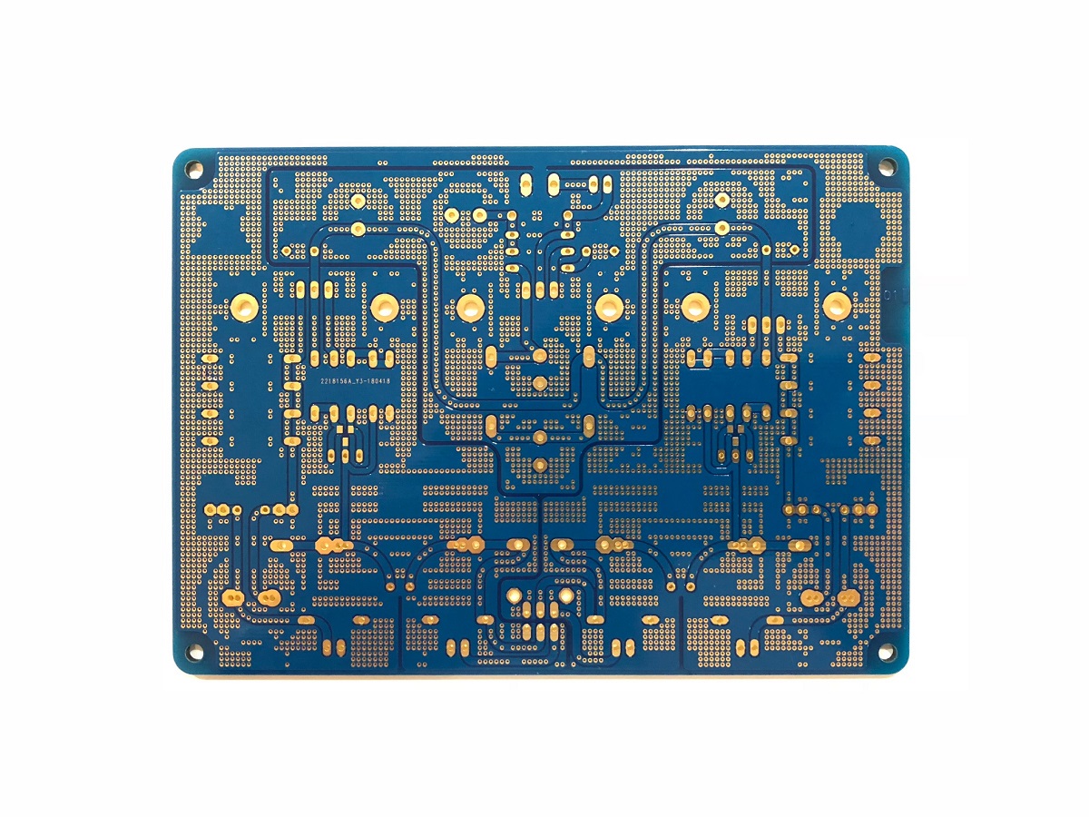

Desktop Amp PCBs are Here
I just got the nice 2mm thick, 2oz copper, gold ENIG finish with blue solder mask today. Very thick boards perforated with JPS64's signature vias for extra low impedance on high current paths and ground planes. Only one issue: the boards are lacking silk screen. We will provide a separate stuffing guide image - it should not be too hard to stuff. My mistake for not catching that the Gerber fileset was missing the silk layer before placing the order.

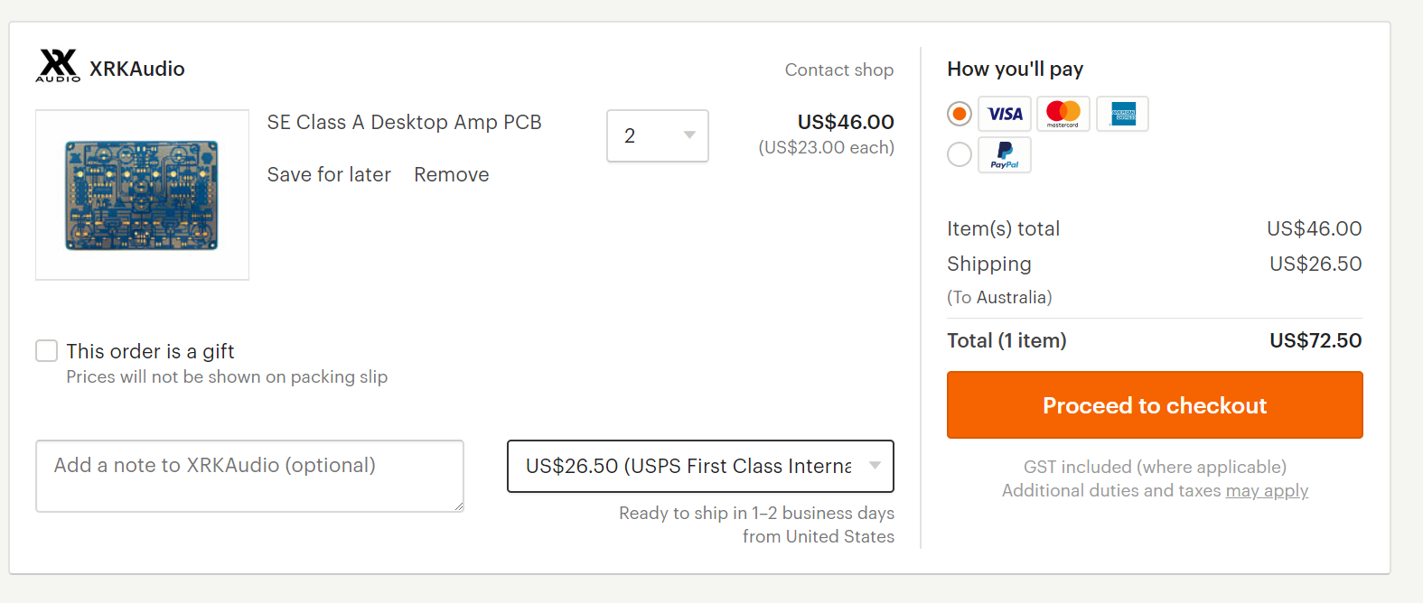

Hi X,
Are you still posting them in an envelop? The postage to Aus is fairly steep - I added 2 boards to cart and postage is $27! From memory when you sent the PCA boards postage was a lot less?

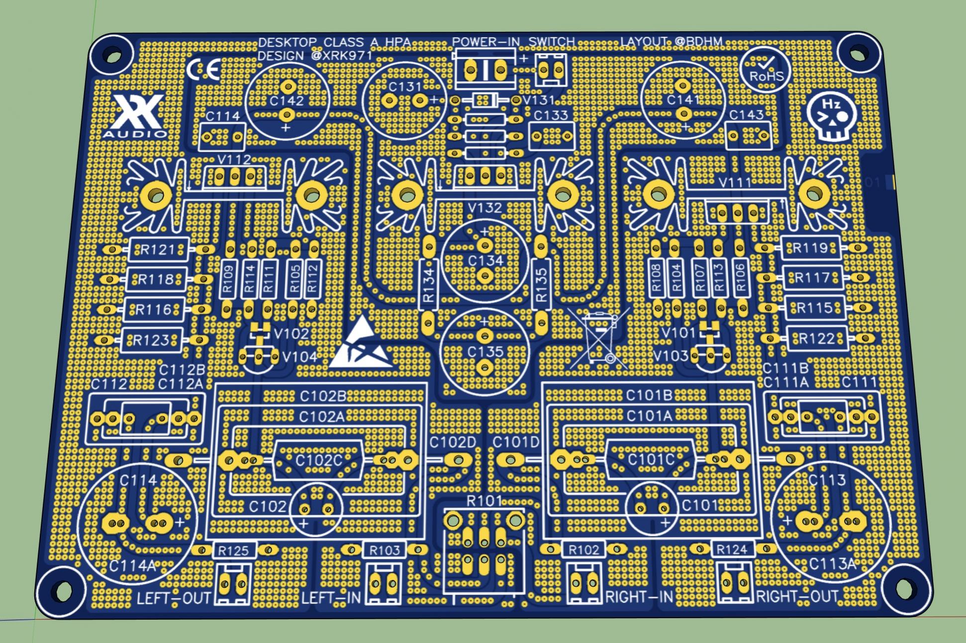

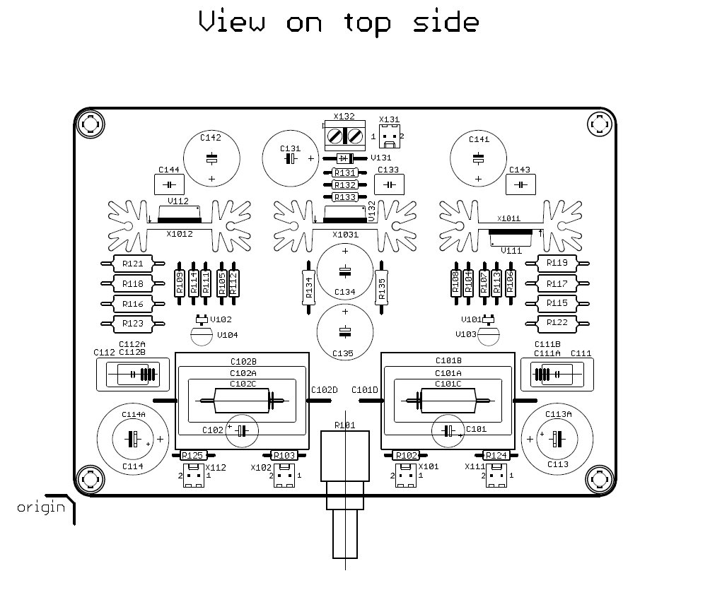

Here are the visual stuffing guides:
3D rendered version of what board should have looked like with silkscreen:

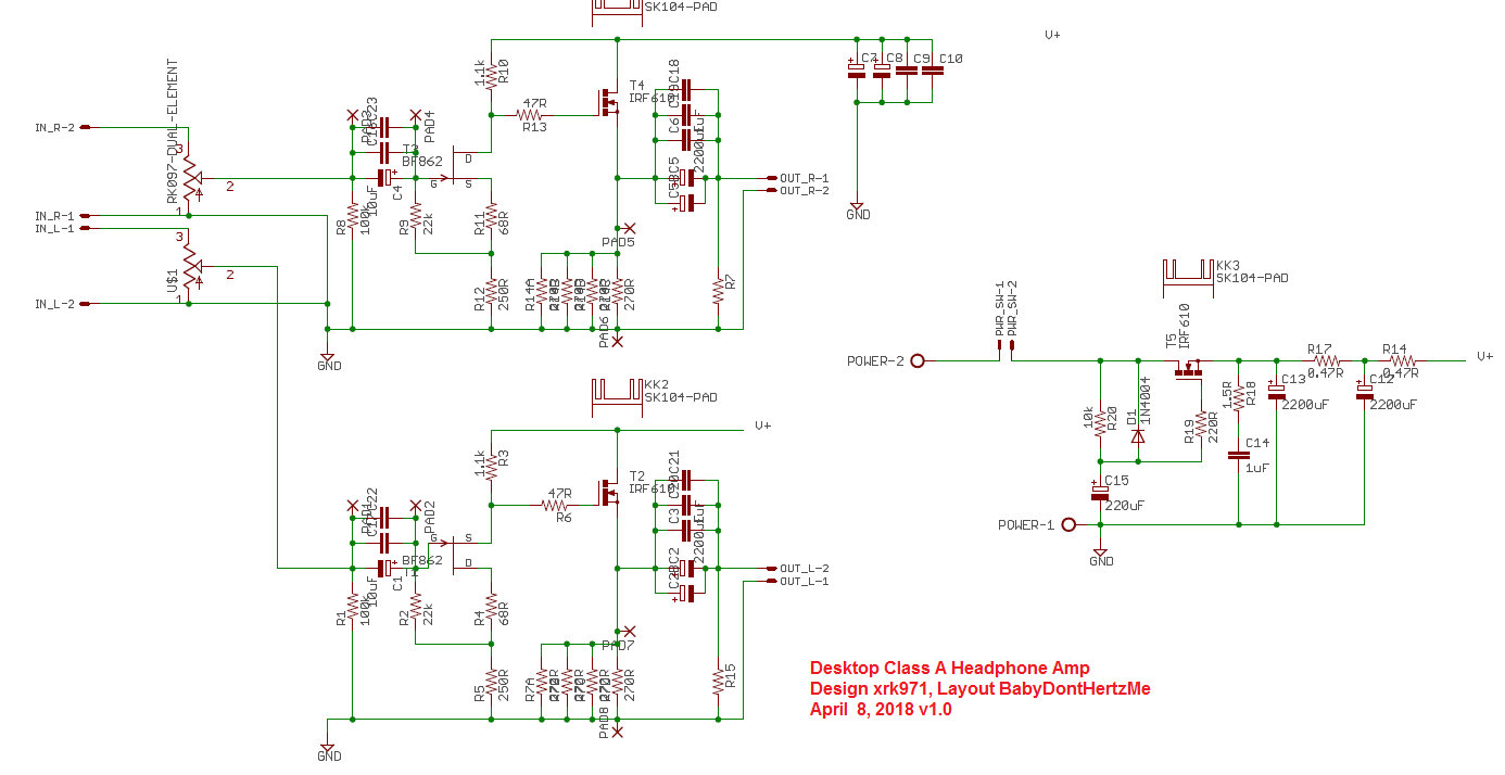

Schematic:
Click on thumbnail below.
I’m still working on the BOM. Will post it shortly, but if you look at the schematic you can get most stuff there. All resistors are 1/4w 1% metal thin film except for power resistors which should be at least 1w. All electrolytic should be minimum 25v but preferably 35v. For best sound quality the output elcos should be 35v to 50v rated. Elna Silmic II or Panasonic FR or Nichicon KA are all good.

I just ordered one of these PCBs for what will be my first DIY audio project, one of my first electronics projects altogether actually.
