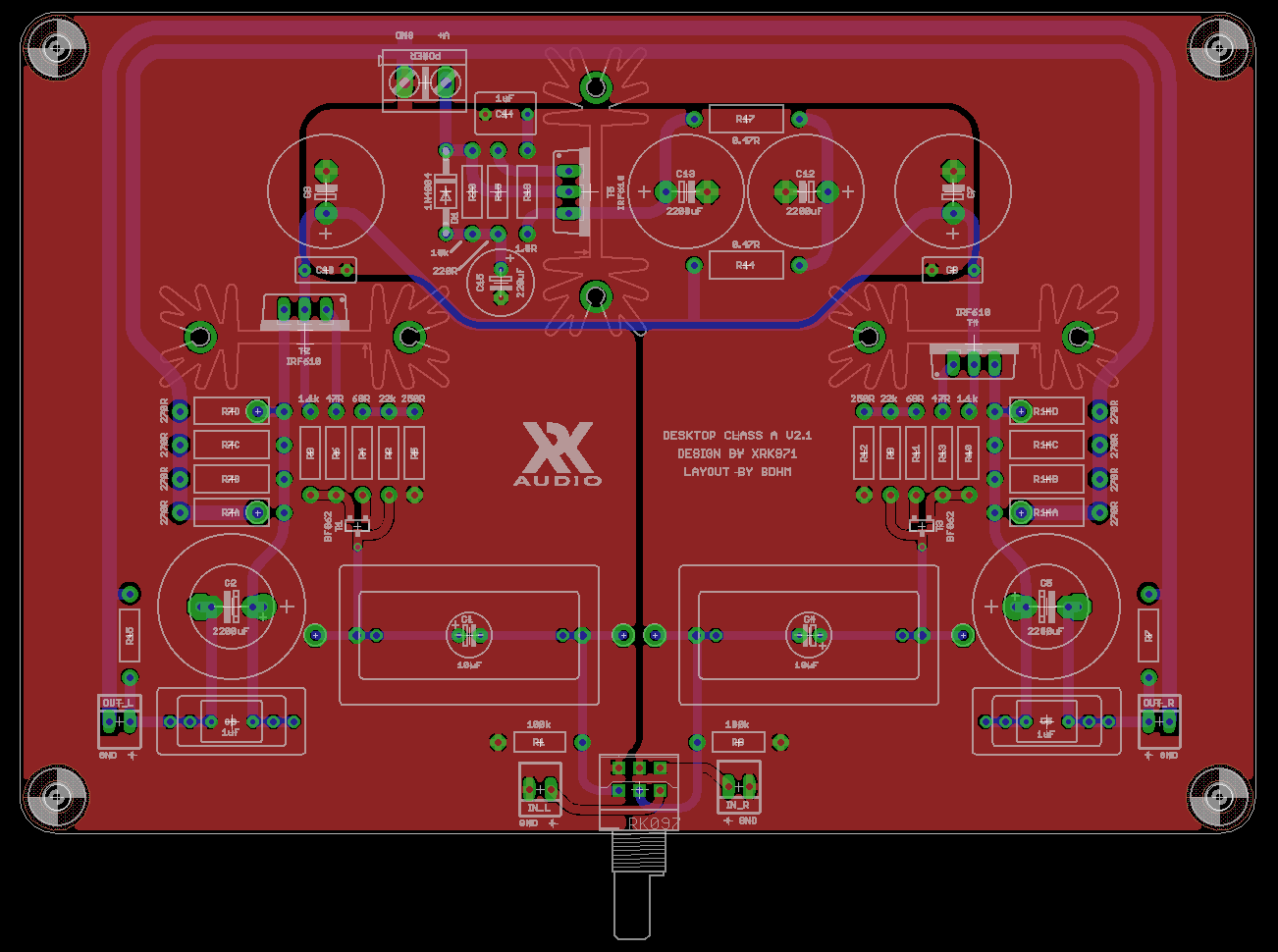

Whoops! So is everyone happy with the last layout? If so, I'll send the gerbs.
Lastest Eagle PCB view?

Post #1604 🙂. Only change was the addition of a JST header for a power switch.

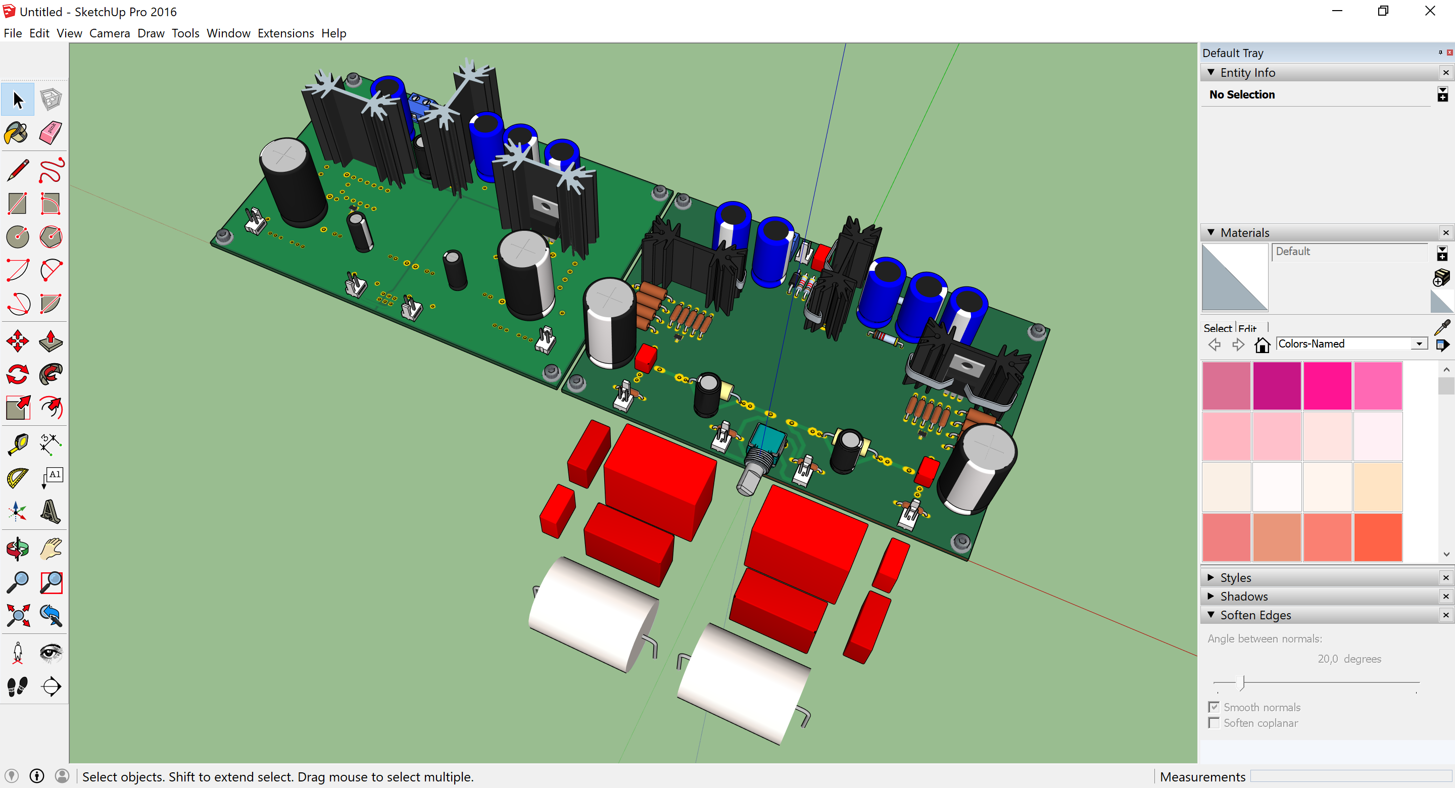

If wanted, I´ll do some cosmetic modifications and 3D model before ordering?

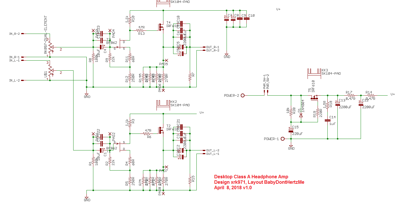

Is there BOM\schematics for power supply part of the desktop version? Having a hard time reading this image, being new to this doesnt help. 🙁
This is the schematic as of now, JPS64 will fine tune the layout some more, so the BOM may be subject to change.

RK097 symbol is wrong! I need the schematic binary also.

How odd 😱! IIRC it's the symbol and package that came with Eagle. Will send it to you.
The pocket amp used part ALPS_RK0971221Z0N from library audio-pots, the problematic one is RK097-DUAL-ELEMENT from library alps_japan_potentiometers.
Good catch, JP 🙂

Looks very nice, JP and BDHM. Thank you both. I was thinking if we should have a local smoothing cap near the Drain to each MOSFET to help de-couple rail perturbations from one channel to the other? Or make a very low impedance two--layer via plane for the main power node from the last CRCRC cap to each MOSFET Drain.
I recall from testing the PCA that when I ran it with little 47uF rail caps, the stereo separation was like -30dB, and with 2200uF caps it was -72dB, a substantial improvement. We still have room for a 4700uF 25v cap at each MOSFET don't we?
