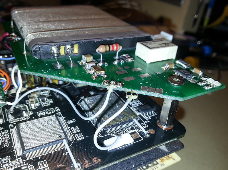

Anyhow....up and running...
My PSU is giving out slightly more than 15V on both rails, 0.6V extra. ..I'm sure the opamps can tolerate the difference.
Sounding very nice (also replaced clock signal wiring with proper bnc coax.) Stage/separation are noticeable improved and I think dynamic range too, especially down low...just overall more "there".
I need to shorten those power leads, and put a strain - relief on the Xonar side. ..

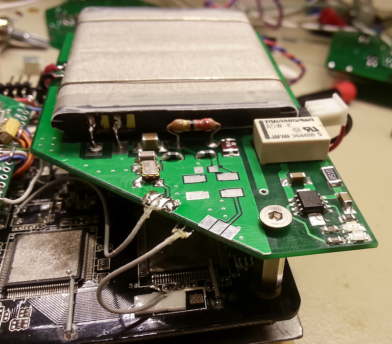

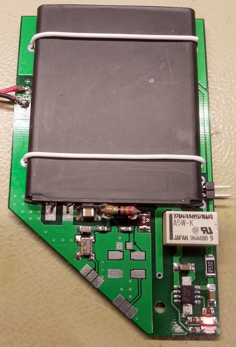

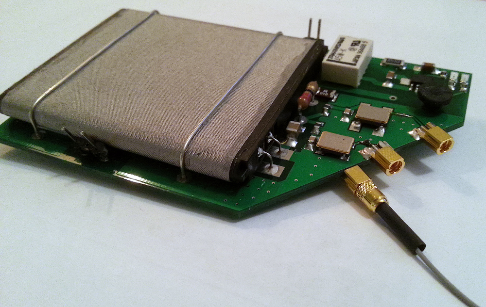

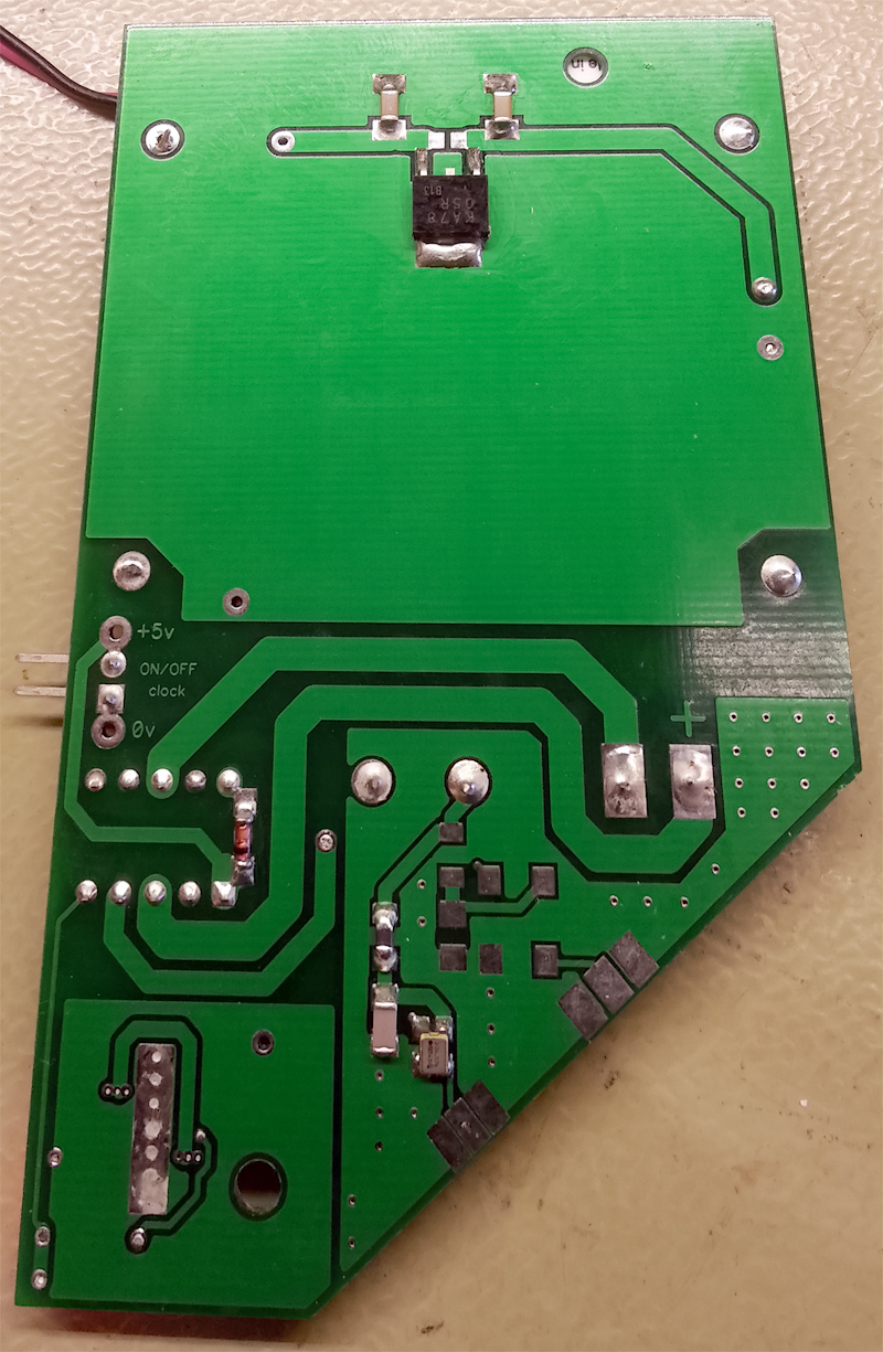

Here is the right version of my battery powered clocks PCB.
It can be populated with, and it can power up to 4 oscillators of different foot prints. This board is suitable/designed to be used on ST/STX sound cards (it fits mechanically with ST/STX). But it can be also used on what so ever system.
A new and improved design of this board is in production now. The new board it will have accessible pads from the pin 1 (Enable) of all 4 oscillators, as a simple start up delay circuit, in case it will be necessary for a more precise control of the clock signal in conjunction with the host system power up sequence.
One may note that as it is this circuit, there exist a delay for clock signal start induced by the relay itself. There is about something into 15-20ms, depending of the relay construction/specification. If this delay it may not be enough for a system power up sequence, then the Enable pin of the oscillator have to be used accordingly. The new (upcoming) board provide access to the Enable pins of the oscillators, to be connected further to the host system. Or these Enable pins it can be connected individual or all together to a simple delay circuit on board.
There is not necessary any control of the oscillators when this board is used with ST/STX sound cards, so the Enable pins are not connected/used.
The new version of Asus ST/STX sound cards use two oscillators (33Mhz, 24,576Mhz). Both these (of course better quality) oscillators can be powered by battery, using this board, and the output pins (clock) is to be inserted into the right place, through a 0,8 mm thin coax. The same when is to be used this board in another different systems (the coax length it have to be minimised).
The battery charging circuit it can be connected to a 9-12v DC, or to 5v DC rails, depending on the host system. when is to be connected to a 5v rail, the 7805 regulator on board have to be bypassed (shorting its in/out pins). A gap on the traces is provided for this task. Charging current is limited to 400mA, and monitored by a specialized chip. A protection by a resettable fuse is provided in the circuit.
