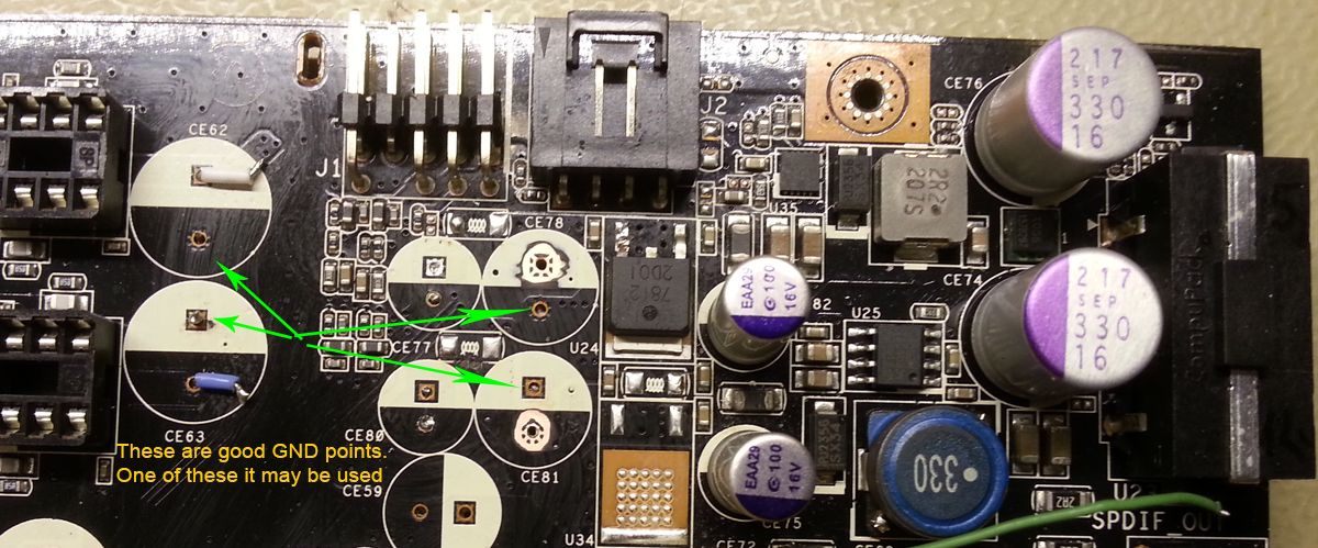

Im just about finished building my regulator/PSU...just waiting on transformer.
I plan on inserting power from the back of the STX into the filtering caps (not sure if Im going to remove them or not yet). V+ and V- both have a ground on the STX...my regulator shares the same ground for both + and -. Do I want to run 2 ground wires to the STX from the regulator, each twisted with their own V wire to reject EMI...?
Or a single ground, and bridge the two ground pins on the filtering caps?
It looks like in the pic, you scraped away some of the silk screening at the cap positions to get more solderable area...?
Hi Wungun
There is all right with one GND connection from your PSU to the board, if your PSU it have common ground. Ideally the power regulator`s GND should not be common on the PSU board, but meet together on the sound card. But is OK in your case. The connection it may be just short as possible, and it should be better to have few wires for this connection... I mean few reasonable thin wires (soldered in the same GND point) is better than only one thick wire.
You can see in my previous pictures a good place for GND connection on the sound card.
I think Ill remove those 2 filtering caps and solder there, on the top of the card....
Trying to follow what you mean...I have seprate grounds from trans to the input of the regulator, and a common ground out...
Should the single ground from my regulator out "split" to be soldered to the 2 negative poles of the two caps...bridged? I think you mean its better to run 2 ground wires...? I dont see in your pics where you have your ground. I assume its to both capacitors, CE78 and CE81? I think both grounds on the STX are common/series mounted caps, so connecting to one point is okay...

You should connect the GND (from the output side of your PSU) to the sound card. Best using few isolated wires in parallel, soldered in the same GND points on both ends (PSU - sound card).

There is not so necessary to remove these caps if you plan to use another bigger one in parallel. More important is to remove the right components to isolate the computer/board power system from the one you will add. None that the caps in case are quite difficult to be desoldered, without good tools, and skills.
Of course you can solder the wires on the back of the card, where is indicated on picture. Please pay attention to the C62/63. There is in the picture two small pins (blue and white) which represent the connection points for -V and +V respectively (white - V+). The common ground of the caps is a good GND connection for the new PSU.

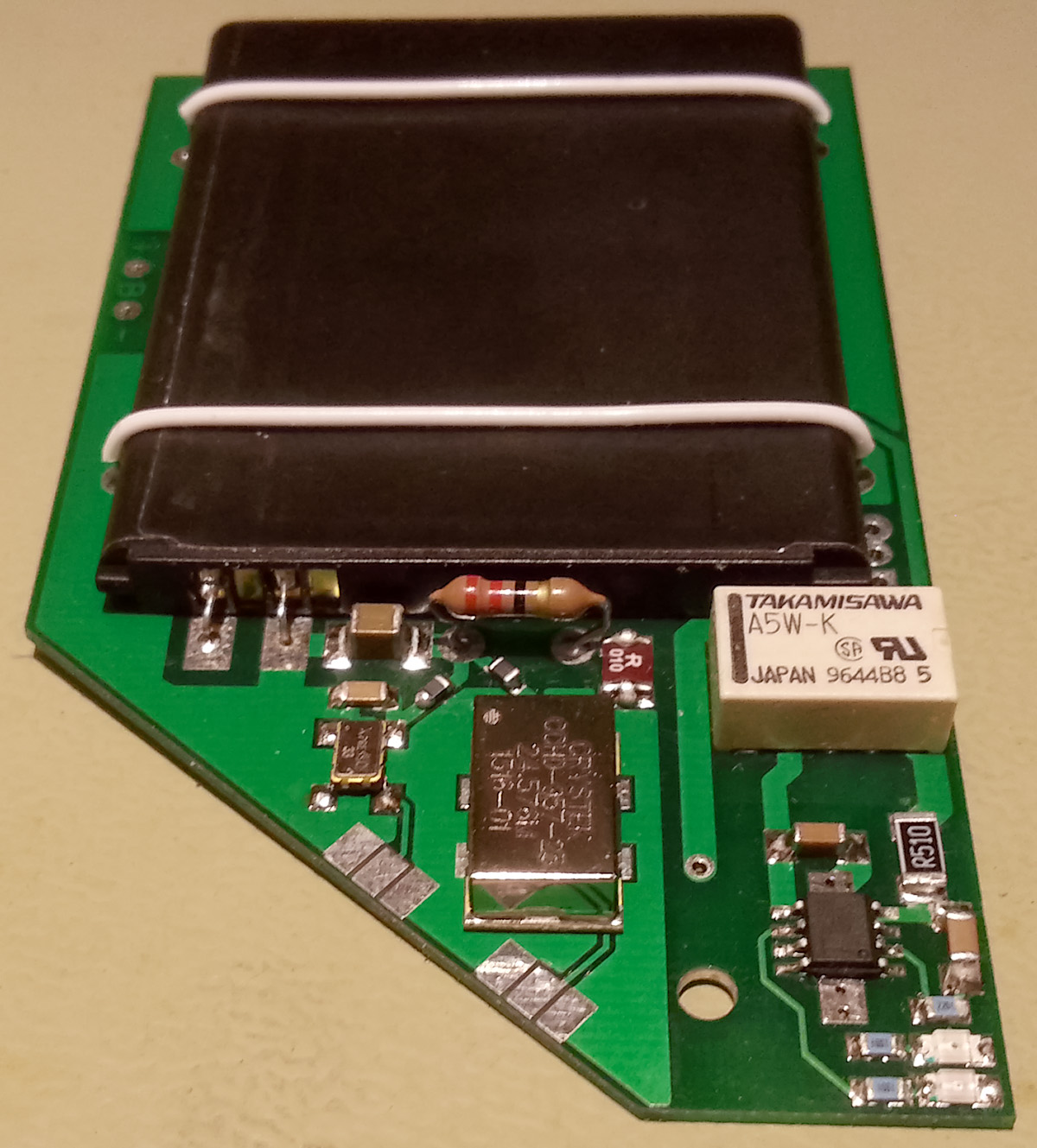

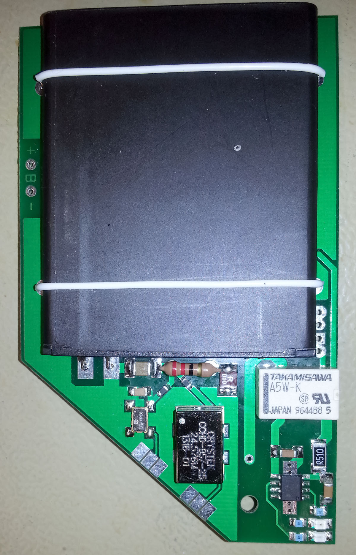

I have some pictures of the battery powered clock(s) mod for STX/ST (or for what so ever application). Unfortunately this assembly is not in its final edition, because I discovered some design faults. But the pictures are good to give an idea about.
As the new PCBs will be in place, this mod it may be available for interested ones.
There is place for four (different sized) oscillators on the board, but any kind of oscillator it can be adapted to the existing footprints. Of course this assembly it can be used to clock what so ever. One may only solder the right oscillators in place. The connections between board (oscillators output) it will be made by coax (which it will come together in the kit). The battery is powerful enough to furnish power to the clocks for more than 24 continuous hours. When the device is off, the battery is charged (monitored by specialized chip on board). The charger GND and the device GND are not common on the board. Once the device is on, the board disconnect completely the charger`s GND/Vcc.

In fact this (battery) PCB it have a design fail (that because is not pictured the backside... But is usable actually, as this one assembled.
The right PCB is in production now...

Is it a lithium ion battery?
The copper pour on the top also could do with some stitching vias down to the GND pour on the bottom, I presume there is one?
Yes, there is a 2,3Ah mobile phone battery.
Your presumption is right. But the backside GND plane is not connected with the upper one, and is used as heat sink for the charger system (different GND...).
When the right PCB will be ready, you may see the picture of the backside too...

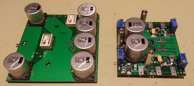

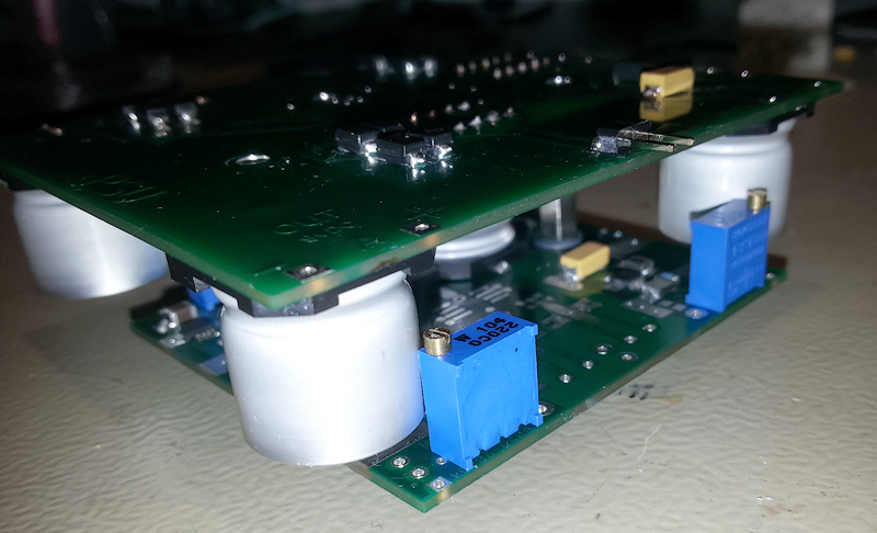

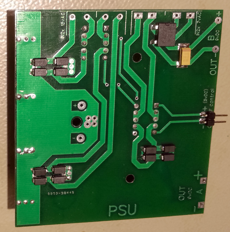

The assembling is going on...
The PSU is already finished. I`m working now on the post DAC processing module, which is partially assembled too.

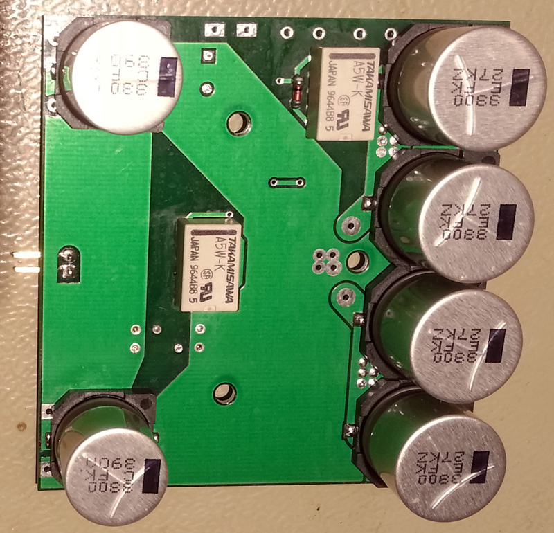

There are here some pictures, to give you an idea about the system...
