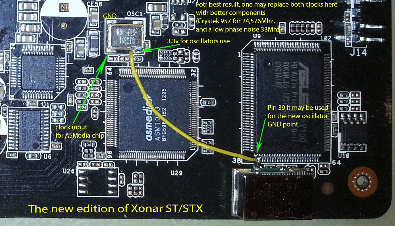

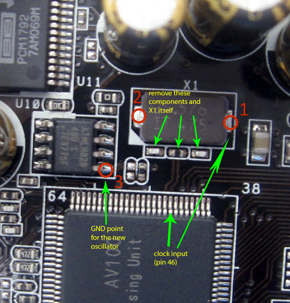

hi coris...
gonna hook up my reference clock today. Could you translate this pic for me please...?
http://www.nexthardware.com/forum/a...-stx-parte-seconda-lupgrade-estremo-fig.2.jpg
im assumimg once the old crystal is desoldered, 1 is clock signal, 3 is signal ground?
my reference clock has its own power regulator and smoothing...is there a pin on the STX that will allow direct feed of the signal, bypassing the onboard smoothing/resistors on the STX? was not able to find the info on this post :(

Hi Wungun
You have here the pics with these mods (old and new ST/STX).
I assume your clock circuit it may need 5v power. If so, you may use the output pin of the on-board 7805 regulator. If your clock is to be powered from 3,3v, then you may use 3,3v rail on card. I think you will find a picture where that rail is shown, in my earlier posts.
The 3,3v point shown in this picture here (new Xonar edition) it may be used only for standard oscillators, as this rail come from a dedicated regulator (not so powerful).
Very (extremely) short connections is a must in the oscillators case... Using quite big components, or circuits on own PCB (like a "reference clock") it may not be very fortunate, because it may require long connection wires ... If so, one may use some sort of coaxial to transport the clock frequency to the desired point (but I will not recommend such assembly).
