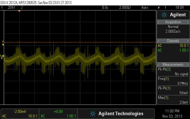

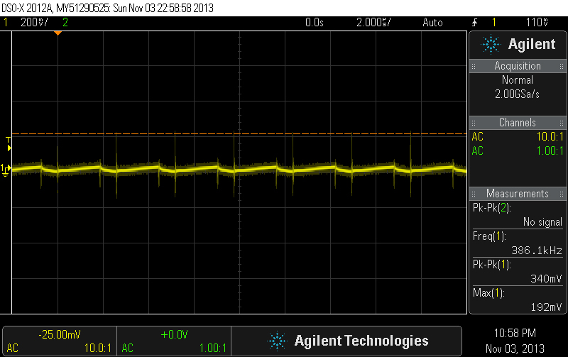

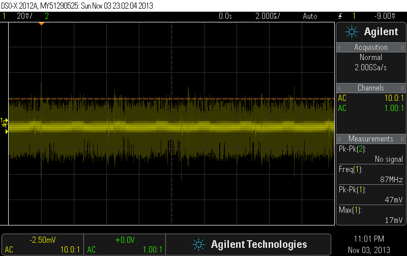

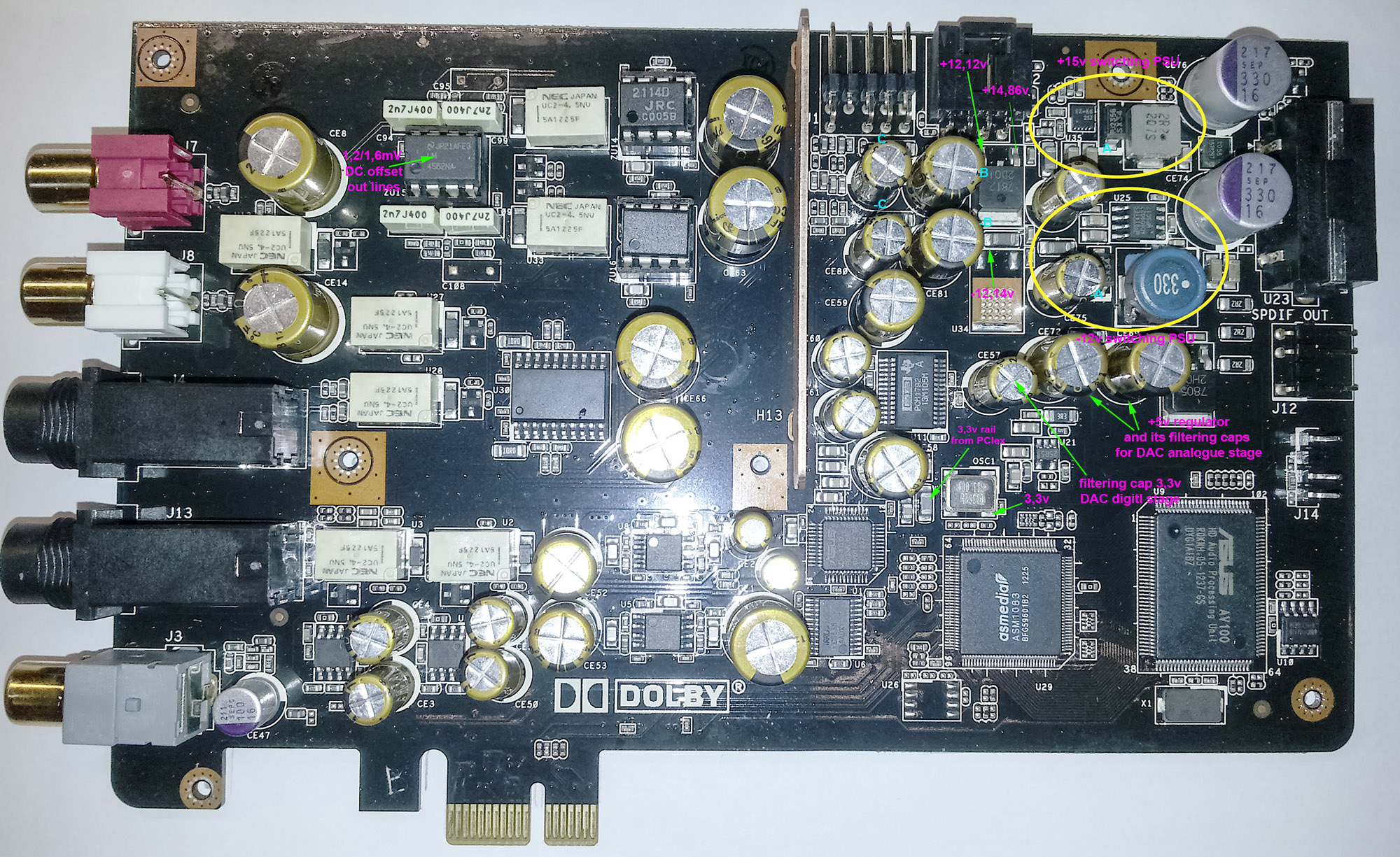

Here is the last edition of STX board (ASM), rev 1.00, with some measurements points and some descriptions of circuits.
I took snap shots of the switching PSUs on board for the analogue stage. The signals looks similar for +/- 12v rails. A/-A is right on the output diode of the PSUs. B/-B is after first ferrite bead on the filtering cell. C/-C is after last ferrite bead, last filtering cap (quite difficult to be seen on this picture).
The positive PSU deliver a tension level of 15v, and then is regulated by 7812 regulator. The negative tension is -12v right out of the PSU. No regulation here. The designed 7912 regulator is not populated. Positive/negative rails are rigorous equal. I do not know if this is just by chance on this board, or it is like this for all the production... Anyway it is a improvement comparing with the old edition STX boards.

The measurements are made on untouched (original) PSUs on board. A/B/C are measurements points for positive rail, -A/-B/-C are for negative rail.
The card is powered through Molex connector for 5v/12v, and from PCIex for 3,3v.
I can not say for sure which of the Molex tensions are used for the +/- PSUs. This is not so important anyway. The 5v for DAC analogue stage is regulated from 12v Molex rail. The +/- 12v rails on board are also used for ADC stage of the card.
It looks to me that the 3,3v for ASM chip oscillator is taken from a own regulator (u21), and not directly from the 3,3v computer rail... In my opinion the oscillators on board it should be powered from a dedicated battery for better noise performances.

Looks as if my 1.02 also had a switching PSU on board as well.
If one was to inject -12V regulated at u34 (?), the unregulated -12V first has to be removed from the design...do you see a way of doing this?
I think if you remove the molex power and add external 12V to the 7812, then the -12V would also get power...?
