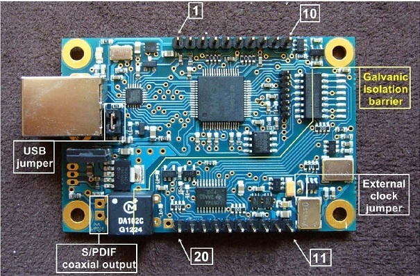

Hi all
I have USB to I2S working with Najda DSP (have bad connection)
But now I have to connect SPDIF output to my DAC with SPDIF input...
could someone point me out (on the picture) which of SPDIF outputs are + and which is GND ?
thanks

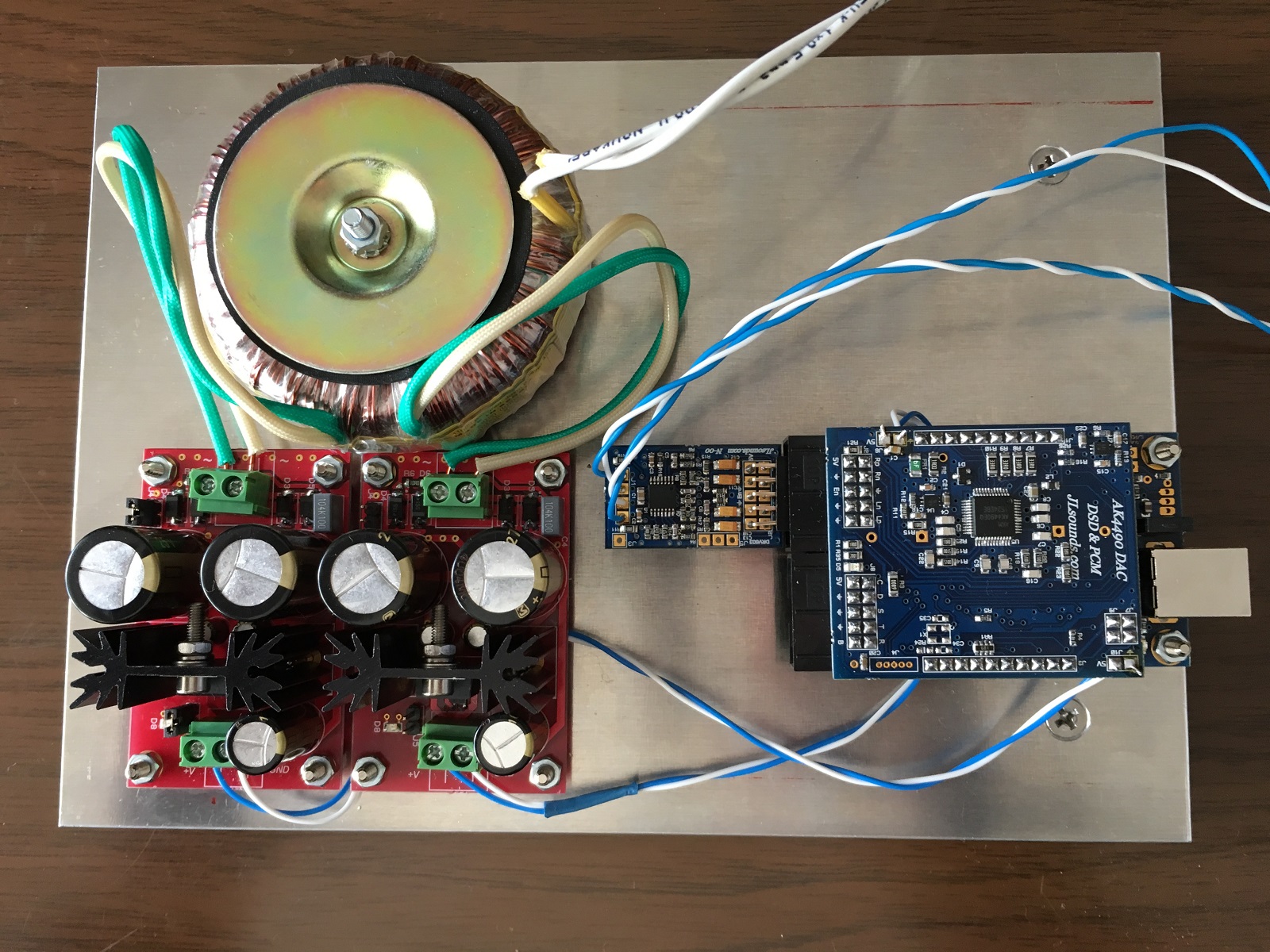

Last few days testing http://jlsounds.com/drv.html..
Sound is surprisingly good..

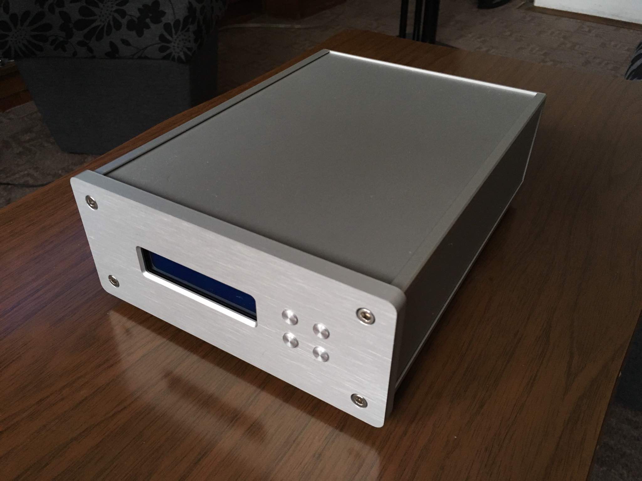

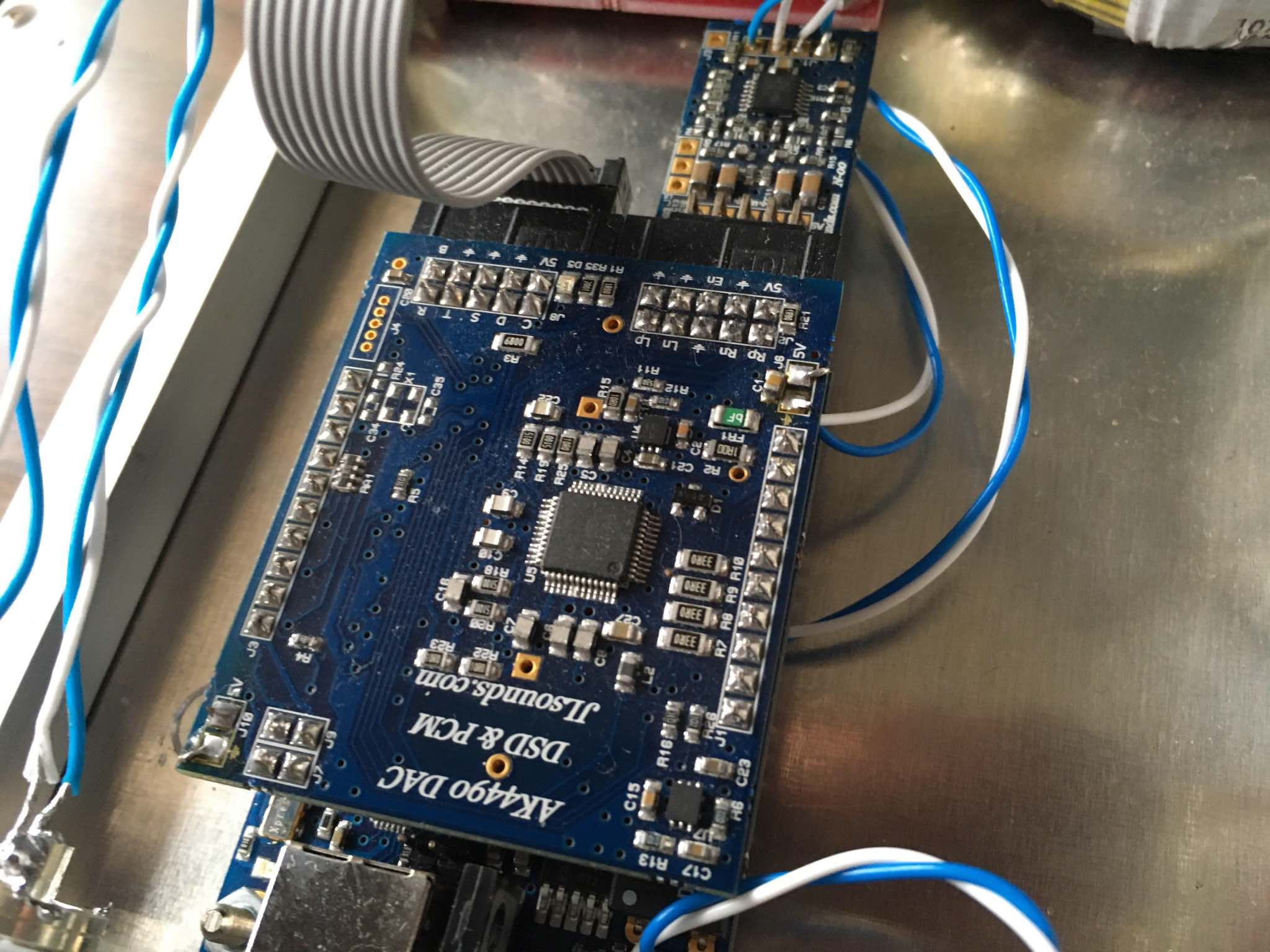

I made few changes in the meantime.. first I unsloder 10uF tantalum, DRV603 can work without input capacitor with 5V PSU, but mute function doesn't work perfectly as with one.. after that I use 4,7uF multilayer ceramic, in theory better than tantalum, but practically hardly hear the difference.. in the end, instead of active 2nd order filter I made passive 1st order.. that is very easy on this board, just unsolder 6k2 and 150p replace with 8k2..

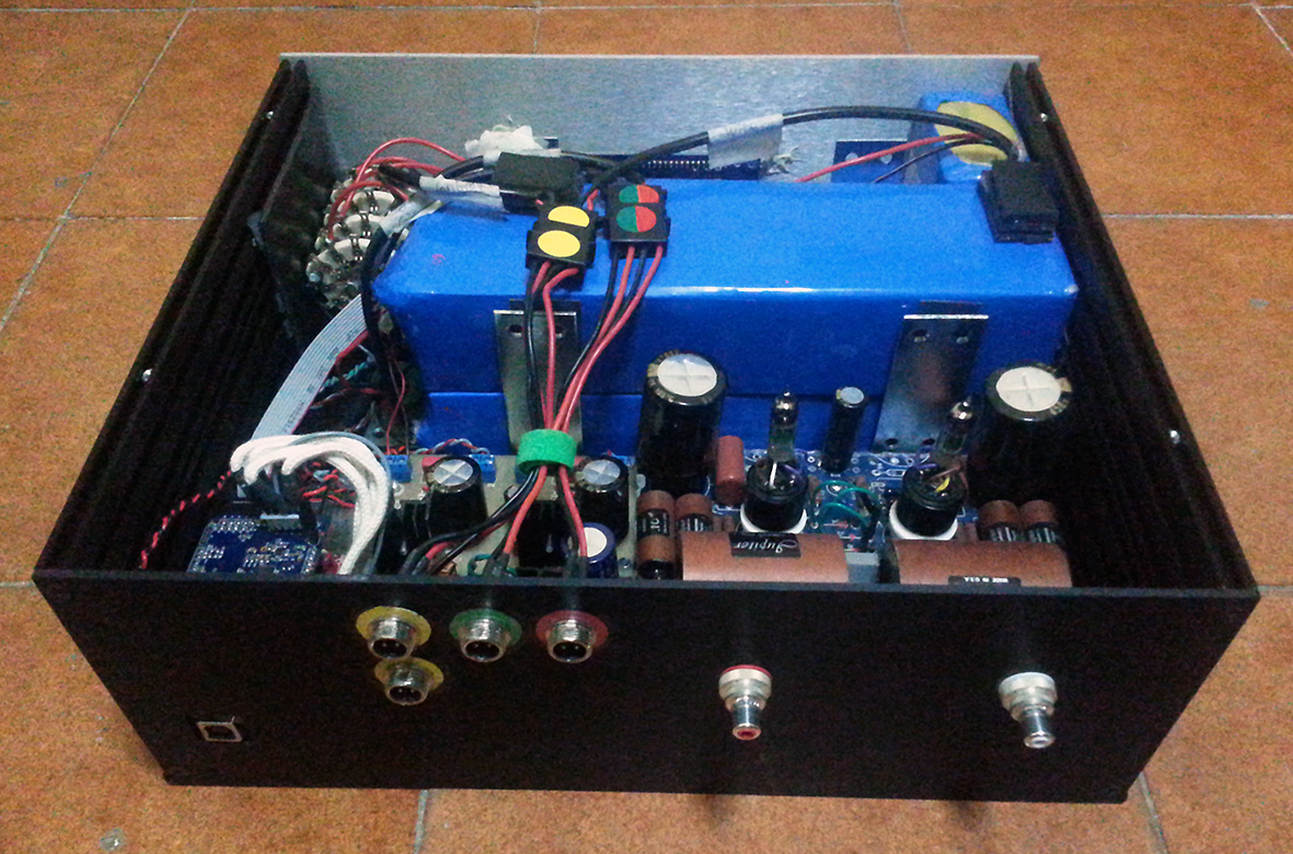

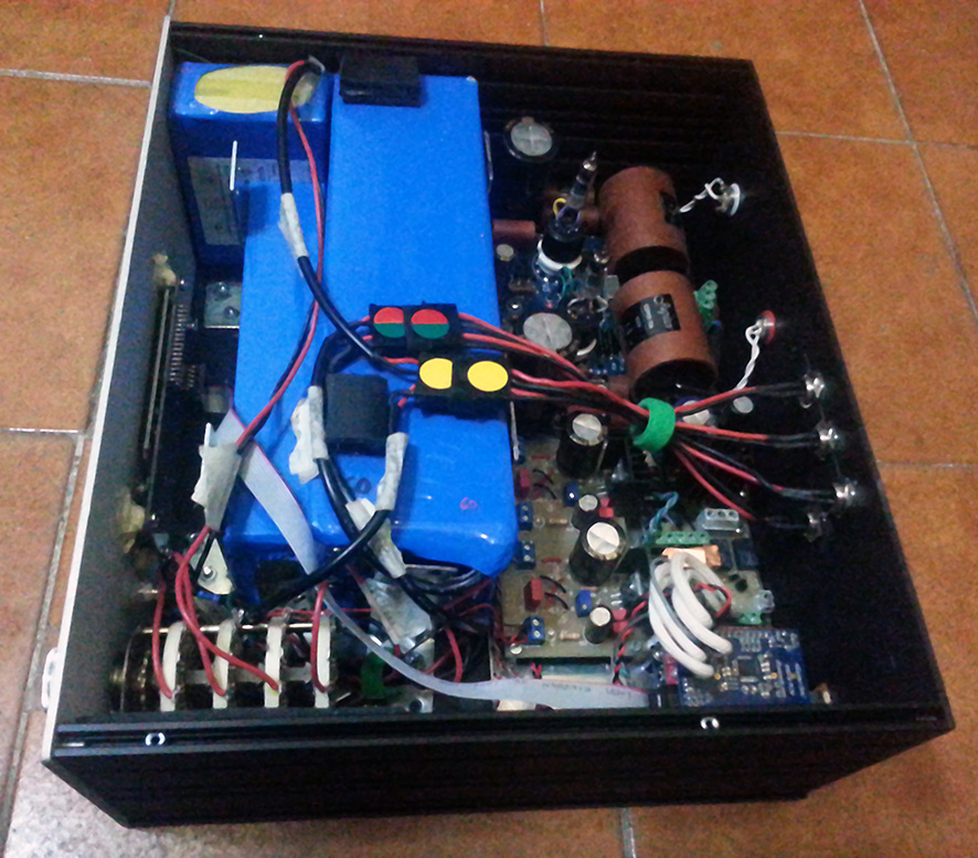

This is my battery powered, tube output AK4490 DAC 🙂

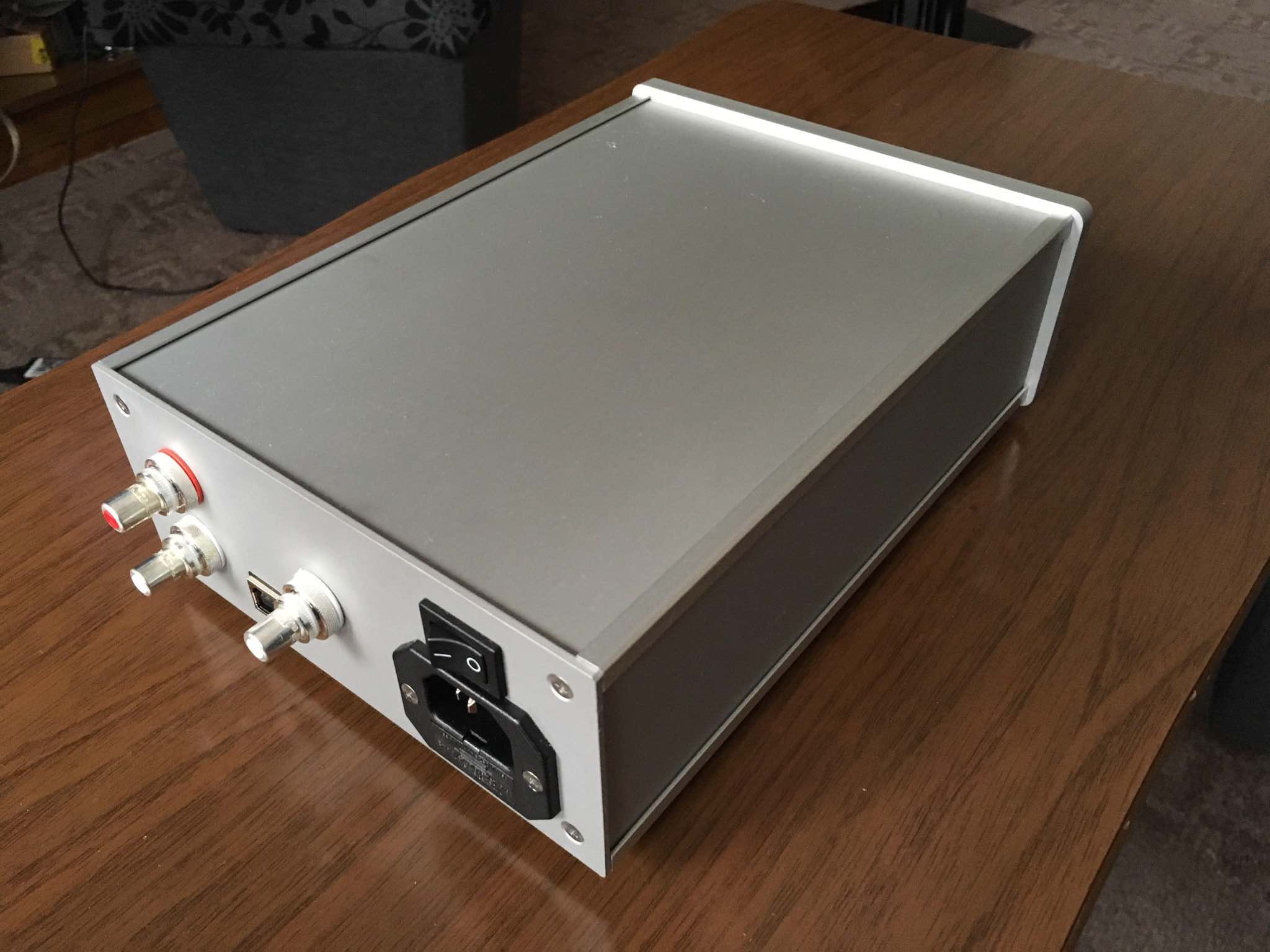

One of my friends has an identical DAC (i made it for him) - same configuration, same output stage - but with "normal" linear power supplies (very good ones, using Belleson regs and Mundorf filter caps).
Both DACs are a big level above any opamps-output-stage AK4490 i ever listened too. But this battery DAC SQ is the best... very, very very black background and holographic image! :cheers:
Schematic?
No need for schematics, components are:
- Jlsounds i2soverusb and ak4490 dac,
- Broskie Cathode Follower as output stage using 7963 tubes @ 60Vdc,
- a simple low pass filter 2,2kohm + 2,2nF each output line (on prototyping board) between ak4490 and BCF,
- a simple antibump circuit copied from Jlsounds opamps output stage, in the same prototyping board.

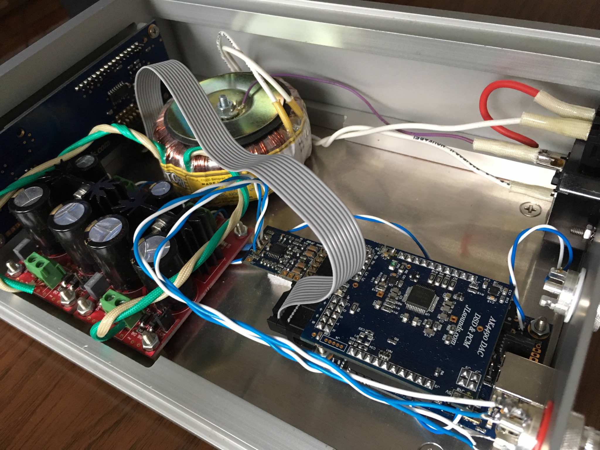

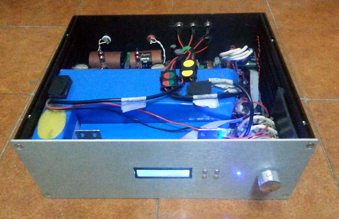

It uses 4 batteries:
- a 60V one for anodes,
- a 14,8V one for filaments in series( 6,3V + 6,3V) regulated by a small diy lm1085 linear step down board to 12,6V,
- 2 x 7,4V batteries for ak4490 and i2soverusb, regulated by a lt3080 each on a modified (for DC) double linear ps board to 4,8V and 5,2V.
All batteries include a BMS and has both a charging wire and a discharging wire.
The charging wires go to colour coded chassis' chargers connectors; the discharging wires are switched by a heavy duty rotary selector that can stand 60Vdc switching.
Play time with fully charged batteries is about 10/15 hrs.
That's all, it's a quite simple diy project...
