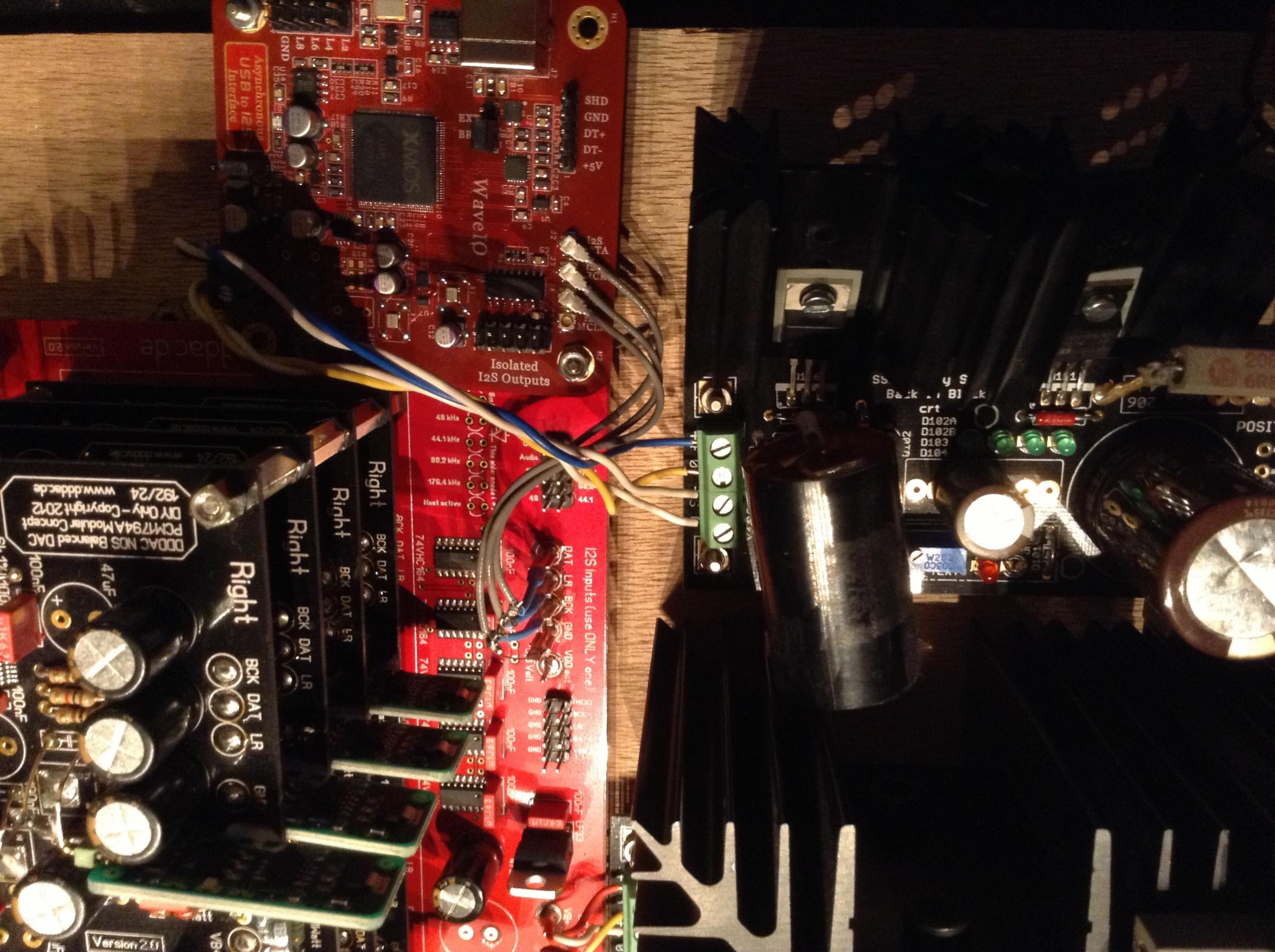

I am trying out the UFL connections from wave IO to dddac but this is unsuccesfull now. I have connected data, BCK, LR and GND of the dac to the UFL connectors of wave IO.
Sound is distorted, mostly noise with the music on back ground.
Am I doing something wrong?
Well, first thing first: make sure that all your U.FL. cables are as short as possible! I have here 5cm coax cables which seems to be working okay for my needs. Secondly, it's mandatory for all of them to have exactly the same length! Third, as Doede said above, driving multiple loads with the same I2S pins seems to be difficult, if not impossible. Please take into account the fact that this I2S port wasn't meant to be used to drive multiple loads in the same time... but only one DAC, maybe two. In addition, there are isolator's input pins which will always be an additional load to XMOS processor, regardless if isolated I2S output port will be used or not. All in all, seems that it's something related to XMOS I/O pin's architecture to which these I2S lines are directly connected to.
And, not in the last place, the ground connection is very important here - a thing which I personally dislike! Anyway, I suggest you to keep the GND wires as short and wide/thick as possible... and try to minimize GND loops.

Data, LR, and Bck should work. Don't forget to connect ground to H4......and put 3.5 to 5Volts on pin 5 of the bigger connector, next to the Ufl's. This is what the isolator needs to get working!

Thank you Ed for your help still i want to add that U.FL. port doesn't need for the isolator chip to be powered.

Hi Lucian,
Thank you for your reply.
I use 100mm UFL canles with the connector cut off on Dac side. Length is now 90mm and are all same length within 2mm tolerance. The ground is connected on dac side to the shielding of the UFL cables.
See attached picture of the test setup.
Do you think this should work?
I would like to compare this connection to the isolated one.
Though the direct connection can bring noise from ground to the dac, on the other hand the isolator can also introduce jitter.
It would be nice to compare both to see which is best.

Connections seems to be okay still I was afraid you will use 100mm coax cables 😱 I know because 50mm are often too short for a DIYer to feel comfortable with. Anyway, let's do some 'stupid' choices and please do try to connect those shields from coax cables on both your DDDAC and WaveIO as well (if you didn't do it by now). Even if I fully agree to keep the shields connected at one side of the cable and left it "float" at the other end, it might be possible for it to not function properly in your setup thus I would agree with the idea to build as many ground interconnects as possible, despite the fact it will create gnd loops.
So, this is what I would do:
1. please do keep the coax cables at a reasonable distance one from another. Do not keep them together as are now because if the shields are not working properly then there are high chances of crosstalk between the I2S wires.
2. if this is not working then add gnd connections on both sides of the coax connections. From what I can see, the WaveIO's side is okay because the shields are wired to WaveIO GND by means of the U.FL. connectors. You have to work on the DDDAC side now.
3. Please do try to use only one rack from your DDDAC. From Doede's schematic I can see that the L/R and bit clock are heavily loaded so I'm pretty sure that XMOS is not capable to handle so many loads on those lines... hence my suggestion for testing purpose, to make its life 'easier' by disconnect other racks and leave only one.
The other paths would require a buffer but this will complicate things...
Hi Lucian,
Disconnecting three dac boards will impair sound quality and therefore going that route is not prefeable.
The ground is connected from both sides to the ufl cables so I expect that will be ok.
I find your remark regarding cross talk between the cables a bit strange: these cables are intended for use in enviroments with air pollution like mobile phones and also if you look at the connector used for the isolated output, that uses a completely unshielded cable. I also have experience with using like 30cm length of I2S cables between a philips CD pro loader and a dac with good results.
But maybe you are right that the xmos is just not stong enough to drive the load. That will also make it possebly more prone to distortion from radiation. Is there a simple way to amplify the signal?
