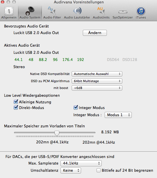

Hi together,
after update to "MAV" ... no more 384 🙁
