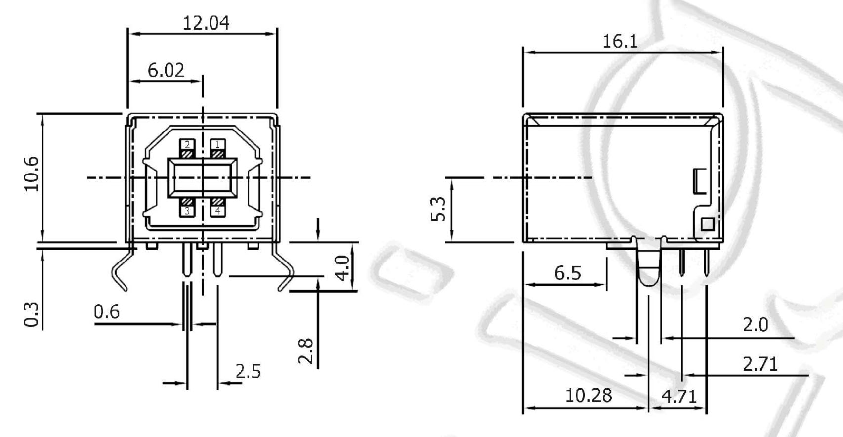

Hi Walter here you will find what you are searching for. As for height, the PCB has ~1.6mm thickness while USB connector is 10.6 mm - for panel mounting (please see below) so the whole result would be 12.5 mm.
Kind regards,
L
