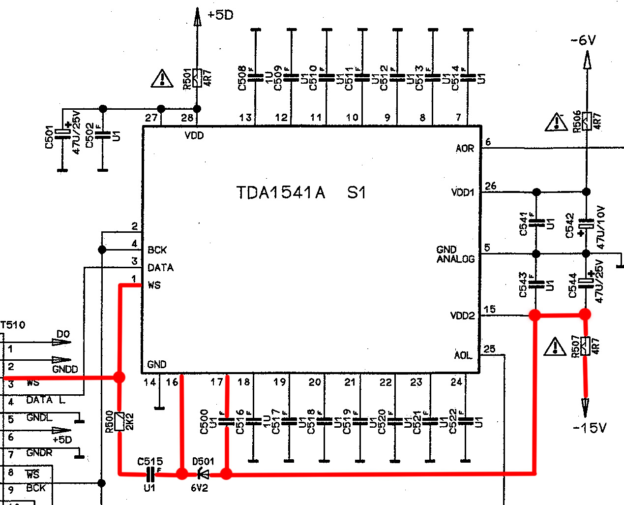

WaveIO and the TDA1541a
For 1541a enthusiasts, the WaveIO has a bonus feature. WaveIO's J9 Header offers up a variety of clock signals. I used the L5 pin as a source of 176.4Khz for DEM reclocking of the DAC chip. This clean clock signal at 4x44.1 is perfect for DEM reclocking a non oversampled 1541a DAC. Big jump in quality compared to using WS as a clock source. Another layer deeper into redbook.
I use the Grundig CD9009 Dem circuit.
Grundig CD9009 DEM

here is a clip of the circuit
Instead of taking clock from WS, attach to L5. I used a high quality resistor that I had on hand (Riken) to make the connection. I did isolate the -15v feed with a small inductor. I don't know if either of these are important as I did not do any experimentation here. Just include it for full disclosure.
clear circuit diagram

This is the only clip I have. You can get a clean picture by downloading the Grundig cd9009 service manual. Go to page 27. There are 2 1541a chips. Both have the required circuit on pins 16&17. My blurry gif will give you an idea of where to look on page 27.
If I can find the original post with diagram I'll post a link to it. So far it eludes me.
It is an easy mod but tricky soldering. Solder the Caps right to the pins of the TDA chip for best results.
Good caps to use would be... 1u smt pps cap - digikey # PCF1547TR-ND
Credit to ECDesigns see pic of his use of these caps for decoupling. I did the same only with 8.2u polymer. I suspect he has the better part choice.
