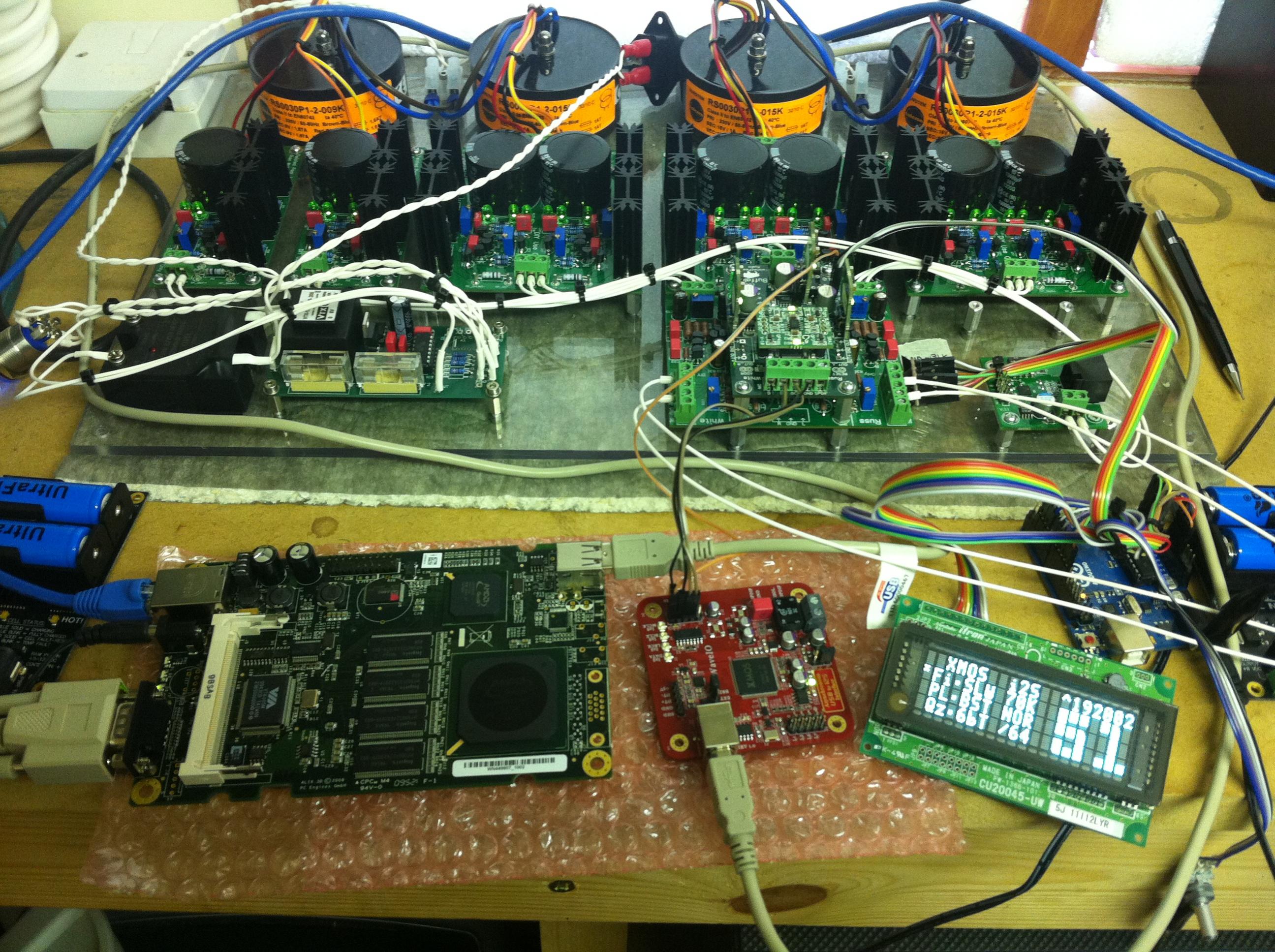

Wave IO with Ian's FIFO.
I have the Wave IO up and running with with Ian's FIFO and a Buffalo 2 DAC. There has defiantly been an increase in SQ when I installed the FIFO with the supplied "test" clock modules although I am waiting on a couple of Tent Labs clocks which I hope will bring out the FIFO's full potential.
Note, The Wave IO is no longer bus powered and has it's own 5V supply, This also brought a surprising improvement.
I have the Wave IO up and running with with Ian's FIFO and a Buffalo 2 DAC. There has defiantly been an increase in SQ when i installed the FIFO with the supplied "test" clock modules although I am waiting on a couple of Tent Labs clocks which I hope will bring out the FIFO's full potential.

Hi James,
Nice setup!
Just one little thing, and I'm sure it is because you're not 100% finished but your u.fl cables should be much shorter, especially the ones from the WaveIO to the FIFO.
Other than that, the most important thing is that you like the sound that it produce. I'm sure that will inspire many other builders.

Hi!
Thanks for the advice, I should have mentioned that this is my development "mule" setup. I have been working on the Buffalo 2 for a while experimenting with sources and configurations, including adding a "HiFiDuino" control/display, and running the Wave IO from an ALIX 3d2 board running Voyage MPD Linux.
In the final configuration the FIFO will be mounted directly next to the Buffalo with very short u.fl cables. The I2s feed to the FIFO will be via Twisted Pear "transporter"modules from a separate source selection/conversion enclosure, housing the Wave IO.
I havent decided on the exact final configuration yet but thats the general idea!
