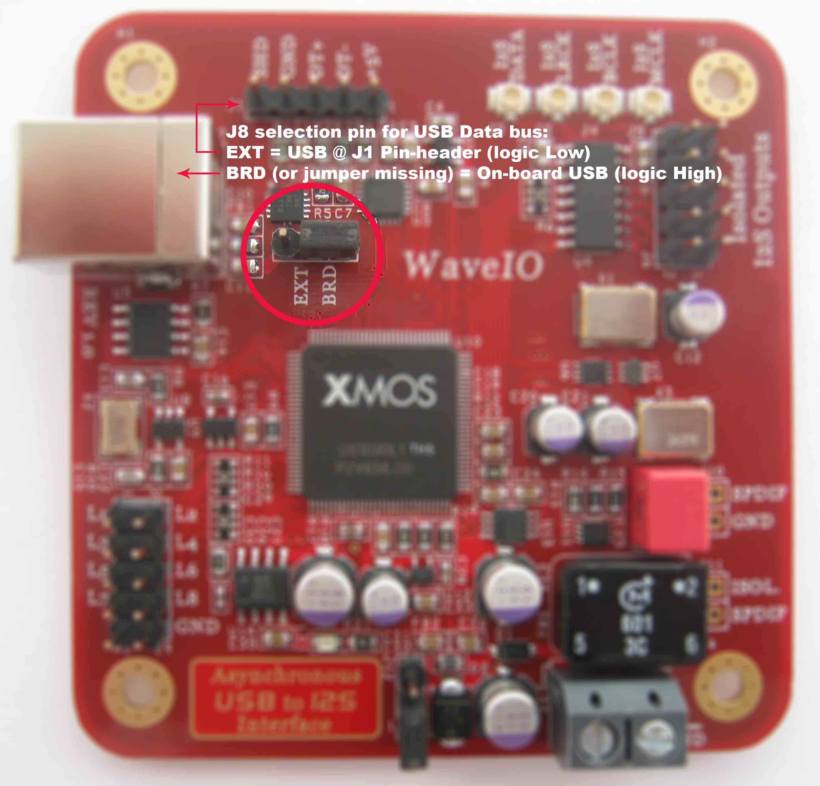

What happens when I feed the WaveIO with two usb sources at the same time? Does it automatically select one of the connected sources or would it not work?
Well, literally speaking WaveIO can't communicate with two hosts in the same time because firmware and hardware doesn't allow this! There's a chip on the board that allows you to switch between one of two available USB inputs: the on-board USB-B socket and a J1 pin-header wired to something like this. I say "you" because you're the one which will switch between the two USB buses: so there's a manual process involved there. So, you can connect two hosts on WaveIO but only one of them will be able to establish comms with this card.

Thanks for the reply!Well, literally speaking WaveIO can't communicate with two hosts in the same time because firmware and hardware doesn't allow this! There's a chip on the board that allows you to switch between one of two available USB inputs: the on-board USB-B socket and a J1 pin-header wired to something like this. I say "you" because you're the one which will switch between the two USB buses: so there's a manual process involved there. So, you can connect two hosts on WaveIO but only one of them will be able to establish comms with this card.

That is exactly the functionality that was hoping for. I want to build it into my PC and use a totally separate power supply (torroidal transformer + PSB) for it and use a LVDS transceiver to send the I2S over to my DAC. There is not enough room in my DAC to place it there 😡. There is however enough room for another LVDS transceiver 🙂 .
So I can switch between two sources using the onboard chip, but how is this achieved? Do I need to set a certain pin high or low?
Another question: Is there any difference in quality when it comes to connecting the sources? In other words: Is it better to connect a source to the USB-B socket or to the J1 pin-header?. I prefer to use the J1 pin-header because it will all be mounted inside my PC.
There's a jumper to select USB sources (please see the pictured attached)! Pin 2 (the middle one) of J8 is pulled high through a 10K resistor to 3.3V I/O of WaveIO. When low (EXT position) = USB connected to J1 pin-header will be selected and when high (BRD position or jumper missing), on-board USB socket will be used.
USB GND wires are connected together to the GND layer of WaveIO. The USB VBUS signals (+5V) however are OR-ed together by using two low drop-out diodes (~0.35V). If possible, I suggest to search for a way to power this card by using an external source rather than using local +5V USB bus.
