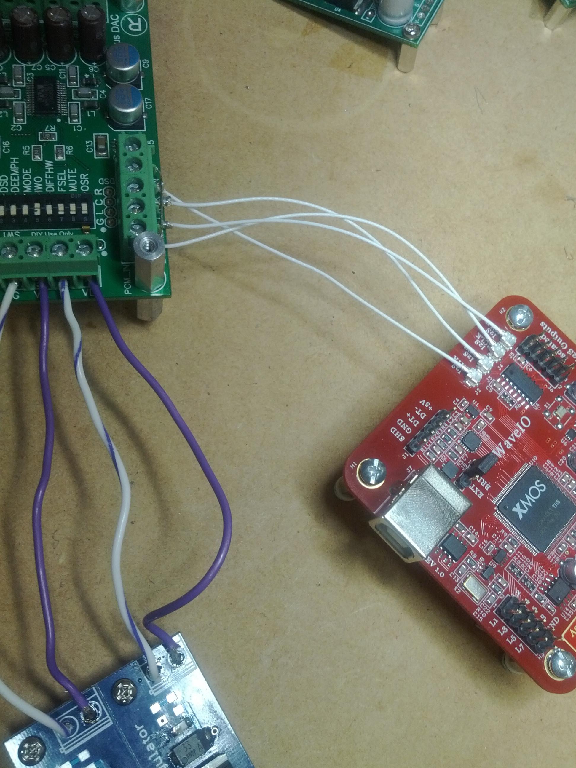

having some problems with waveio -> opus i2s.
I'm running out of ideas on where to look to get music flowing through my waveio and opus. Here is a list of scenarios I have tried so far trying to find the source of my problem(s). In each of the tests below I get squelch/hard electronic noise at the output (headphones at this stage, tried 2 different pair of cheap headphones).
I have 2 TPA Opus dacs here - I'll call them Opus A and Opus B. B is one that I have butchered removing the screw terminals (I purchased both second hand and previous owner mounted all of the screw terminals). A still has the screw terminals in place.
So far I have tried:
1. isolated i2s to Opus A to BAL-SE 'The Wire' - waveio powered by usb, isolator powered from sjostrom super reg.
2. non isolated i2s to Opus A with 10cm u.FL leads to BAL-SE 'The Wire' - waveio powered by usb from laptop (laptop running off battery)
3. non isolated i2s to Opus A with 10cm u.FL leads - waveio powered by sjostrom super reg.
4. non isolated i2s to Opus B with 10cm u.FL leads - waveio powered by usb from laptop (laptop running off battery)
5. non isolated i2s to Opus B with 10cm u.FL leads - waveio powered by sjostrom super reg.
6. non isolated i2s to Opus B with 5cm u.FL leads - waveio powered by usb from laptop (laptop running off battery)
7. non isolated i2s to Opus B with 5cm u.FL leads - waveio powered by sjostrom super reg.
In each of 2 - 7 I have tested for connectivity from signal the pad of the u.FL connector to the terminal at Opus and in some cases to via on the opus to ensure connectivity through the headers etc. These tests showed up 0.2 - 0.3ohm. I also checked that the bar tieing all the grounds together had connectivity to the ground at the case of the u.fl connector at the waveio end.
Since the result is the same whether signal passes through BAL-SE 'The Wire' headphone amp or if headphones connected straight to output of the Opus DAC I have decided that the problem is not the headphone amp.
Since the result is the same regardless of usb or external power or isolated i2s I have concluded that the most significant problem is not a ground loop (though at this stage I'm not sure if one exists or not in any of the scenarios listed).
Since the result is independent of which DAC board I connect I've decided the problem is not the DAC. I've tripple checked the jumper settings on the opus board.
With those two possibilities excluded I have decided that the problem is the i2s connection OR both the DACs I bought are duds since they're second hand and I have no other i2s source I have no way to verify that at this stage.
I've attached some photos from while I was using 10cm u.fl leads with Opus A, they aren't the best photos, will try to get a few more later.

Yep the LED turns on - photo was taken when everything was powered down.
BRD is correct. EXT uses the usb header rather than the USB socket mounted onboard.

I'm not an expert but from what I've read best practice is to keep the signal and return (gnd) path as close as possible. This is what would happen if it was properly terminated at the DAC end with a u.FL connector. Sending the gnd connection back to H4 probably increases chances of ground loops and noise being picked up by the cables.
I'm no expert either, but this is what Lorien wrote me in a question about setting up his board;:
1. it's preferable that all the Shields of coaxial cables you might use (I'm supposing they are U.FL compatible types) to be wired to GND at only one end (WaveIO's side) while the other one will be left floating.
2. Please a wire as thick as possible between the GROUND of WaveIO to the GND of your DAC's digital side (NOT analog!!!). WaveIO's mounting hole H4 is provided as a ground point which can be successfully used in your case.
Hope this can help,
grts,
Henri

Hi Hochopeper
I have my WAVEIO/Teleporters/Buffalo3 grounds connected pretty much as you describe above with no problems.
Just a wild stab
But I could be worth disconnecting your u fl cables and doing a continuity test to check for shorts.
Those skinny cables would just need a nick to short one which is easily done and hard to spot.
You’ve probably tried this already but just to be sure.

Thanks shoom, I wasn't very clear earlier, but I've fixed it! Was a setting on the computer that seemed to be causing the problem.
In other news I played with the midi settings in OSX - flicked it back to 44.1kHz rather than 192k and I get nothing but music out of the headphones. Now I need to re-connect the headphone amp and set myself up for dual mono. After far more hours spent looking at this stuff than I care to admit for it to be a software problem in the end is thoroughly frustrating but I'm sure that will all be forgotten soon enough!
On a side note its probably worth noting for other waveio users that you don't need to remove the u.fl cable from the receptacle to check for connectivity or shorts. The u.fl receptacle has a 3 pad pattern on the pcb. The single small pad at the front of the connector is the signal. The two longer pads on the sides are connected to ground on the waveio. Even when there is a cable connected you can get a multimeter at the signal pad without disconnecting the u.fl cable!
These micro coax cables have a limited number of connect/disconnect cycles that they last for, saving any unnecessary activity on these is worthwhile.
