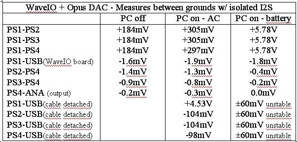

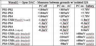

What do you measure for voltage between the "isolated" ground and DAC ground?
I made some measures (see attachment). Well, it's not very clear to me what's happening.
The power supply names are referred to scheme in post #759
Thank you.
