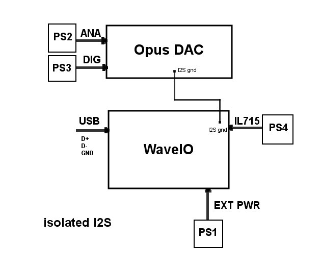

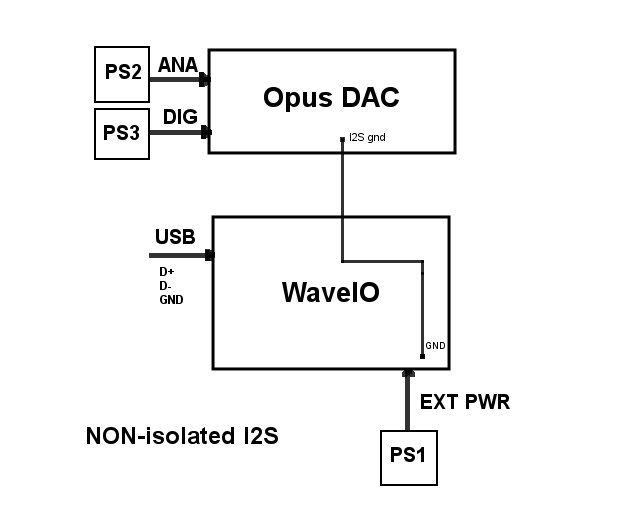

gnd loop problem
Maybe someone can give me a help with a ground loop problem I encountered with WaveIO isolated I2S.
I attached a couple of schemes to understand the situation better.
Power supply grounds are not normally shared at ps level.
With non-isolated I2S everything is fine, free of hum.
With isolated I2S I get a quite annoying at medium-high volume hum noise from both channels.
I get rid of hum if:
- detach usb cable
- detach notebook AC plug (power from battery)
- share PS1 gnd with each other PS ground
PS2, PS3 and PS4 grounds are tied at dac level, so if I share PS1 gnd (that should be shared with usb gnd) with other PS grounds I lose the gnd isolation between usb and I2S.
What do you think?
