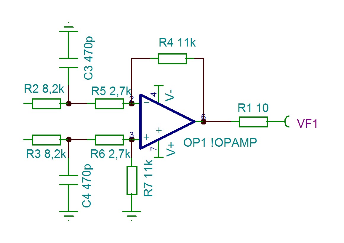

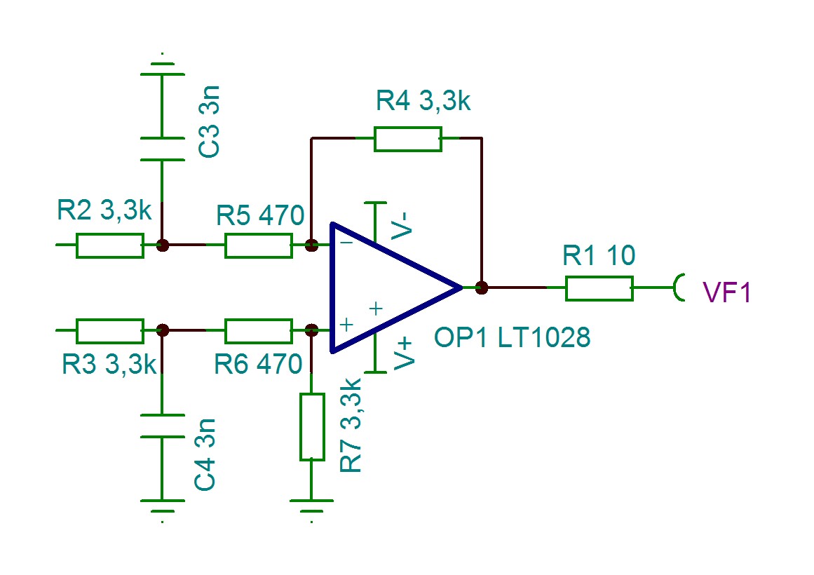

Here is some kind of solution for opamp output.. it is easy to solder on the existing board..
There will certainly play far better than the output as it is now..
This design allows you to really hear the difference between opamps, my recommendation is definitely LT1363 ..
