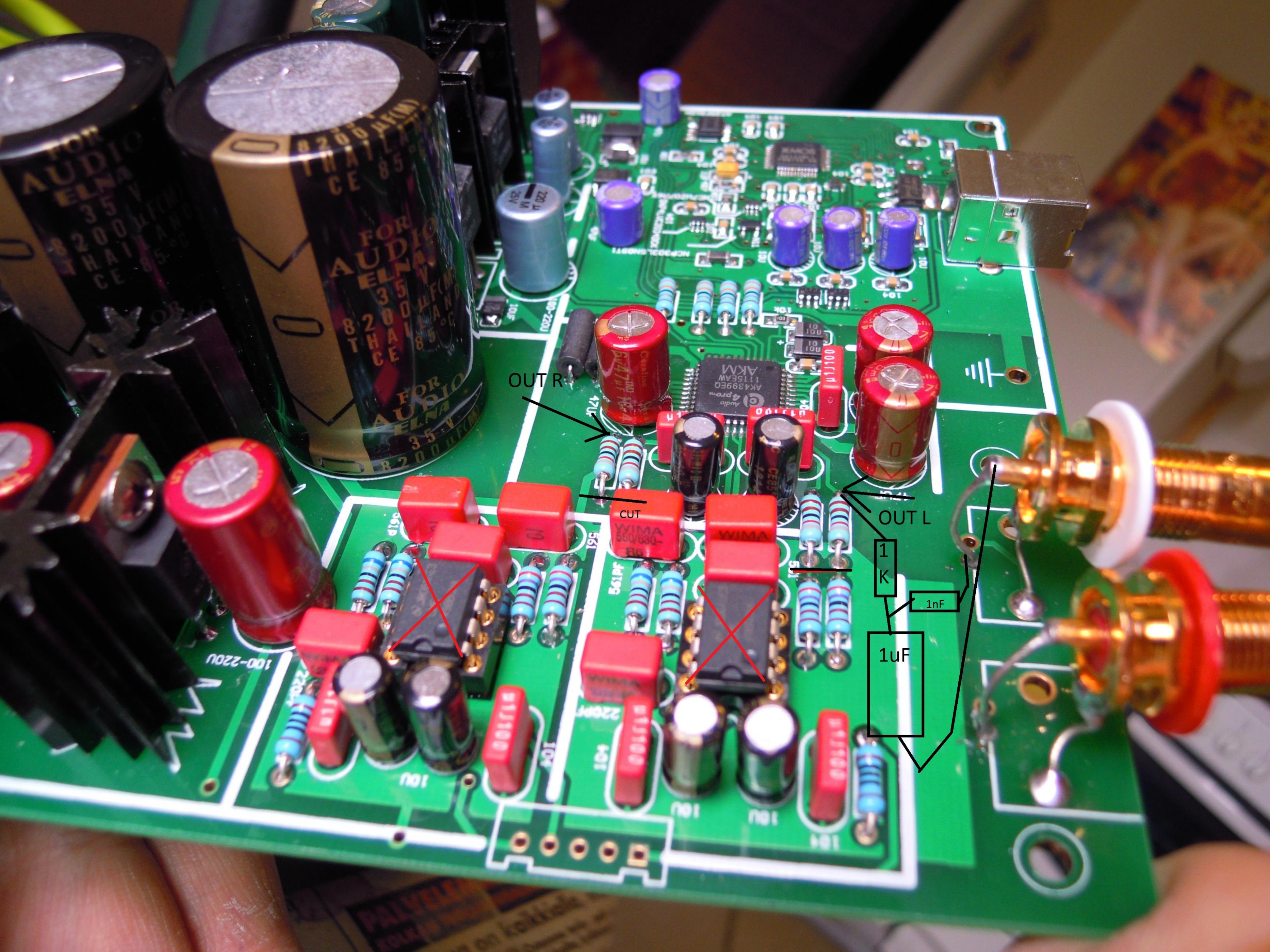

If you made buffer you'll need a power supply of analogue section ..
If you want to try a direct output from AK just remove opamps, 8k2 replace with 1k, 560p with 1n, out of there take the signal from PCB over 2u coupling capacitor..
It will be more than enough to push the preamp impedance of 100k.. you can put buffer later on that line..
You think 1uF would be sufficent with input impedance of 1M? I remembered wrong, it wasn't 100K.
I have only 1uF home at the moment. I'm gonna test this mod tomorrow i think. Sorry for the wait... 😉
1u will be more than enough
Ok thank you.
Can i ask; what is the 1nF and 1k for? I've read in another threads that people just used a cap on the output, nothing else. Some guy said said sound got "choked" with 1k res in signalpath.
Ok, I've tried this and yes it sounds better. Little like changing a "low quality" cap to a real boutiqe cap ala RIKE or Audyn True copper.
Smoother and overall everything is better. I like it but gain is lower. What was 8 o'clock before is about 9-9.30 now.
Now i suddenly have a huge "bump-bump" (pretty loud, mostly in bass) when i switch song.. what is that?

Explain exactly what you did ..
So, in positive output you need to connect in series 1k, then 1n go to the ground, coupling capacitor in the input of preamp ..
The negative output of AK4399 should not be used ..
Yes both opamps removed. I cut traces after 8.2k (+ and -) total 4pcs and then soldered 1k before the 8.2k to outside my case ( no space inside for caps) the 1n is grounded to same ground as rca-
2x15v is connected but since opamps are not there no power is needed right? I mean power is cut off..
The other 2x 2x9v is there. One for clock and other for ak4399 chip.
Is it needed to have a leakresistor on output like 100k-1M like in my preamp?
Yes ok will try that. I've been listening alot today n except the "bumps" there is only positive things to say. Micro, macrodynamic is fantastic. Bass is scary. Very good punch and depth n drive.
There's a certain ease and flow that's quite nice. Soundstage is wider, deeper and higher.
First i thought sound became darker but it was mostly because some digital hardness dissapeard in mid/tw range.
