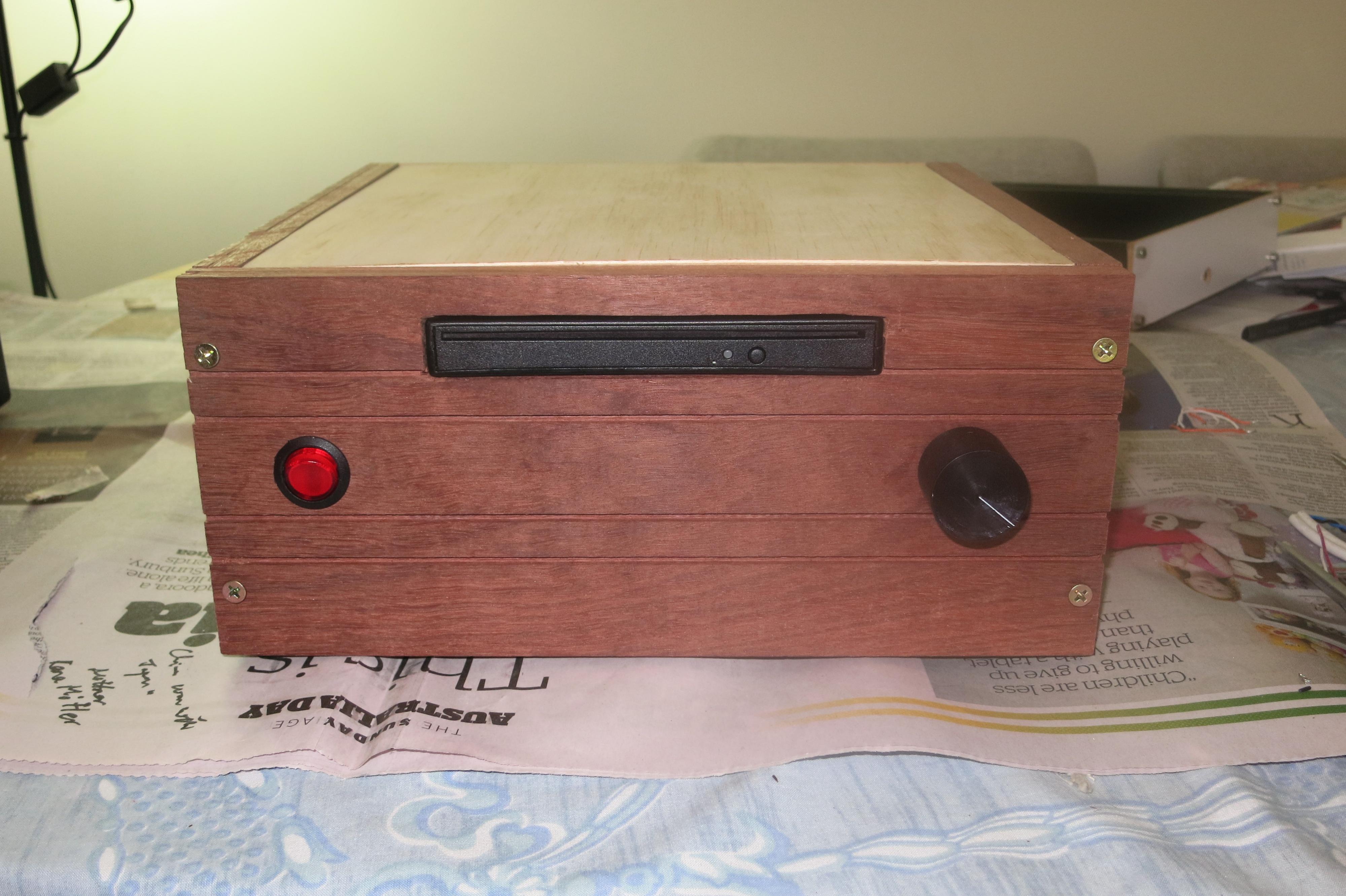

Unit arrived
My Unit just arrived today, after 1 month in the post that's too long.
I will put this unit in a case together with the following:
1. Transformers
2. DVDRom, slot-in version
3. Tube Buffer with Volume control
input:2* USB
output: L & R RCA to power amp.
I have most parts and it will take about a couple of weeks including testing. Will report back plus few images. Stay tuned.

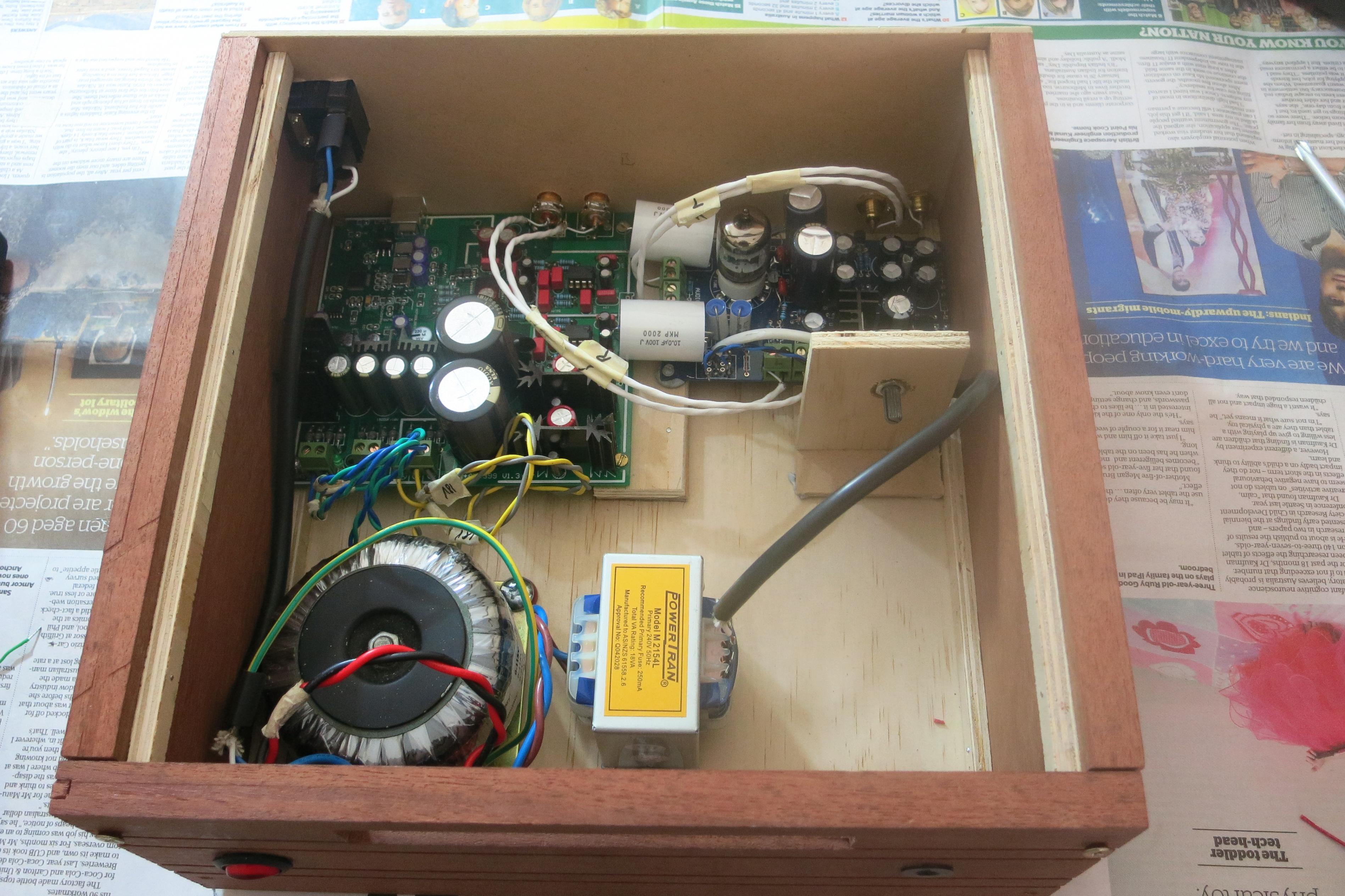

Follow-up DIY DAC and Preamp with CDrom
Find attached are images of my implementation of the DAC AK4399 and Xmos in one board.
Note the following from 1st image:
1. top left, is the DAC
2. top right, tube buffer based on cathode follower with current source powered from 12VAC
3. bot. left, transformer for DAC
4. bot. right, transformer for Tube buffer and CDrom.
Total cost about US$200-$220, not including casing woodwork and labor. A worthwhile project.
This unit works with my front end(laptop) via USB and will also drive my power amp.
Initial assessment the sound seems promising fairly similar to the my AK4396 and Xmos(from DIYHK) combo from another project. BTW the DIYHK's Xmos driver cannot be used in Weiliang Xmos.
