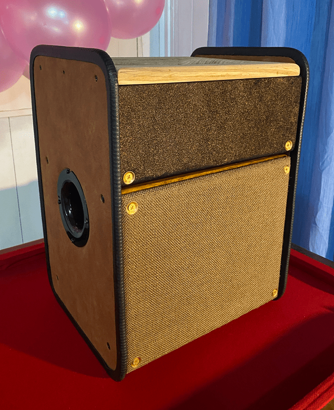

The "fancy dress" on the z623 looks nice!The plan is to now let them loose with the pro Roland gear and set up synth pickup for the acoustic instruments so they can do their school music material as EDM. The school dual 15 two-way Yamaha active 4some has no low bass for this. Hoping that the 4 sets of ZR12.4Ds going 112dB each over the basslines and synth kicks will do better than the single z623 gaming sub that we add to that mix. The z623 with its 105dB at 50Hz as linked in another thread manages to sing over the band instruments, and you can feel it modulating the pressure in the hall. The teacher asked for a dark tone on this one from the electric bass. I wrapped a z623 up inside dress panels and some fabric. It has been loud enough to be heard over other instruments and sometimes even over the school PA. See the attached .mp4 in the zip and the pics of one of the ugly Logitech z623 wearing some fancy dress panels.

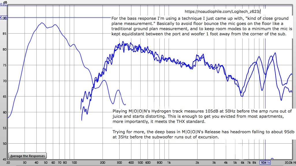

The "Striving for Success" mp4 low end peaks around 80Hz, about -50dB at 40Hz.
Nothing low there.
Assuming the mic was capturing the low end, most of what you were able to feel from the bass was not very low frequency.
The z623 with its 105dB at 50Hz was an indoor measurement from a random source (noaudiophile.com) at an unknown distance from the driver, it crapped out at ~95dB at 35Hz:
Based on that, you would not hear or feel much from the z623 compared to the dual 15" two-way Yamahas unless they were hardly on.

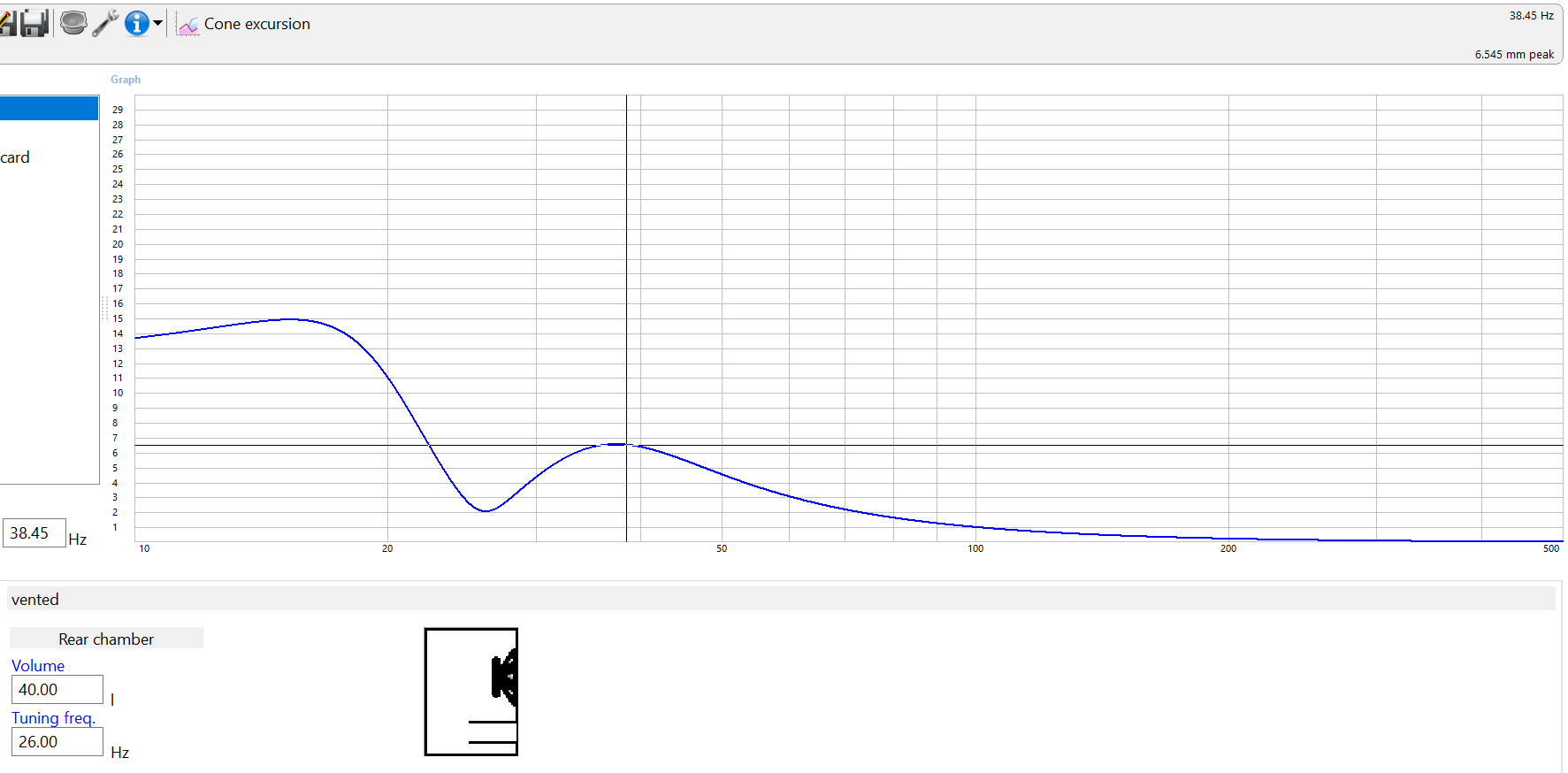

Ah, sory. Its BR system tuned to 26Hz for equal camel backs on the impedance and Xmax is shown in the pic with each of Eric's 600w@4R modules on each coilStill didn't didn't mention anything about the cabinet design (BR or sealed?) or excursion of the ZR12.4D...
What do you figure the ZR12.4D Xmax might be?
Below the 26Hz Fb, the port's output goes out of phase with the driver, hence the 24dB per octave drop in output.
Excursion much below Fb is just wasting power.
A HP filter should be applied below Fb to limit excursion to around the same below as above.
6.5mm excursion at 38.5Hz should do ~ 102dB with ~100 watts, should be nearing ~13mm (around 108dB) at 400 watts.
Should be around 120dB with four cabinets ~ 38.5Hz, 116@30 Hz.
You could get a lot more "bang for the buck" moving the Fb up to 32Hz or so.

Sims at 33Hz port show a hump over 50Hz. But yes about a 109dB flatish with 100dB at 20Hz with current tune and power. I just don’t know if this can be considered loud or excessive?
Filters are there in the sim for a cut at 20Hz and 3dB boost at 90Hz but not active in the Xmax graph as I wanted to show raw driver Xmax at full peak rating
