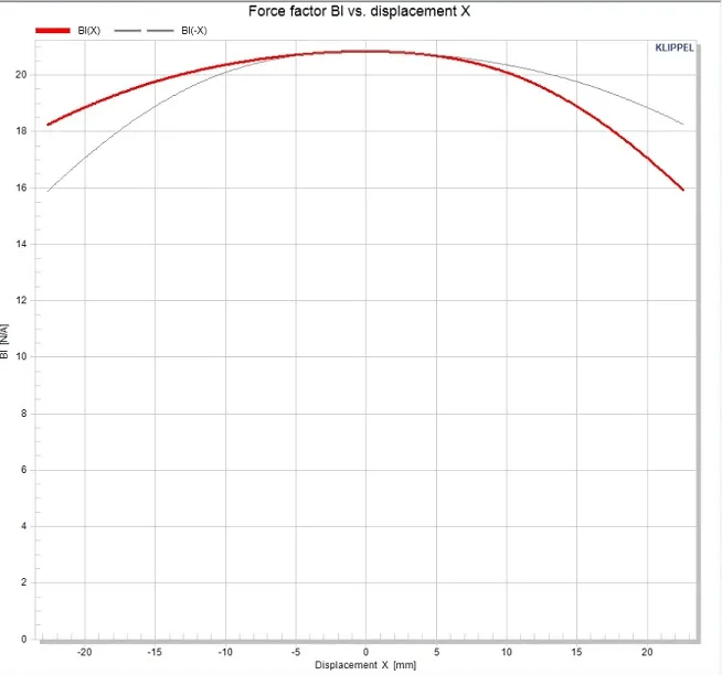

I would like to see a BL(x) curve of these things.
As well as all the other things.
There is a Stereo Integrity 18-inch HT-18 v3 woofer that has an Xmax of "25 mm one-way 70% BL". And the published BL(x) curve is as follows:

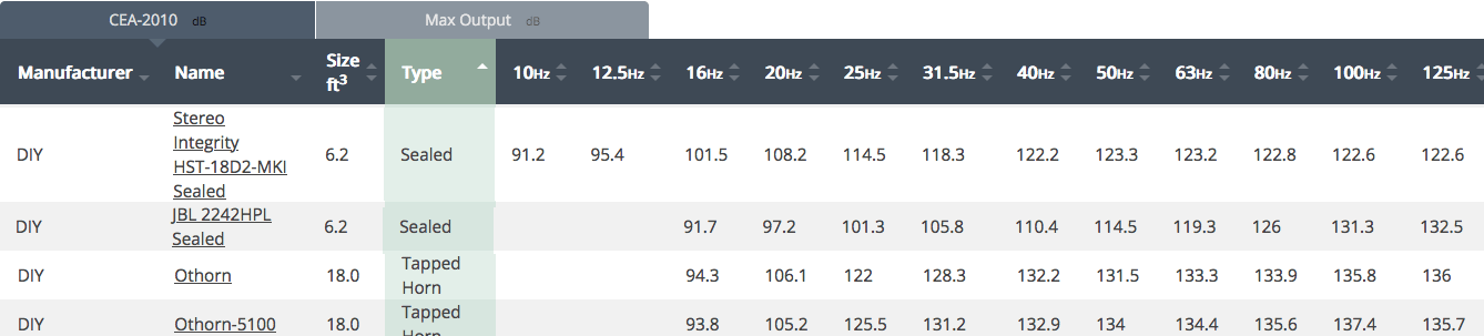

Certainly the driver's weight could be reduced using Neodymium, but the 35mm Xmax Stereo Integrity 18" is no joke, it comes in about +12dB SPL (+6dB for each doubling of excursion) over the 9mm Xmax JBL 2242HPL in the low frequency range below 50Hz, in line with it's rated Xmax.
These are 2meter outdoor tests:
https://data-bass.com/#/systems?_k=vhj336
Josh Ricci's data-bass comparisons don't joke around, he's wrecked plenty of drivers finding their limits ;)
Art

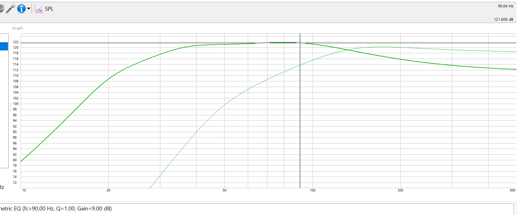

The current sims are showing a peak 109dB over 40Hz and 96dB at 20Hz in a single microwave sized cab with plans for 3 more. One per channel in a four channel surround for HT and back to back bidirectional for away PA use and built as 4x 3-way cab or 4x satellites and 4x subs in yet another project attempt thread. With the assumption that the tops can be run with tubes at home use and volume can be turned to to acceptable levels depending on the time of the day

So please tell me, do I turn it back down to dual PR based 6.5" again or turn up to the dual 12" + coax inna microwave with a 122db flat plot iteration that I have been siming over the past two hours

If I peruse the 31Hz and 40Hz columns in the Max Ouput tab, I can see most drivers outputting between approx 94dB and 122dB with some exceptions going higher. Can I take this a sort of industry baseline for powerful single driver subs?
94dB to 122dB is almost two orders of magnitude, like comparing a car that gets 2 kilometers per liter to one than gets 200 kilometers per liter.
There is no "industry baseline" for "powerful single driver subs".
Those levels are measured at 2 meters outdoors. Peruse the cabinet volumes and designs.
