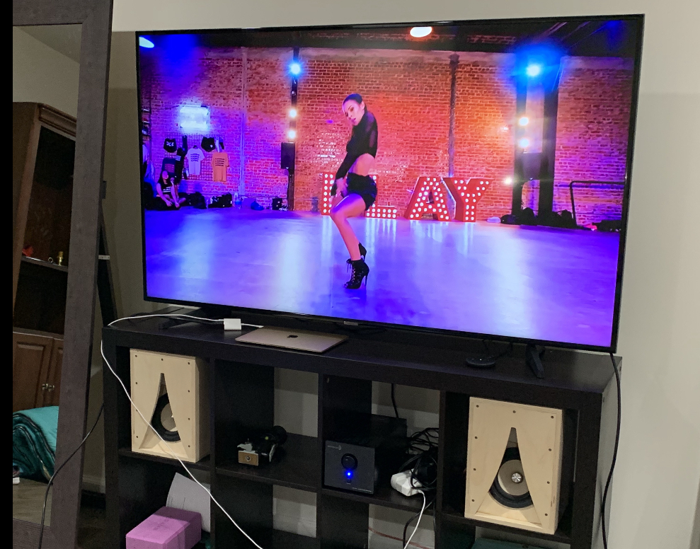

I started to look at that driver but its specs don't make sense. Are there independent measurements of its parameters ?
Hello Freddi,
Yes, those T/S parameters on their website are not accurate. Below is what I was told are the measured parameters for this driver.
Sensitivity - 93dB, Re - 6.7 ohms, Fs - 84 Hz, Qts - 1.32, Qes - 1.7, Qms - 5.92, Le - 0.126mH, MMs - 6.58, Vas - 0.633ft3 (18 litres).
Please let me know if you think this would work in xKi. It would work in Karlsonator but the box is too big for the room. This seems more compact and hence I am looking at it. I know it is slightly bigger than W5-2143 but I think it will start with that.
Balaji
Hi Balaji
Qts is pretty high - I think it would work better sealed so without a rear chamber vent. (you could try it both ways)
You could add some rear chamber stuffing and perhaps an "aperiodic" type vent and tune it by "ear".
I can't do a precise sim of this type - just ballpark as bandpass.
Lets hope XRK971 sees this and comments.
Hi Balaji
Thanks, I am unable to see the picture but based on xrk's comments, I will give it a pass. Thanks for your inputs, please see if you post that picture again.
What Freddi did looks great. I wouldn’t normally bother with anything with Qts>0.45 for XKi. It would be too big.
Thanks xrk for your inputs.
Balaji

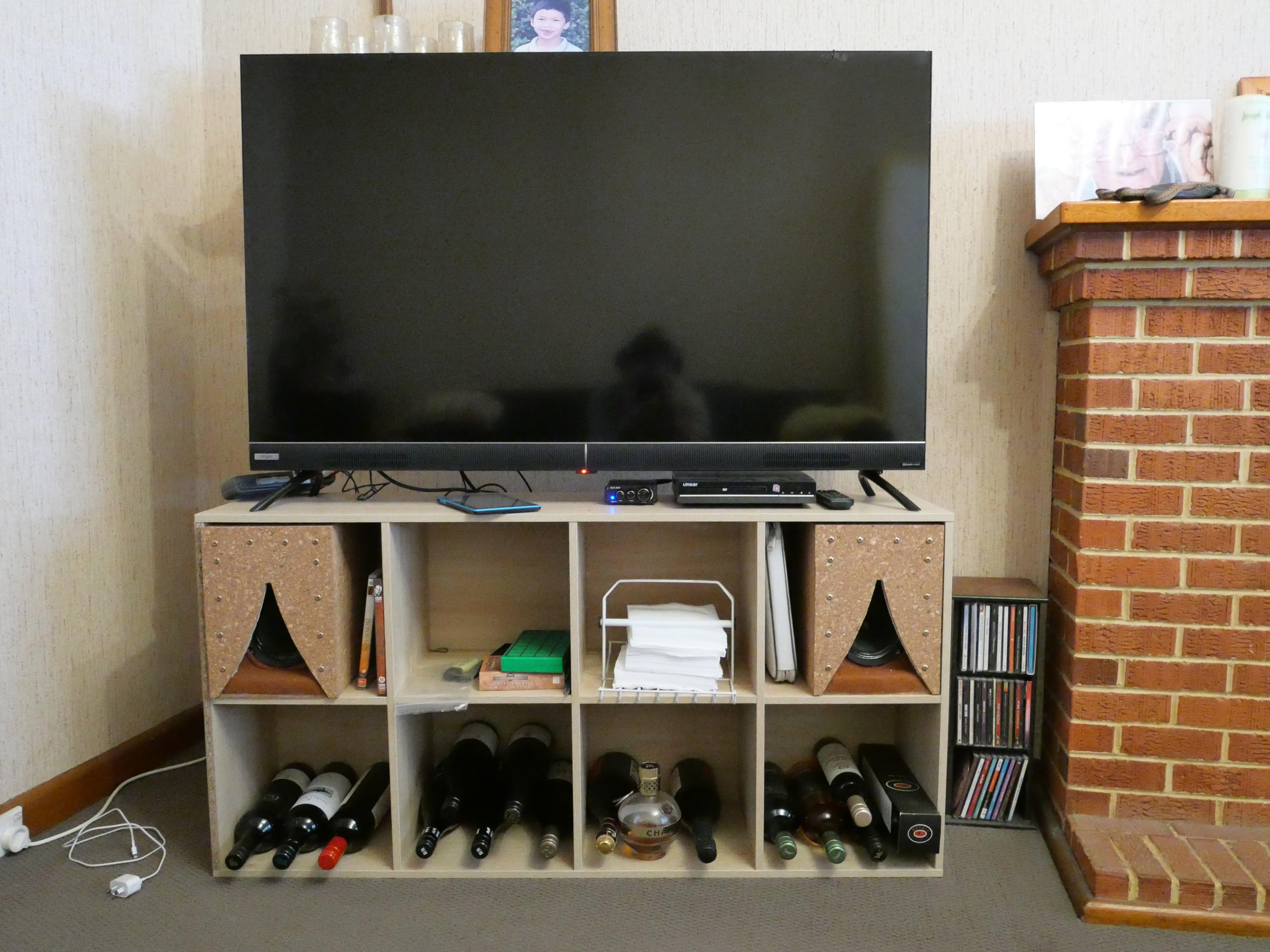

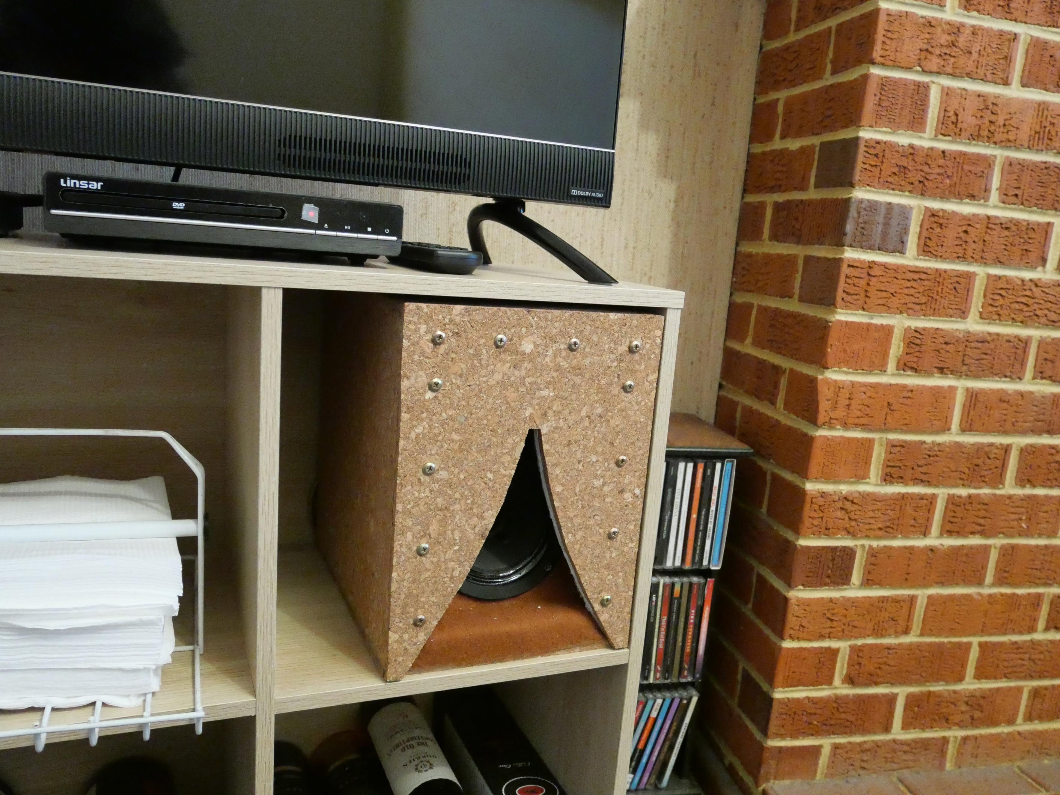

I did finally build my squashed XKi enclosures with PA130-8 drivers. They are foamcore covered with 6mm cork floor tiles. I changed my mind about where to place the screws for the front aperture, so try to ignore the inconsistent spacing. It bugs me but I have been told by my wife that I do not need to fix it ...
Very happy with the sound. They get the most use as TV speakers and they do a very good job.

Thanks xrk971 and Freddi for the feedback, much appreciated. X, the similarity in our setups is uncanny.
I had to fit the speakers in the 11" cubed space in the shelving under the TV, hence the need to have a squat version. The external dimensions of the enclosure are 10.8" H x 7.8" W x 10.75" D, so they are getting close to being "generally cubical".
I will take my hand drawn plans to work, scan them and then do a little write up of the build when I get some time.

Here are my plans for the squat XKi. I had to zip the pdf file to get it below the forum attachment size limit.
I have also included a drawing showing some of the detail of how the foamcore portion of the front aperture fits inside the side walls and the cork section goes on the outside, forming a good seal.
There is another drawing showing where the melamine pads went in the front chamber and how the felt sheet was used to cover the lower melamine pad and generally hide the white foamcore.
Looking at the plans again again I think I added an extra 5mm to the depth of the front chamber my mistake. I can't say what effect this has had on the sound, I have no way to compare now,
Finally, the aperture vent starts about 50mm below the top of the enclosure and is 10mm wide at the top. I traced the curves from one of the Karlsonator plans.
This will give you a general idea. Bracing and so on is based on xrk971's many examples on these forums.
Happy to answer any questions you may have.
