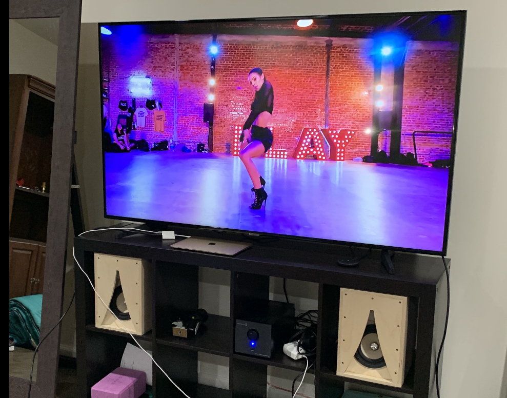

My W5-2143 XKi’s have been in use as HT bookshelf speakers for past couple of months. They literally are stuck inside the cubby hole made by a shelf. The family has been using them daily and powered by Dayton APA150 FRD from TV’s Toslink to an optical to RCA converter. They play quite loud with good bass extension. My wife likes them.

We use the XKi W5-2143 everyday as our main speakers for the flat screen TV used for the basement dance studio. They fit right inside the TV shelf and sound great. Very nice bass and great wide sweet spot.
XKi - X's ab initio Karlson 6th Order Bandpass

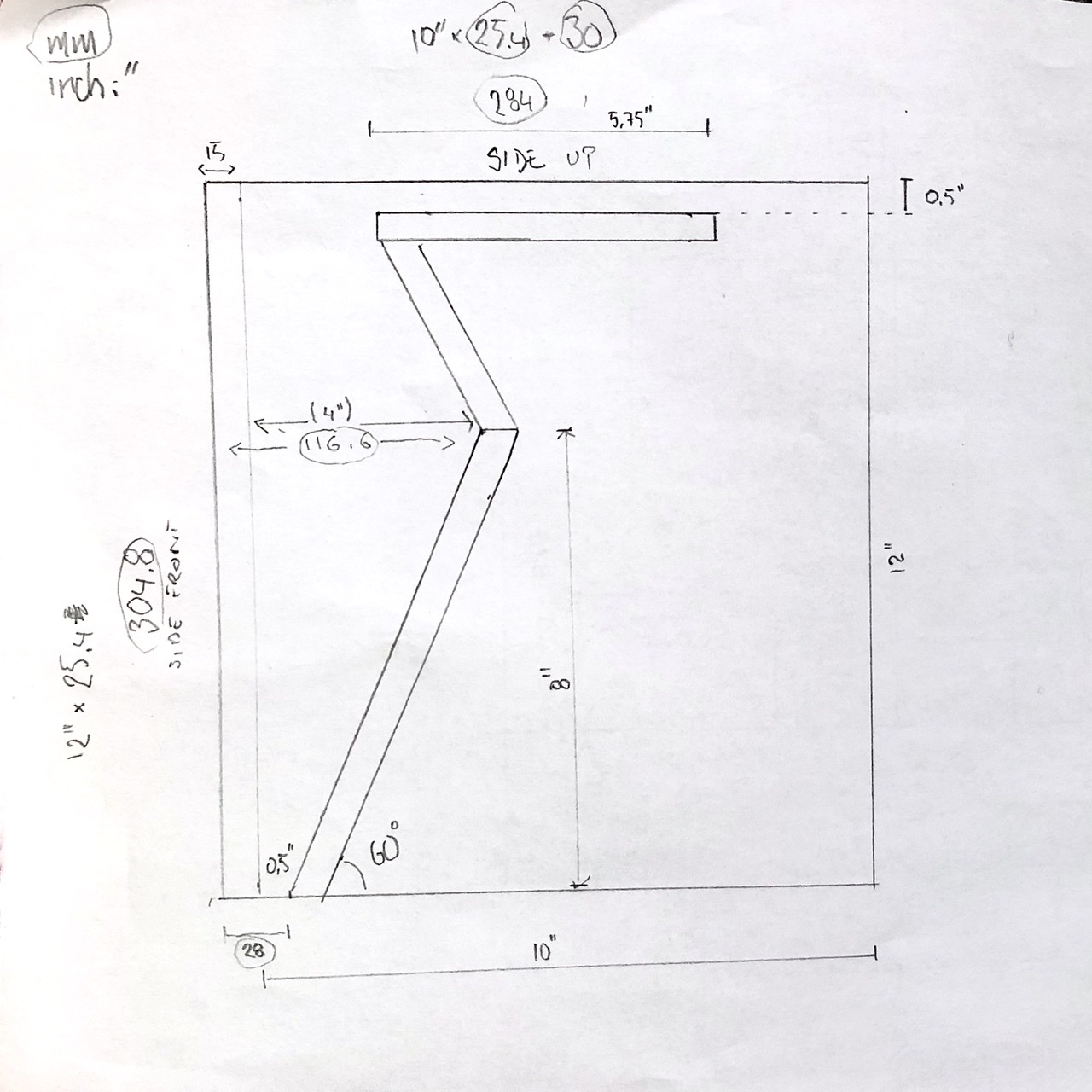

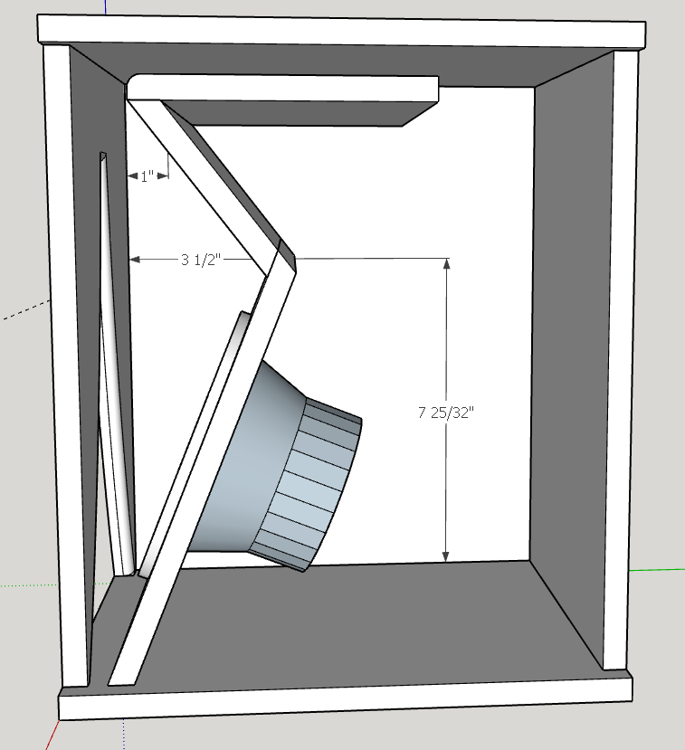

Do You have a drawing? It's a bit different from your post #723. I have the W5-2143's and eager to get started.I’ll let you do the math. Just make sure the volume is the same, 1/3rd of the volume is front chamber and 2/3rds the back. Make the vent cross sectional area the same and the vent length the same. Then, the driver needs to fit.
For the W5-2143 XKi, make the box 10in deep x 8in wide x 12in tall (all inside dims) with a 8in wide x 0.5in gap vent that is 5.75in long. The front driver mount panel setback is 4in deep to provide a 20% front chamber volume and 80% rear chamber volume. Make the wings following usual K style with the edges of K-aperture curves just touching the driver surround when viewed from the front. Line all surfaces adjacent to back of driver with felt, as well as front chamber sides and back side of K aperture to reduce first reflections.
Oh sorry - it was 20% for front chamber. The description you posted is correct.

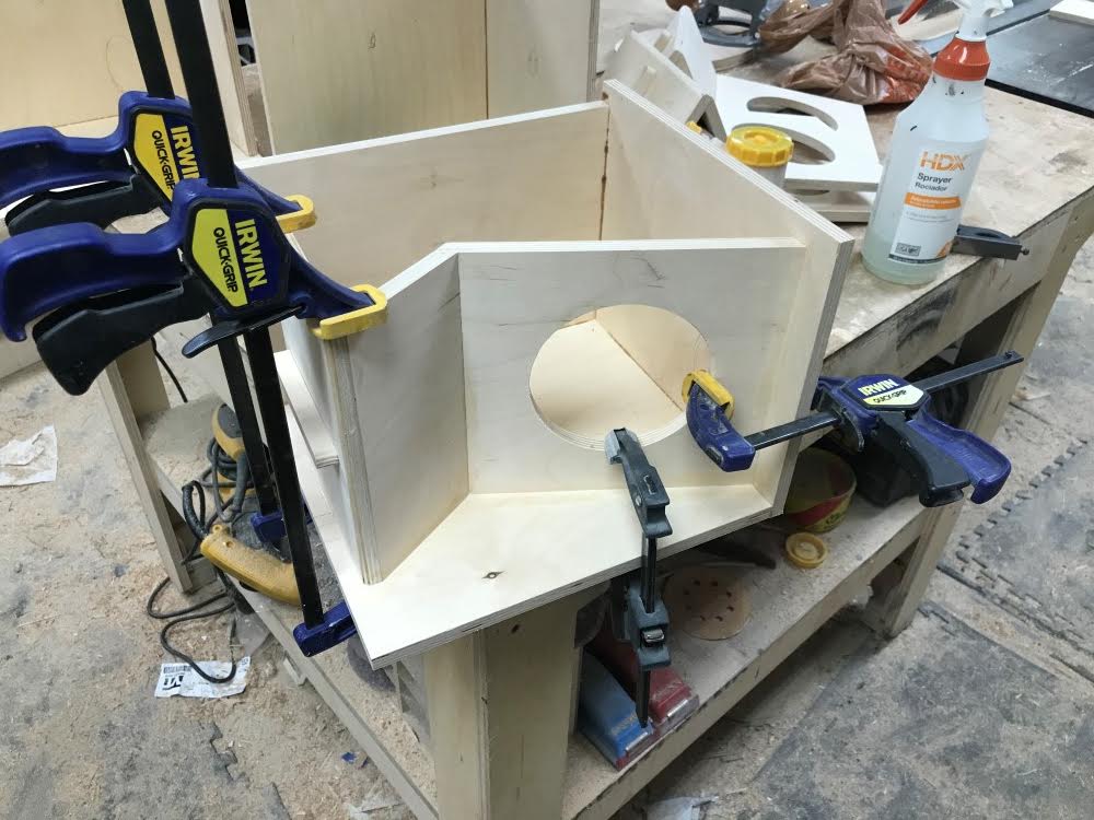

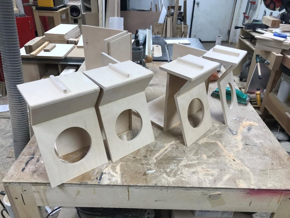

Here is drawing and build photos.
