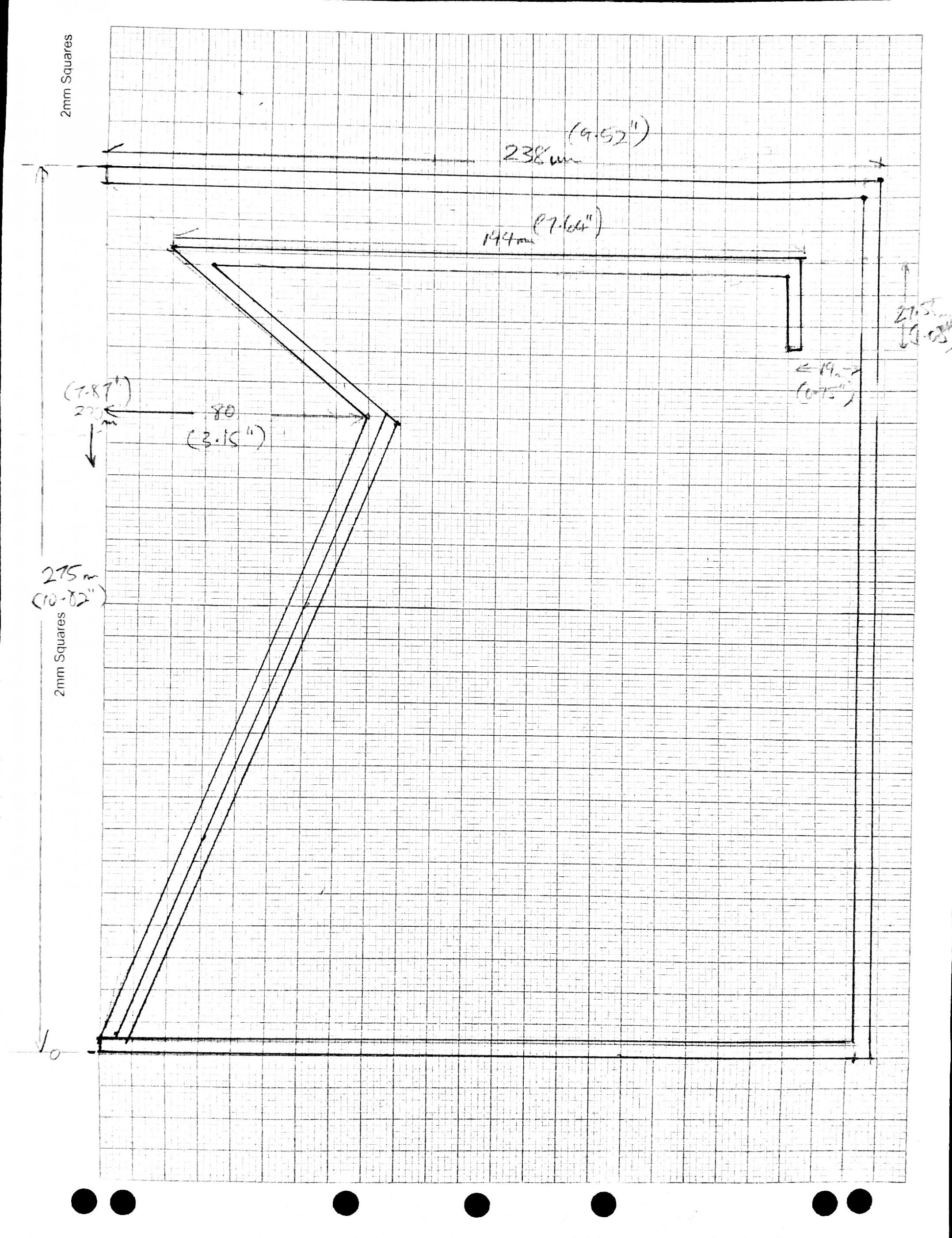

I am planning to build an xki for a PA130-8 from 5mm foamcore. I need to reduce the height so it will fit in the allocated space. I worked with the plan credited to Thermcul on page 1 of this thread and reduced the internal height to 265mm (10.4",) increased the depth, kept the port dimensions the same and played with the baffle to maintain the front and back volumes. I have attached a plan.
My questions are:
1. What is the internal width of this enclosure? I cannot see that it has been specified anywhere.
2. What would be the best shape for the front aperture? i.e. how far down should the opening start, what width at the top and what radius?
3. Are there any obvious problems with my adaptation of the design?
I could go with the little RS100P-4 version of the xki if there are too many problems with shortening the PA130-8 version, but the PA130-8 would be my preference. They are also $28 cheaper for a pair than the RS100P-4 in Australia.

Thank very much. Not sure why I didn't see it. I will double check my plan against yours.
In your plan, the top of the K aperture is in line with the bottom of the vent. Should I use that as a starting point and fudge it from there?
Was it worthwhile adding the floor underlayment to your wings on your PA130 build? I don't want to muck around with plywood, but should I make the wings from a double layer of foamcore or just stick to a single layer?
The aperture size has a big effect on the voicing - bigger aperture will give more mids and highs. I picked the start of the aperture below the vent and about 3in from top. Make the wings out of double thickness foamcore.

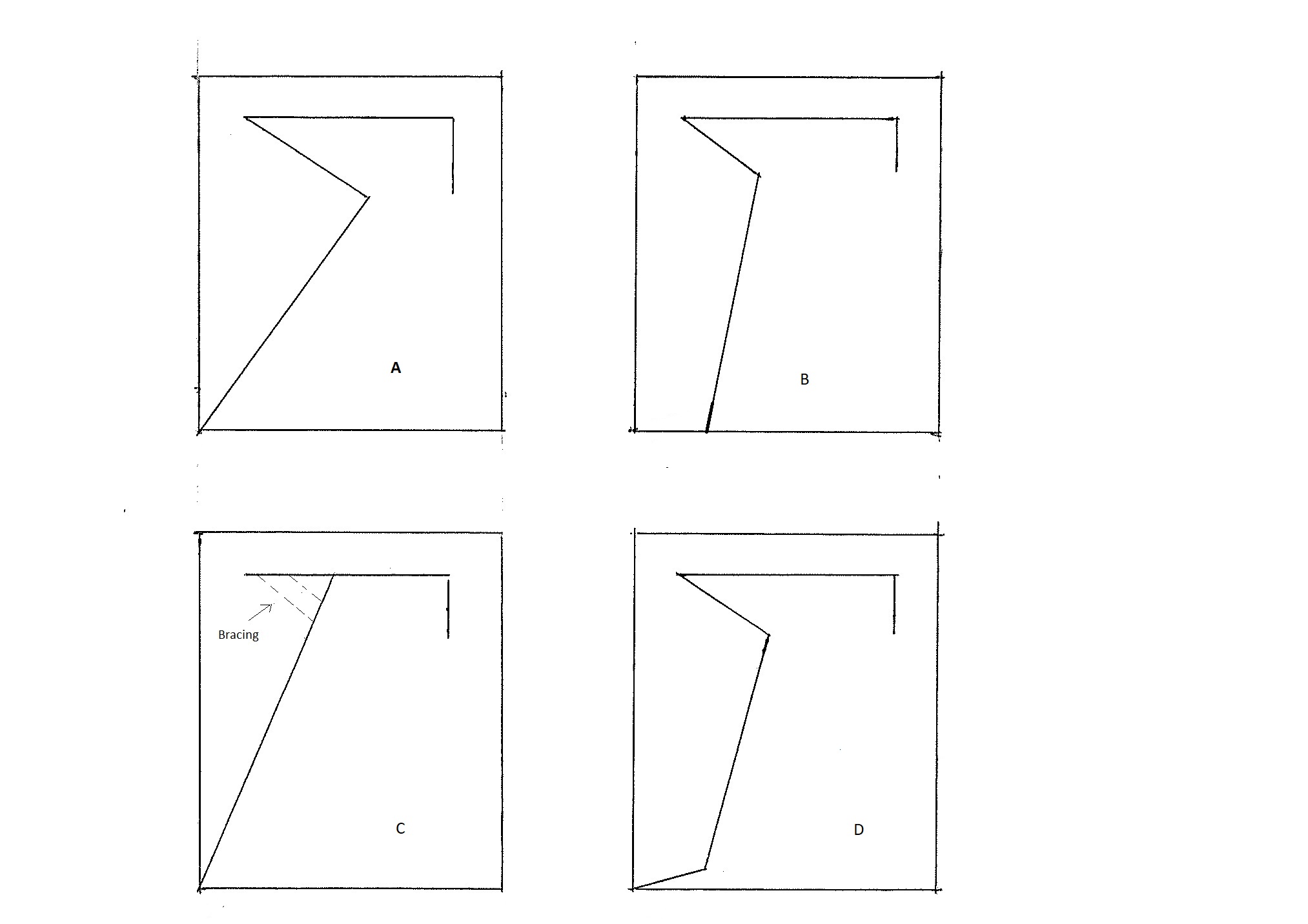

I am refining my plans for my shortened PA130-8 Xki. The internal height will be about 10", so 2" shorter than the original plan. The width will remain at 7" and the depth increased to keep the volumes the same. I have four ideas in the attached jpg.
Option A is the normal design but with the baffle laid over at a greater angle to create the additional space required in the front chamber. The other options are attempts to keep the angle of the driver more or less consistent with the original design.
My questions are:
1. How far can the baffle be angled back before the driver is pointing too high? Does it matter much behind a K-aperture?
2. Does the baffle need to intersect the bottom corner as it does in A and C? In other words, is the triangular shape of the front chamber critical to how it works with the K-aperture?
I have the PA130-8's now. D-Day will be on the last weekend of the month, when my wife is away with her girlfriends, so still plenty of time to make changes.
Jim

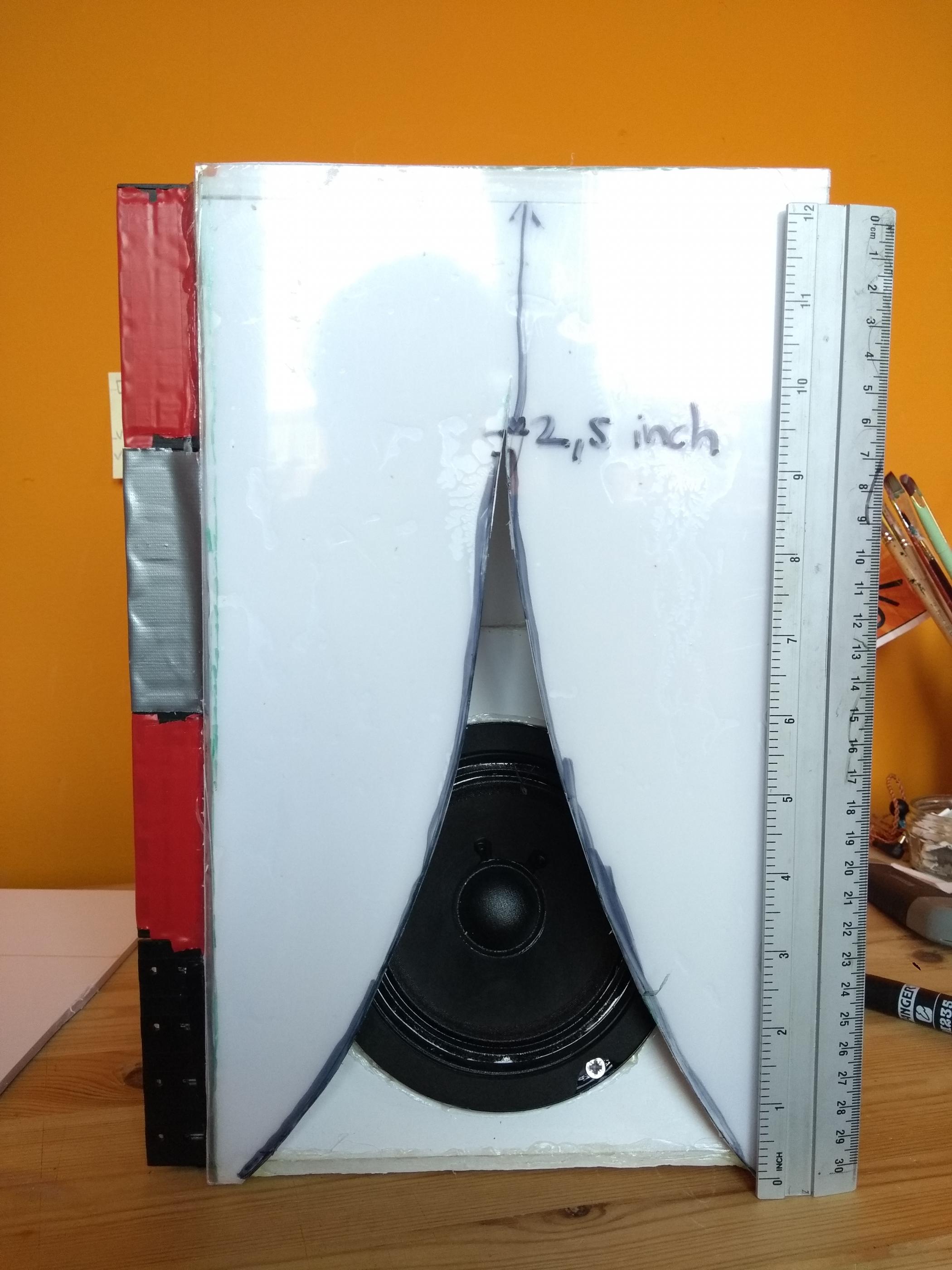

Hello everyone
I build a XKI with PA130-8 (see pictures) and I was wondering if the aperture is about the right size. I kind of copied it from the other picture attached.
The K aperture opening starts below the top vent and about 2,5 inch from the top, as per instructions from the forum. However, for the width and curve of the wings, is there some guideline to follow?
The wings are not 'just' touching the driver surround but are covering a bigger part of the woofer it seems. Should I widen the wings more?
Also maybe contributing factors (i dont know of they are)
- I think maybe the sound has a 'cupped hands' quality to it.
- I have not yet made the front with a double foamboard layer.
What do you think?
Thanks in advance,
Sam
