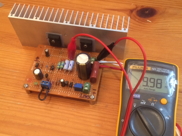

At 96dB for 2.83v might make this the perfect speaker for the Pass ACA amp. I have built one channel so far and love its bass capability. They run hot! My first class A amp and it is only 5w but feels almost like a space heater. It's neat to make it yourself and get good sound from so few parts.
So I had to try out the ACA with my XKi fitted with a modified PA130-8 (a coax) called the Daytonator.
They are a great match up - sounds wonderful. Nice deep rich bass and excellent mids and highs.
