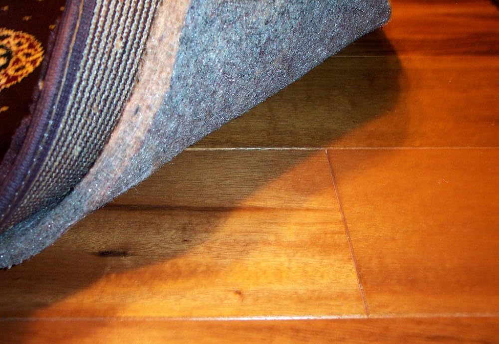

drewan, this company has next day delivery on wool underlay for a reasonable price - I got 2 m2 for 8.99 including delivery. I used 42oz, which is about 11mm thick. I think it is mainly wool with some cotton mixed in.
Wool Felt Carpet Underlay - Multi Rich 42oz
That's a good price on felt. Here on USA Amazon free shipping we can get 3.72 sq meters (5ft x 8ft) for $34. All wool though and about 12mm thick. Looks nice, I may have to try this stuff.
http://www.amazon.com/MULTIPLE-Authentic-Industries-Specifiers-rectangle/dp/B005Q83DZ0/
![71iqspcrHtL._SX1000_.jpg](https://ecx.images-amazon.com/images/I/71iqspcrHtL._SX1000_.jpg)
I've had mainly good experiences with whizzer cones including 12LTA in K12 and Karlsonator 12, SP15 and 15A in K15, BG20 in K12 - with FE206EN in the old Karlsonette as one of my favorites - more load is good too so the original width will work - wonder if it would accommodate SN10C's specs? - how about TF1020 or Delta10A? - am hoping it can take another 10 or two besides Beta10cx (?)
I haven't seen any jute felt in the UK. I guess jute has similar properties to wool with a flatter absorption curve than small diameter fibres such as glass fibre. You can get 100% Cumbrian sheeps wool underlay but it is difficult to buy in quantities less than a roll and is expensive. One of the speaker component webshops I found has it in smaller quantities.
