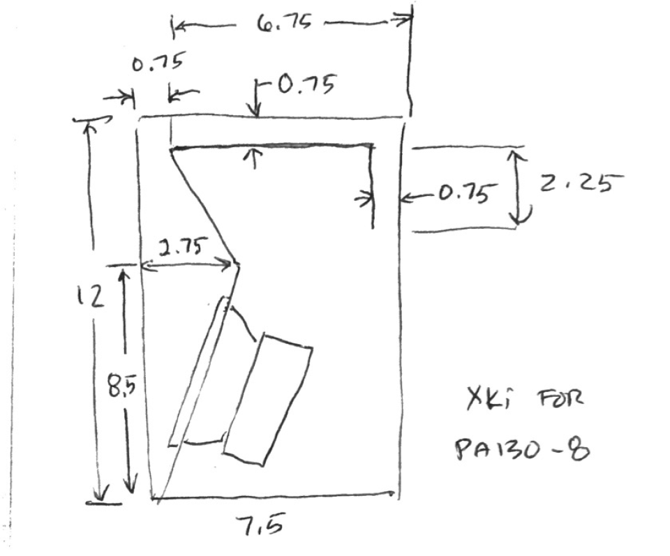

hi X - I've used Dayton's PA130 in a "K5" size so know it would be pretty lively in your XKi alignment - here's your note from earlier in a mini Karlsonator thread along with a poorly drawn/mislabeled sketch below - how far forwards would you cant the upper board for best results and proper volume?
description of size plus your XKi simulation which looked very good

Hi Freddi,
I hope you build it, but here is a sketch of the XKi for the PA130-8 for you. Internal width is 7in. Note that the 8.5 in high dimension of where the break angle is adjustable to suit the angle of the driver that you like and to allow for more or less magnet clearance in the back. Moving it up or down actually doesn't change the volume ratios as it is a triangle so volume is based on depth or 2.75in dimension.

thanks X - I appreciate your time and work - for clarification, the 2.75" dimension is from the panel break to the back side of the wings (?) do you think 9mm Baltic birch would be sufficient ? would hot glue hold BB?

Yes, backside of wings. All dimensions are internal. 9mm BB should be fine and you can get away with not accounting for its effect on the volume given that there is the vent wall and front divider wall. With 3/16in thick foam core, I routinely did not account for it in volume calcs. I don't know if hot melt will hold plywood well. You can certainly use it to tack together in spot glueing and add a bead of Titebond for main joint strength. I have done this and it works well.

Sure you can try to put the vent at the break point, but just like I said to Tb46, having the vent at the top allows the K aperture to be utilized to gradually expand to provide an impedance match and make the response smoother.
